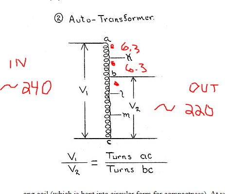

Good question 🙂
What will happen with a valve amp is that filaments get over run. If you have a 220 to 6.3 vac filament supply then the ratio is approx 35:1 meaning 220 volts gives 6.3 volts. 245 volts would give nearer 7 volts.
Does that exceed a typical valve filament tolerance ? (that's something I don't know)
Also, the HT supplies will rise by a similar percentage. That's likely less of an issue provided the voltage rating of any caps are not exceeded. For example a nominal 430 volt DC rail that had only 450 volt caps would find them pushed over the limit by the higher mains voltage.
The problem is likely much less of an issue for any other equipment. CD players and so on have stabilised supplies. As long as the basic unregulated supplies were not pushed over any limiting capacitor voltage then there would be no problem. Same goes for power amps. If the rails were 60 volts and the amp used only 63 volt caps (an unlikely scenario) then you could have a problem.
Anything with a switch mode PSU is probably good for 90 to 265 vac with no worries.
No problems with the house wiring and the higher voltage. Bulbs (filamant type) and elements rated for 220 vac will burn brighter/hotter and have a shorter life.

buy a variac or build a small 'bucking transformer using a spare filament transformer.
both work on the autotransformer principle. use a fixed 12.6 volt transformer to knock off that many volts on the line.

Sonics... well a higher supply voltage would theoretically raise the maximum power output the amp could deliver but the effect would be marginal and certainly not audible as a power gain. Depending on the amps circuitry it should ideally have no change in sonic character with these variations in supply.
My experience of valves is limited but I do have a lot of experience with CRT's (TV tubes) and a 10% increase in filament voltage would certainly alter the emission. On a good CRT the effect would be minimal. On a failing low emission one that increase would bring a remarkable improvement in emission... for a limited time until the cathode succumbed.
Having over run (if it really is doing) the heaters then to bring them back down after all these hours of use could see a drop off in emission.
There are a lot variables and ifs and buts. I think you have to look at it realistically and say that you have been using it for many many hours with no issues and as such it is likely to be fine. You can worry over things that aren't a problem in practice.
The same applies to the solid state amp. A little more power and no change in sonics.
