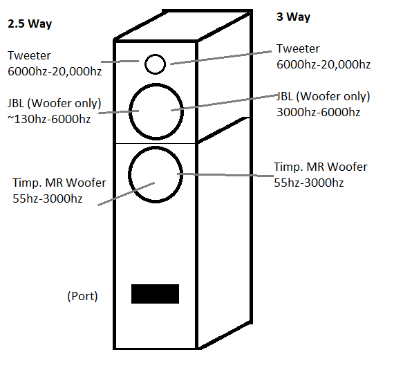

I know this won't sound great... will using a 6" 2way and 6" midrange in series for each Left and Right channel (all 4ohm). Going to sound too terrible to try?
I have a single large 3 way 8ohm for the center. and a pair really low end 4" full range for the rear.

Hi again, wickette!
So, each one of your speaker boxes (L, R, Centre and Surrounds) would ideally have a nominal impedance of 8 ohm.
Can you measure the dc resistance of each speaker box with your ohmmeter?
Each box needs to measure around 6 ohm resistance to avoid potential damage to your receiver.
P.S. Is this endeavour a continuation of your previous speaker design thread (see attachment)?
P.P.S. As to how this mish-mash would sound - who knows! 😀
Well if your 2 ways and 6" driver are both 4 ohm then in series they will be an 8 ohm load. In theory. In practice the impedances of both will vary over frequency, which will change the frequency response of the system (as the two speakers in series will form a voltage divider, so the speaker with higher impedance at any given point will take more voltage). Do you have impedance and or frequency response plots for either of the speakers? It's a guessing game without more info on what happens to frequency response. Will you have any passive crossover in place in front of the midrange?
The other option is to connect them in parallel but since both are 4 ohm I would recommend against connecting them that way.
I'm also not sure how you intend to space the speakers. More drivers will lead to angle dependent comb filtering resulting in frequency response changes as you move. It will change based on driver spacing and axis just like in a conventional multi way speaker. Depending on the goal, spacing, coverage angles needed, this can be acceptable or not.
On the whole I think your chances of roaring success are relatively low but it's impossible to be very specific without more details on the equipment involved and your goals.
The plan that wickette had for each of the L and R speakers (it may have changed by now!) was to build a three-way system as shown in post #4.
IIRC we have, from top to bottom: 1. A hi-fi tweeter, 2. a coaxial car driver (with its coaxial tweeter removed), and, 3. A hi-fi midrange driver.
The car driver would be in its own ported enclosure to act as a woofer and the midrange would be in its own sealed enclosure.
Capacitors would be used to filter both midrange and tweeter drivers.
He never mentioned connecting the drivers in series at the time. I naturally thought they would be wired conventionally.

Probably the most important question is: will you be using a sub? If so, your mish-mash set-up will be less problematic. A 6" coaxial car-speaker is likely to be pretty useless below 100hz. If the specs sate otherwise they are probably quoting f10.
Is the 6" mid-range driver a genuine mid-driver. i.e. is the back sealed? If so you don't need to separate it from the woofer. You also don't need to wire it in series as the nominal impedance is maintained by the crossover.
The impedance of a driver fluctuates with frequency. Generally speaking impedance is lowest at the resonant frequency. Use a 400mf capacitor as a high-pass filter on the fronts and the rears. This will offer an impedance your amp will tolerate.
The AVR is rated for 6-8 ohm. And has overdraw protection so I'm not very worried about the power aspect as long as the 4ohm speakers are in series. It's the sound aspect. My mish mash is not good enough listening to movies/dialogue. In a 5,7,9 channel setup the center should be taking over most of that duty. Right?Hi again, wickette!

The question is how weird is a 3way Center (12" woofer, 5" mid, 4" horn tweeter). going to sound with a two 6.5" woofer with 0.8" silk left/right Channel,
(vs buying 3x $20 passive bookshelf speakers)
haha, not directly.P.S. Is this endeavour a continuation of your previous speaker design thread (see attachment)?
Those towers turned into our outdoor speakers, and are 4ohms. I have a lot left over from that project and the original 4ohm 2way cross over. Id be using the 2way I made in series with a different 4ohm speaker.

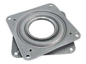

Id reuse the enclosure, its a 0.45 and 0.75gal enclosures attached to each other with lazy susan hardware. So the lower one woofer faces the listener the other turned 0-90deg away.

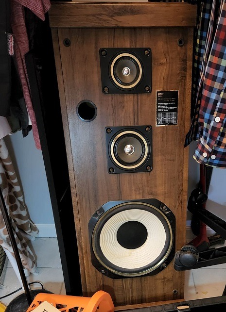

*** the only reason I'm wiring a pair of L/R speakers in series is to avoid hooking up a 4ohm speaker to the avr. No other reason.
Sorry wickette. I'm not into home theatre, so am unable to comment on the correct method of reproducing dialogue. All I know is that your centre speaker design does not correspond with that of the commercial ones I have seen.
It's not "my design", It's a very run of the mill looking cartoonishly large floor speakers. MCS 683-8295.Sorry wickette. I'm not into home theatre, so am unable to comment on the correct method of reproducing dialogue. All I know is that your centre speaker design does not correspond with that of the commercial ones I have seen.
The question is how weird is a 3way Center (12" woofer, 5" mid, 4" horn tweeter) going to sound with a two 6.5" woofer with 0.8" silk left/right Channel.
You can use any speaker for your centre channel, but ideally, you'd use a speaker that has a horizontal cabinet design so it can be more easily placed above or below a TV
However, it is important that the centre speaker should match the L and R speakers in tonality in order to create a convincing sound stage. That's where your "mish-mash" of centre and L/R speakers may fail to satisfy. Centre and L/R speakers are best to be of the same brand so that they sound the same to your ears. Sometimes, it may be possible to compensate for mismatched centre and L/R speakers by using an AVR's equalization capabilities.
I learned all that from the internet! 🤓 https://www.lifewire.com/center-channel-speaker-4142693
P.S. I read that MCS loudspeakers were made in the USA and distributed by J.C. Penny Co., Inc., New York - I haven't come across them before.
I wonder what happened to your MCS's stereo partner. 🤔
