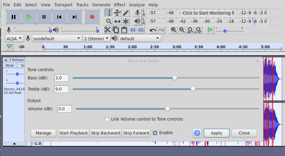

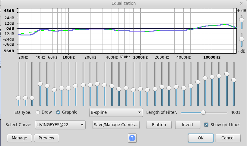

I do not have an equalizer so I had the idea of processing the mp3s using the Audacity application and exporting the files to disk, then copying them to CD. The results are fine, and I feel I am restoring the sound of the recording rather than simply equalizing to my tastes.

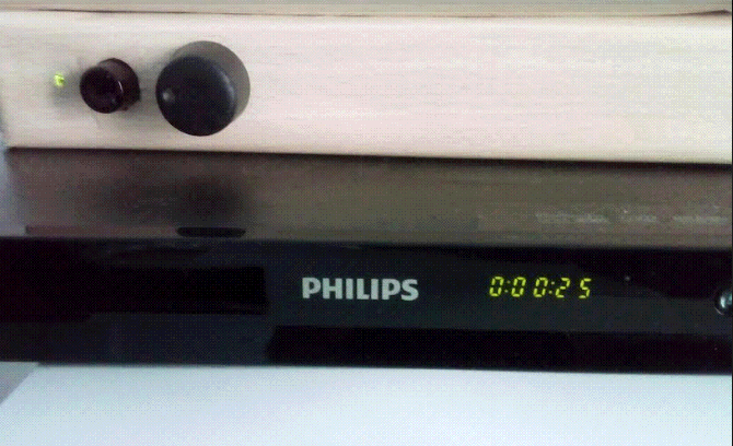

I will attach pictures of my DVD player, home made amplifier (TEA 2025 ) and speakers.
Initially I tried Bass and Treble boost, it did not work out too well.

I can't speak to your EQ curve suitability, only you would know. But otherwise you are doing it right.
I don't remember if Audacity has a batch function, some editors do. That makes the whole process a lot faster.
Audacity or any other software has to uncompress the MP3 before working on it. You get what you get, depending on th4 quality of the MP3. High rate MP3 can bee rather good.

Here is a picture of my DVD player and my amplifier. I learned about DVD players they really smoke... if you don't use them for a while, so I thought I might as well use the one I have. Works fine so far: good blank CDs and recording at the lowest possible speed 4X or 10X is the best.

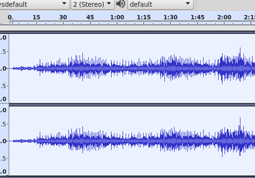

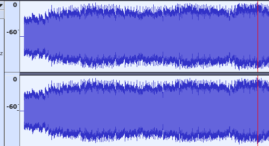

To complicate matters further, and I have attached an image, some of the files don't play very loud: I can increase the amplitude, normalize, or do something else, but equalizing does result in red lines 'distortion' peaks, that do not seem to affect the sound too much.
Any suggestions? A batch function would be handy, have not found it yet.
Take a look at this track for example: "Finding out the Hard Way" - Cynthia Rhodes, Stayin Alive , 1983

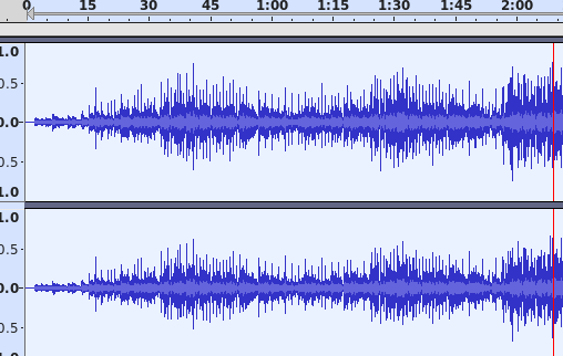

Normalised:

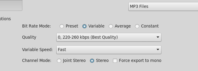

mp3 export settings - alright?
The sound quality of the mp3s are all listed as '192 kbps' which is one of the lowest available, but that is not the whole story. Some of the recordings are noticeably better than the others and I have the original cassette tapes to two of the albums I now have mp3 versions of: those also sounded different, one was better quality than the other.
Normalised:

That is true, however the 'data' is present, in terms of low amplitude sounds, these have to be boosted to normal levels, of course something may be lost in the translation.equalizers just try to put a pleasant spin on what you have; they cannot add in data that was removed from the music.
once data is removed, you can't really put it back.

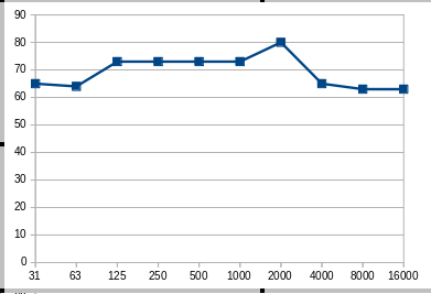

A rough plot of dB vs frequency measured by a mobile phone running JBL Tools and the online tone generator.
Ideally I should be plotting the subjective loudness against the frequency, or move up the volume at each frequency to preserve the loudness of the tone.
That said, the lower frequencies really could not be heard too well, and the frequency response of the speaker itself needs to be equalized in any case: the loudness perception effect only makes the lack of perception of high and low frequencies worse. Subjectively, however, the 1 kHz tone sounds the loudest.

Are you exporting as MP3 after EQ? Is that what you are showing?mp3 export settings - alright?

- For MP3s use the highest bitrate available.. should be 320kb/s, but really since you are burning to DVD you should use wave files instead as you have no shortage of storage capacity... up to 7 times as much as a CD.
Yes, importing the mp3 then equalizing, normalizing, then exporting as mp3. Should I import, convert to .WAV , equalize, then re-export?

I changed the scale to dB, that fattened up the plot somewhat, not sure why, amplitude and dB should be the same thing? Normalizing fattened it up further. Why on earth were older CD's recorded below 0dB?

You want to export to wave, for sure. Don't compress again. Now that's the easy part.
Volume leveling is the hard part. As you've found, not all tracks are recorded at the same loudness, we wouldn't not expect them to be, but we'd at least hope for not too much variation in the same genre of music. If you don't know about the Loudness Wars it's worth reading about. @MrKlinky has mentioned this effect already.
If I need to level volume then I just use that setting in my music player. My files have been scanned so that the player knows their loudness values. The player will lower the loud tracks and bring up the soft tracks to an average. But it isn't normalizing, it's mostly reducing the volume of the loud tracks. Trying to get everything the same level and as loud as possible without clipping means that the softer tacks will need to be boosted and compressed. In other words, the loudness wars in you own home. 🙂
Open the files, "Normailize" them to -3db. Then apply your EQ, then normalize to 0db and save as .WAV
