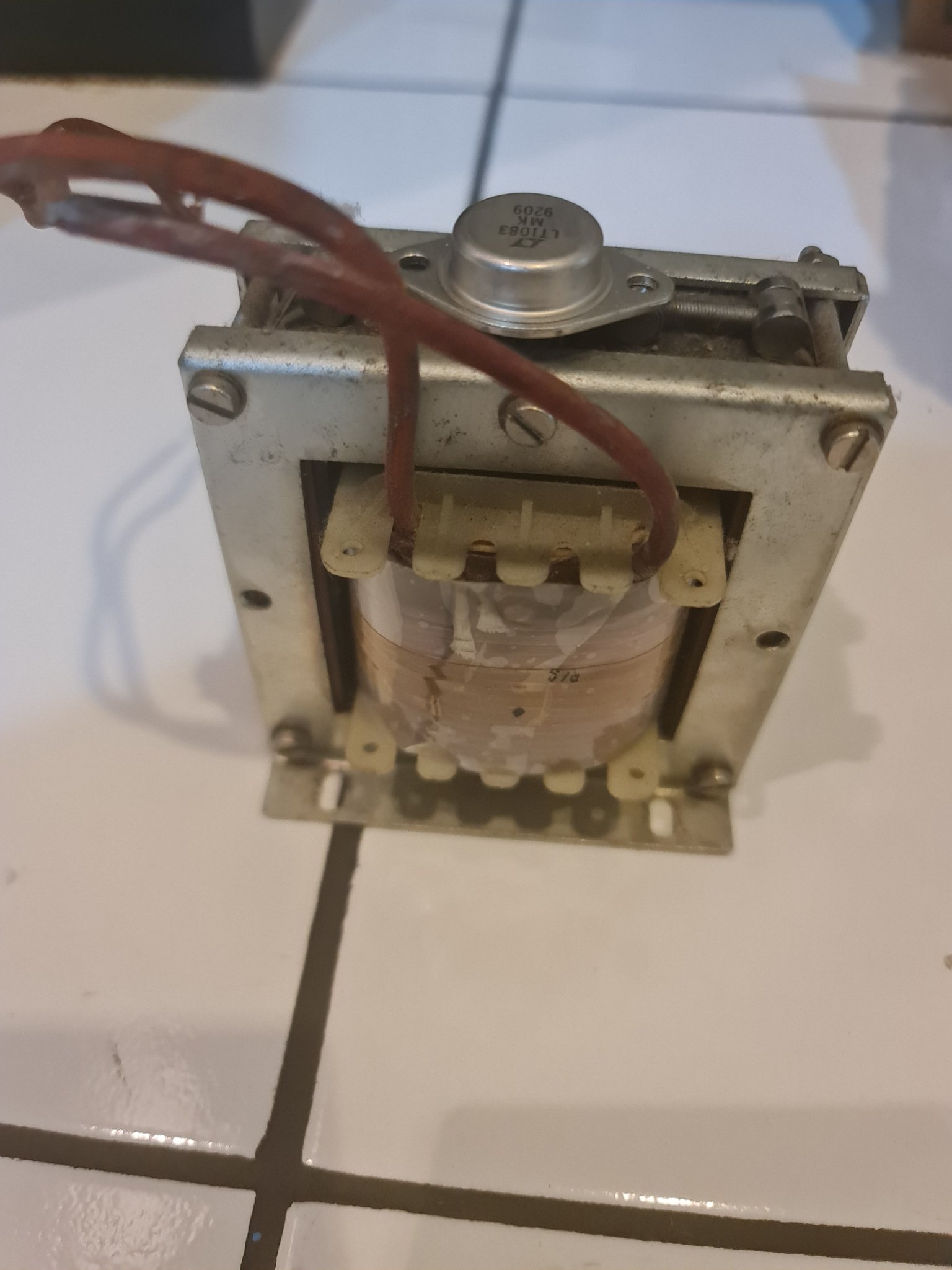

It's possible to specify the input choke of a choke input filter so that it will saturate on the turn-on current surge. This will leave the choke's DCR as a resistor so no inductive high voltage spike.

I have a choke with spec of 5.4mH and 0.3ohm
Bridge -LC-RC
Caps are 82mf
R is 1ohm
Is it possible to use as choke input? As i try to drop some voltage as well.
I try simulate in duncan it gives me error
Here is the size of the choke compare with to-3
Thx in adv
