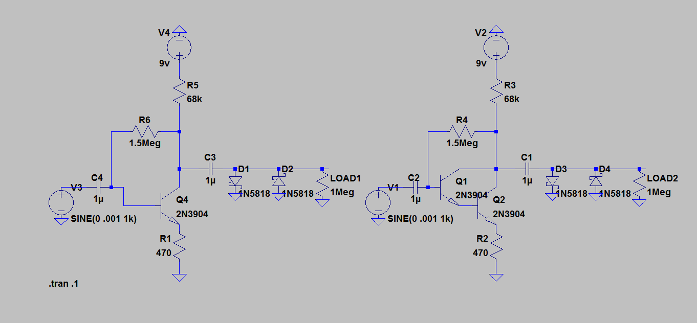

Sure, here is a simple example. The gain theoretically should be 150 about based on the the collector to emitter resistor ratio, but I'm told that gain is limited to about 40 etc practically., simulations though show 85 for the circuit on the left and 60 for circuit on the right (darlington config). I was just trying to get a gain of about 100 or so with an extra transistor.
The voltage gain being equal to the ratio of the collector resistor to the emitter resistor is a rough rule of thumb.
What input level are you using? The output is limited to 0.6V peak regardless, so the voltage gain would be higher
if you reduce the input signal level to the point where it just clips. Or, use two series diodes in each location
if you really do need a higher absolute output voltage when clipping.

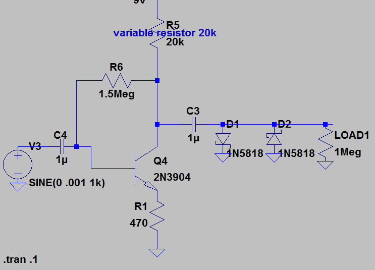

Well, here was my thinking, I made the circuit on the left and I increased the collector resistor from 0 up to about 20k and above 20k there is no audible change I can hear. Turns out that is about a gain of 40 theoretically, and I am told that is about the limit of a simple single transistor (2n3904). So my thinking was if I made a darlington pair maybe I could get more gain out of the circuit.
By gain, you mean output voltage for a constant input?
You can't get more than 0.6V out of that circuit, and even less for Schottky diodes.
Of course, if you clip harder with a higher input, it will sound somewhat louder.
Well, I know that maximum voltage and minimum voltage are going to be limited by the clipping diodes, but if you drive the diodes with a higher and higher voltage, you should get more of a square wave as the output and the "gain" or "drive" increases. For example, if you took an op amp with a voltage gain of 40 and 200 and the output is clipped by output diodes, you would expect the same maximum and minimum voltages clipping on the diodes, but the waveform would be more square with the op amp with gain of 200. I'm trying to drive the diodes harder to get more of a square wave. That's what I was hoping to do. I've read the "gain" of guitar distortion circuits are around 150 or so. But really that is not really "gain" because that would be the output/input voltage. What I think they refer to in guitar distortion circuits is "gain" before clippling or "gain" driving clipping. Maybe gain is not even the right word. But, I guess it would make sense to call it gain if the input voltage is say 1mv amplitude, and then the circuit produces a sine wave amplitude 150mv, but clips at about 300mv peak.

Changing a simple BJT circuit from a single transistor to a Darlington will, as the OP has discovered, reduce voltage gain. I don't know why he expected anything different. All the Darlington will do is raise input impedance, which may or may not be relevant. It certainly won't be relevant in a simulation driven from an AC voltage source (with presumably zero output impedance) - this is almost certainly a poor model for the real circuit. In any case, the increase in input impedance due to the increased current gain may be swamped by the feedback from collector to base via the resistor.
A BJT is a transconductance amplifier with finite input and output impedances. Input impedance is set mainly by current gain. Output impedance is set mainly by Early effect. Together these limit voltage gain. Circuit details then reduce it further.

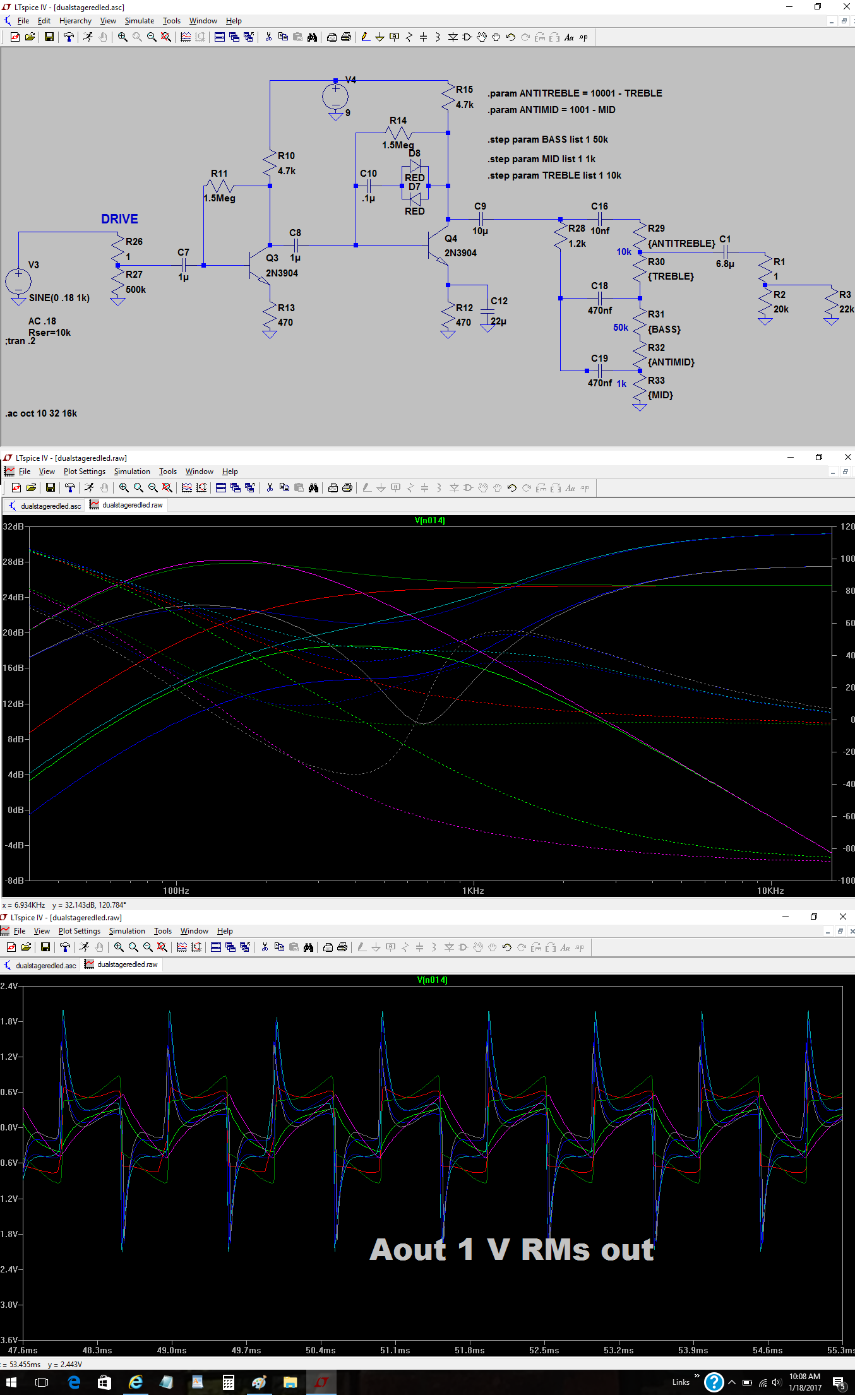

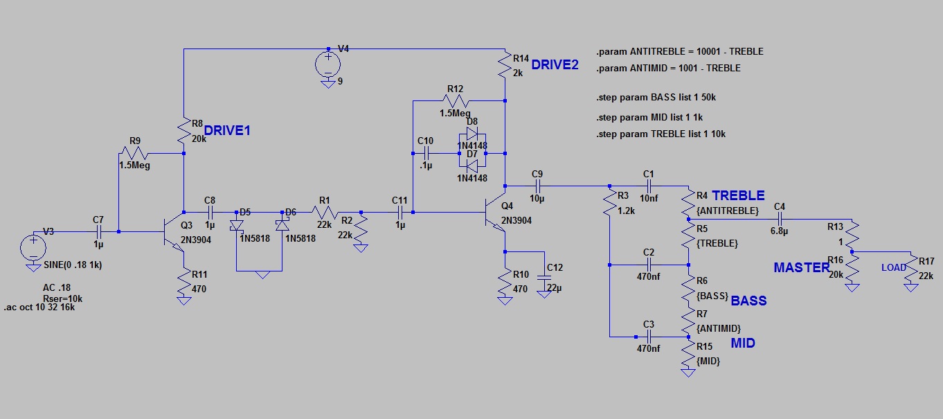

Thanks jeff5may. I was experimenting with a couple stages similar to what you were saying, and I think I got a decent sounding distortion. I kept the diode clippers on the first stage and put a potentiometer between the first and second stage, and then lowered the wiper to get rid of some of the noise, then, I replaced it with a voltage divider. The second stage was ran into another distortion stage with diodes in the feedback loop. I then ran it into a scaled down marshall tonestack and I think it sounds pretty good for an experiment. I'm going to try some different clipping variations and leaving out the first set of diodes and just a voltage divider. Thanks everyone
I cut out the middle diodes and then ran the first stage into the second, but added Red LEDs as feedback clipping on the second stage for higer output levels. After running through the tonestack as shown, I got peak values of 1.4v measured, which I suppose is around 1 volt rms roughly. (I thought about adding some Infrared LEDs that clip at around 1v at the very end to clip of the tall peaks if this is an issue going into a power amp but have not done this).
