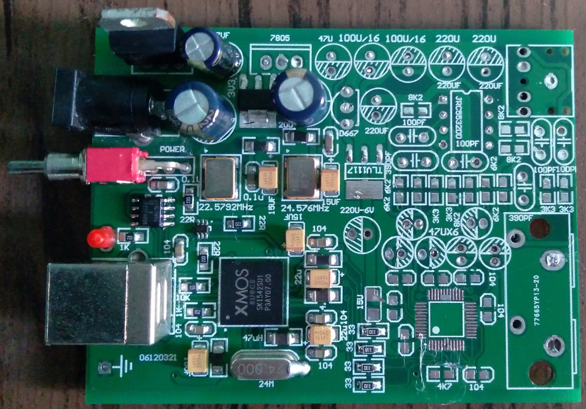

I have this board here working.

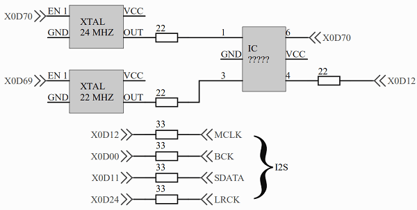

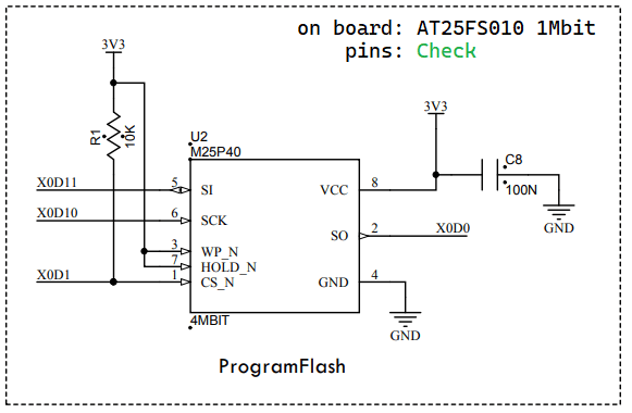

I removed unnecessary components to work, and briefly reverse-engineered the used pins.
flash memory is in accordance with the design guide.
xtal is attached schematic.

So this board (image) is useless.
I need to buy a new, "unprotected"xCORE chip to replace, and then be able to flash my own firmware? 🙄
