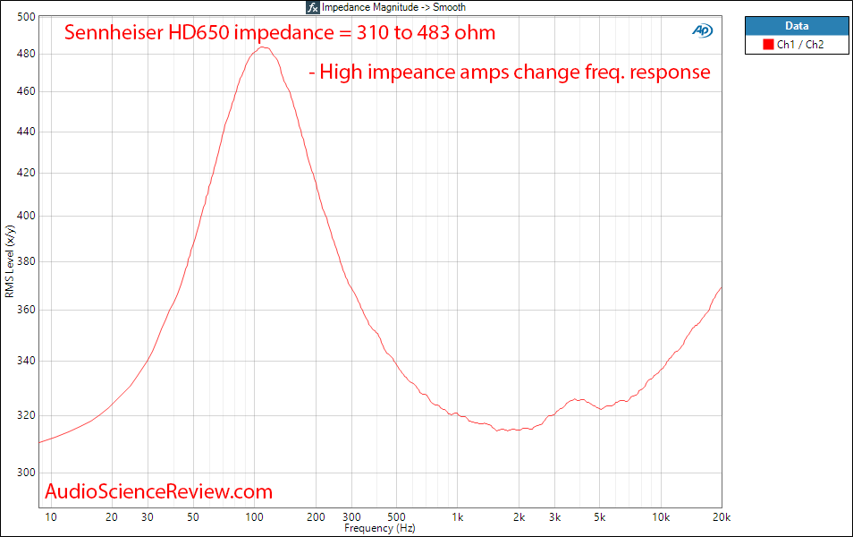

All the headphones I have ever owned had a very constant impedance across the audio band.
I doubt that very many headphones that are driven by a high impedance need much damping.
They generally are not like a woofer in a closed box, or in a ported enclosure.

The Sennheiser "300 ohm" large diaphragm phones can have a big bump.All the headphones I have ever owned had a very constant impedance across the audio band.
https://www.audiosciencereview.com/forum/index.php?threads/sennheiser-hd650-review-headphone.18774/

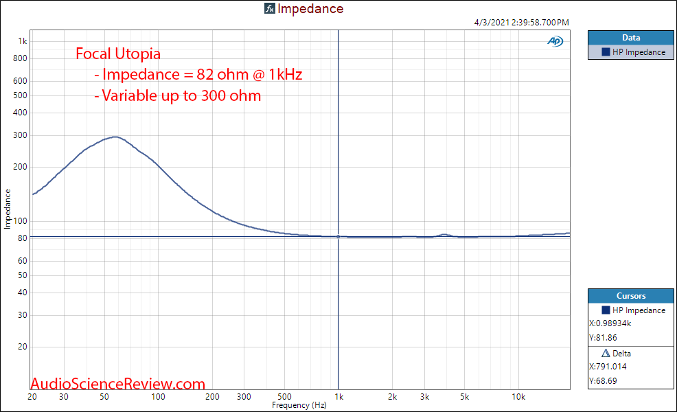

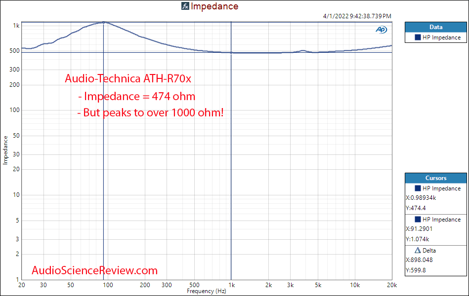

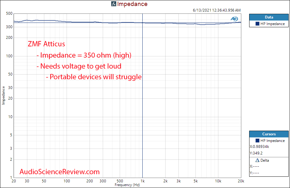

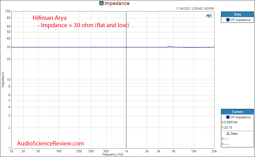

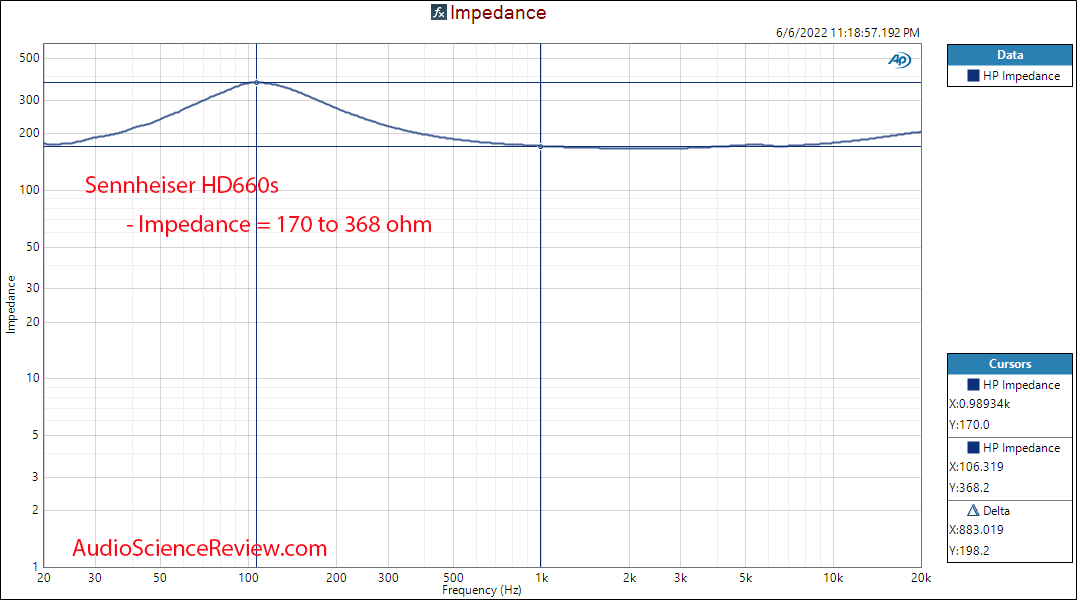

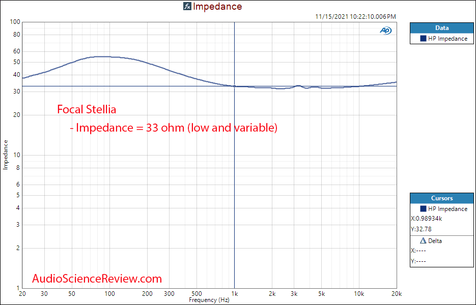

It's a bit all over the place depending on the technology and model...planars usually have constant impedance across the frequency range. Dynamics have oddities.
Here are a small selection of well-regarded headphones:
There is a bit of a pattern in these previous 3.
But then...
So, it varies, both in quantity and flatness...

PRR, ElArte, and adason,
I was wrong about the flat impedance curves of headphones.
So, I took a look at your Sennheiser 300 Ohm model.
The Sennheiser varies from about 310 to 480 Ohms.
About 395 +/- 85 Ohms; (395 +/- about 22%).
That is like an "8 Ohm loudspeaker" varying from about 6.3 Ohms to 9.7 Ohms.
Wow, pretty good!
I wish all loudspeakers had impedance curves that flat.
The worst headphone curves posted in this thread were about:
One at 4:1 impedance, and two at 2:1 Impedance.
Lots of loudspeakers easily exceed 4:1 impedance.
Perhaps we need to worry more about vacuum tube amplifiers that drive loudspeakers;
and worry a little less about amplifiers that drive many models of headphones.
Perhaps a fixed T attenuator, or a fixed Pi attenuator could be used to work with at least one model of headphone that has a wide impedance variation (A low impedance amplifier output, and a low impedance fixed T or Pi attenuator should flatten things quite a bit).
Now, back to driving those pesky loudspeakers!
And, I enjoy driving and listening to many different loudspeaker models.
