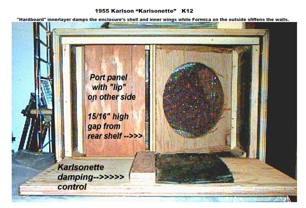

Some Karlson enclosures, such as my ~1955 Karlson Twelve (then called the "Karlsonette" and introduced at the 1954 Hotel New Yorker Fair) had their outer shell and "wings"/"curtains" made of 5/8" plywood laminated to 1/8 " hardboard and a Formica covering which made a reasonably inert wall and nice reflective surface for the front chamber.
