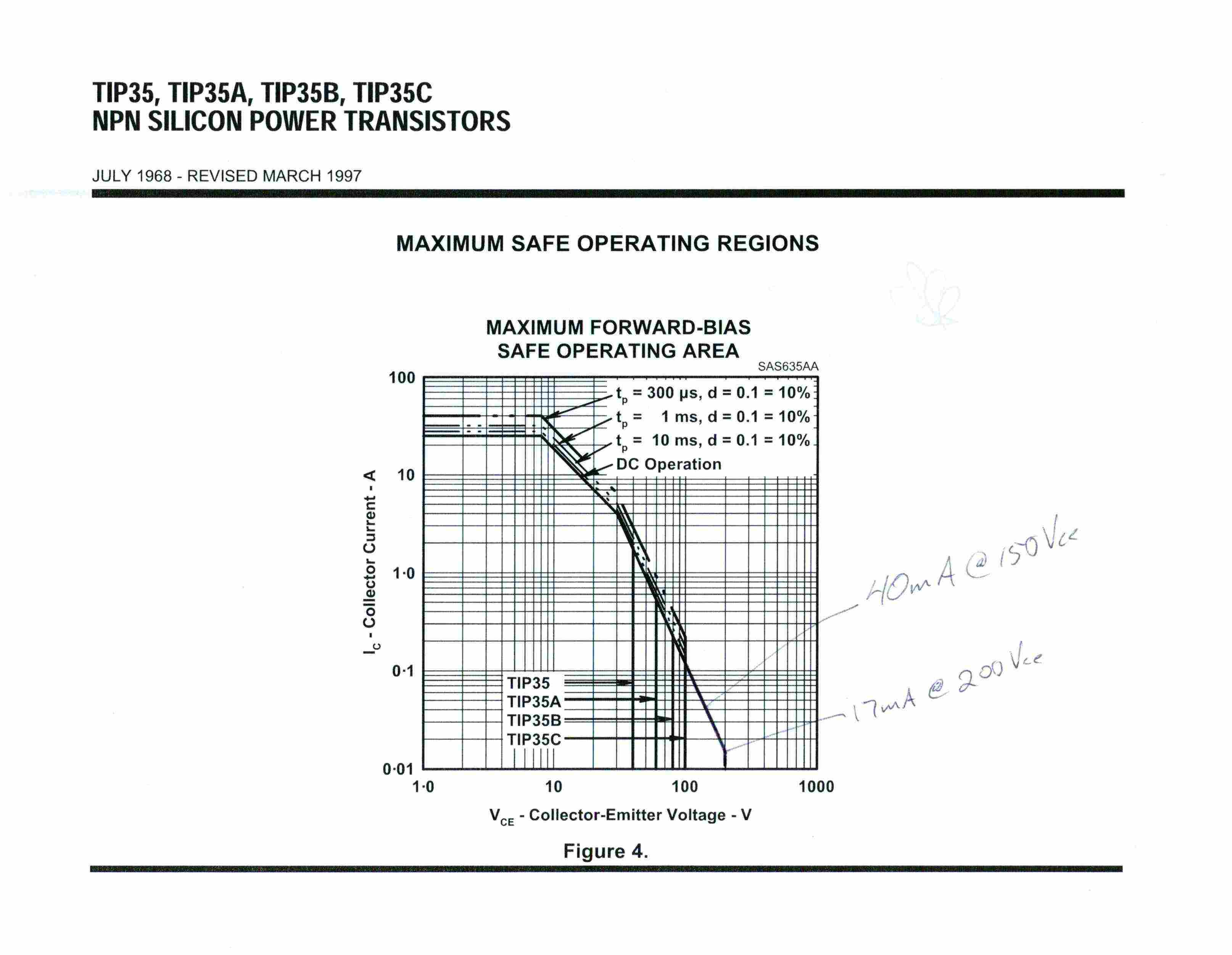

Remember that the secondary-breakdown curves on the TIP35/36 start folding back above 30V, the MJH11021/22 fold back above 40V.
@ djk
No. I measured Vceo and Vce with the base shorted to the emitter. Would you mind explaining what the significance of SOA curves "folding back?" It's been quite a few years since my Advanced Linear class in college. LOL Looking at the SOA curves on the data sheets, I would naturally extrapolate the acceptable current at the higher Vce making sure I'm under the curve. And, for output devices, parallel them as necessary to ensure dependable operation even under worst-case reactive loading.

I don't think that would work. SOA has to do with current bunching on the die at a specific actual Vce. The fact that a particular device would survive a higher-than-advertised Vce doesn't increase the SOA.

"Would you mind explaining what the significance of SOA curves "folding back?" "
MJH11021 is 150W at 40V but only 40W at 100V, the power rating starts to fold-back above 40V.
As janneman points out the hot-spots on the die get worse at higher voltages.

Thank you Jan and jdk. I think we're all saying the same thing. As in my first post, SOA, thermal deration, etc. all must be carefully accounted for in the amp's design - and for my post, particularly the power outputs. I've built a number of power amps over the years, including a very nice 720W (when bridged into 4 ohms) car amplifier (including the 1.5KW DC/DC converter!), and worked for an amplifier OEM for a number of years - all with very good success.
I've attached the SOA curves for the TIP35C power transistor. I drew a line extending the SOA curve from the original 100V out to 200V following the deration. Out at 200V, with the current dropping by the square, the transistor could only handle 17mA! In theory, that is! Seeing as how that's less current that outputs are often biased at, it clearly wouldn't work. And this doesn't even take into account hot-spots on the die, as previously mentioned. Again, I understand these operational conditions. I have no intentions of pushing these devices anywhere near these levels. I do have 50 or so sets of TIP35C & TIP36C, but I still don't want to build an amp only to have it blow up, or worse, blow up my lovely speakers!
I just did a search, and it looks like MOSPEC actually makes TIP35 and TIP36 in D, E, and F parts too! Just like the 'C' part = 100Veo & 140Vcb, the D = 120Vceo & 160Vcb, E = 140Vceo & 180Vcb, and F = 160Vceo & 200Vcb. So the device OEM knows some of the parts can withstand a higher voltage. I just happened to stumble upon the specs with my NOS parts and a home-made breakdown tester. And, their deration curves look just like the one I drew and attached! Check out the attached datasheet to see the higher voltage part. Sure these aren't the best parts considering the wonderful options currently available, but since I have them, it's what I use to play around with.

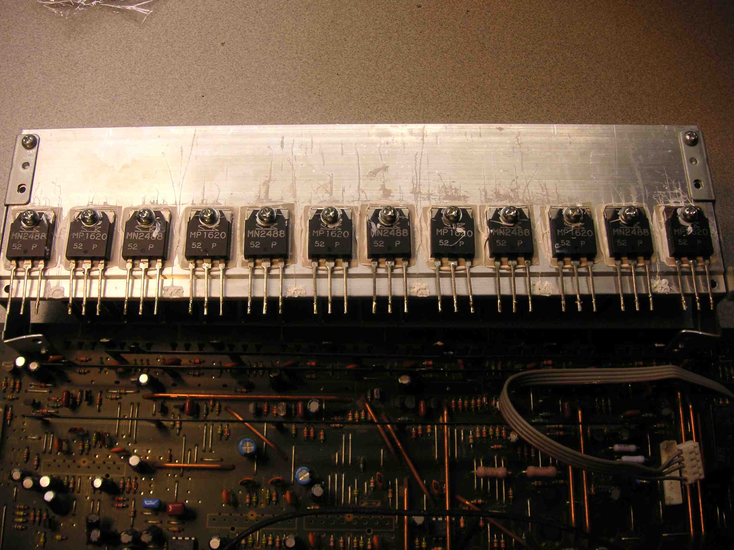

Measured some more devices
I was just salvaging some power devices from a damaged Sony amp and measured the Vceo and Vcbo ratings. The outputs used in the amp (see attached) were MN2488 and MP1620 Darlington devices.
MN2488 (NPN):
Rated: Vceo = 150V, Vcbo = 160V
Measured: Vceo = 205 to 220V, Vcbo = >320 (limit of my tester)
MP1620 (PNP):
Measured: Vceo = 190 to 210V, Vcbo = 250 to 280
Again, with the SOA folding back so severely, these parts wouldn't be much good near their measured voltages. But, they would probably work well near, or even at, their rated voltages still having enough SOA (with enough devices paralleled) to work quite well.
What do you think?

seeing that datasheet ratings are lower than actual gives one more confidence...but i will still respect datasheet ratings...
"So the device OEM knows some of the parts can withstand a higher voltage. "
But the forward-biased safe area of operation still starts to fold back above 30V or so.
Unless you build a tester for forward-biased safe area of operation you know not what the part can do.
On Semiconductor 100% hand selects their TO-3 parts to meet the published specs. If it can't make the higher spec it is labled with a part number of a lower spec device.
TIP35/36 parts make a good choice for the top rails on an amplifier with tiered supplies, they can really push the current. They also work well on ±35V in bridge mode for car stereos.
