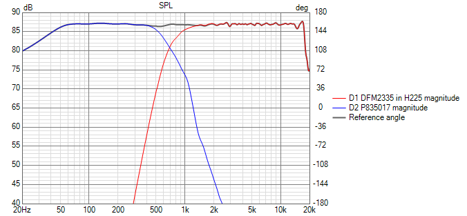

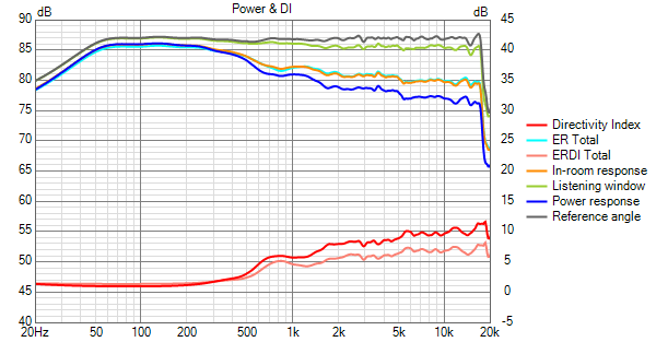

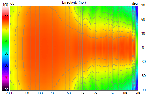

My son wanted a bigger speaker for his electronic drum kit, so as a joke, I used some parts sitting on the shelf to design a 2 way.
It has a 2" aluminum cone subwoofer stitched to a 1.4" titanium compression driver.
The difference in sensitivity of the two driver is some 12dB... so it needs to be matched actively.
Passively, you're dumping (and wasting) a heap of power into the resistors just to attenuate the HF driver, so I wouldn't recommend that approach.

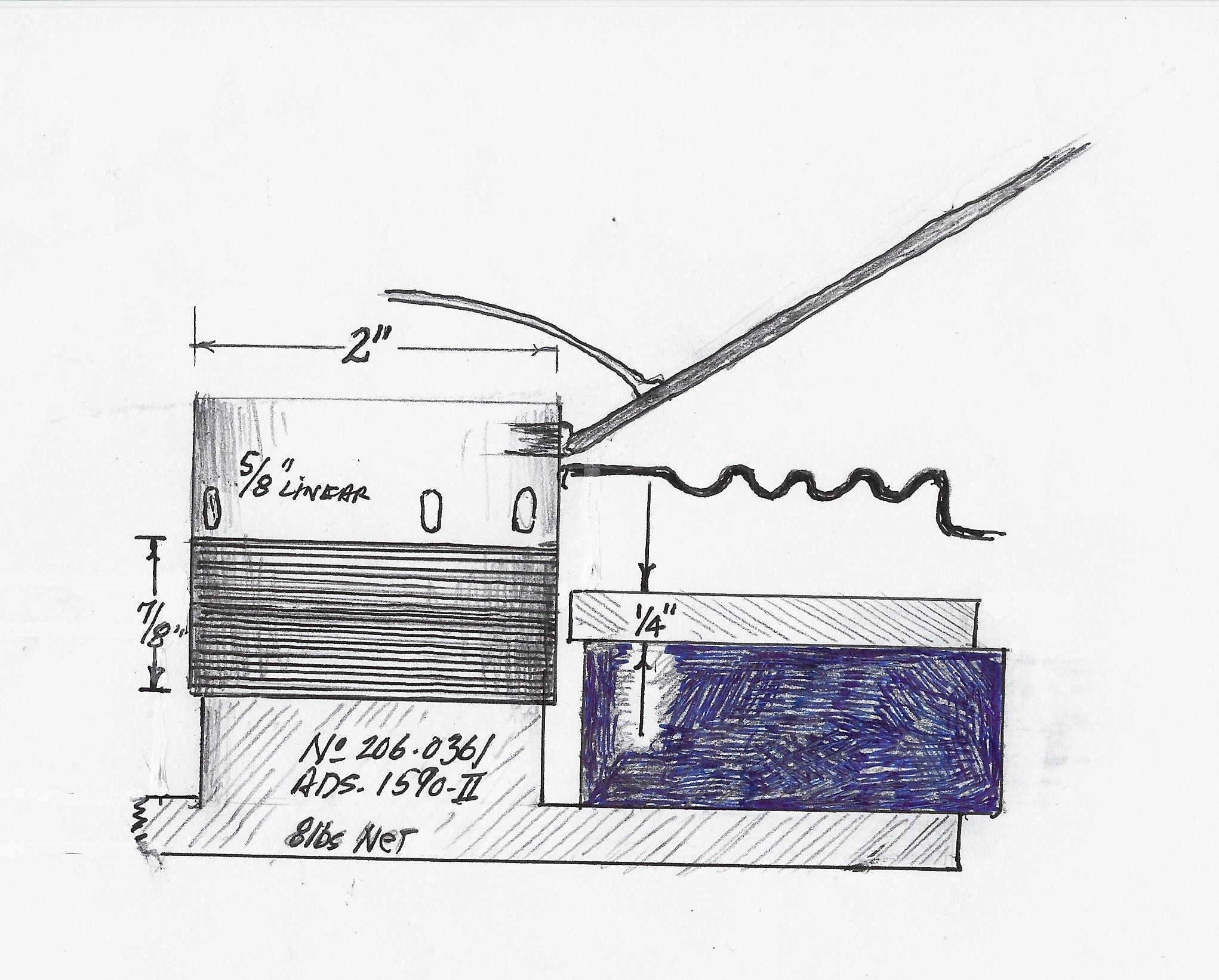

So it’s 2” diameter VC and the gap and coil dimensions are for an overhung motor with a geometry based excursion of 5/8” peak to peak.
Which is about 8mm one way.
So it could be a Low excursion subwoofer or high excursion woofer.
What’s more useful is a frequency response and impedance curve. T/S parameters handy too

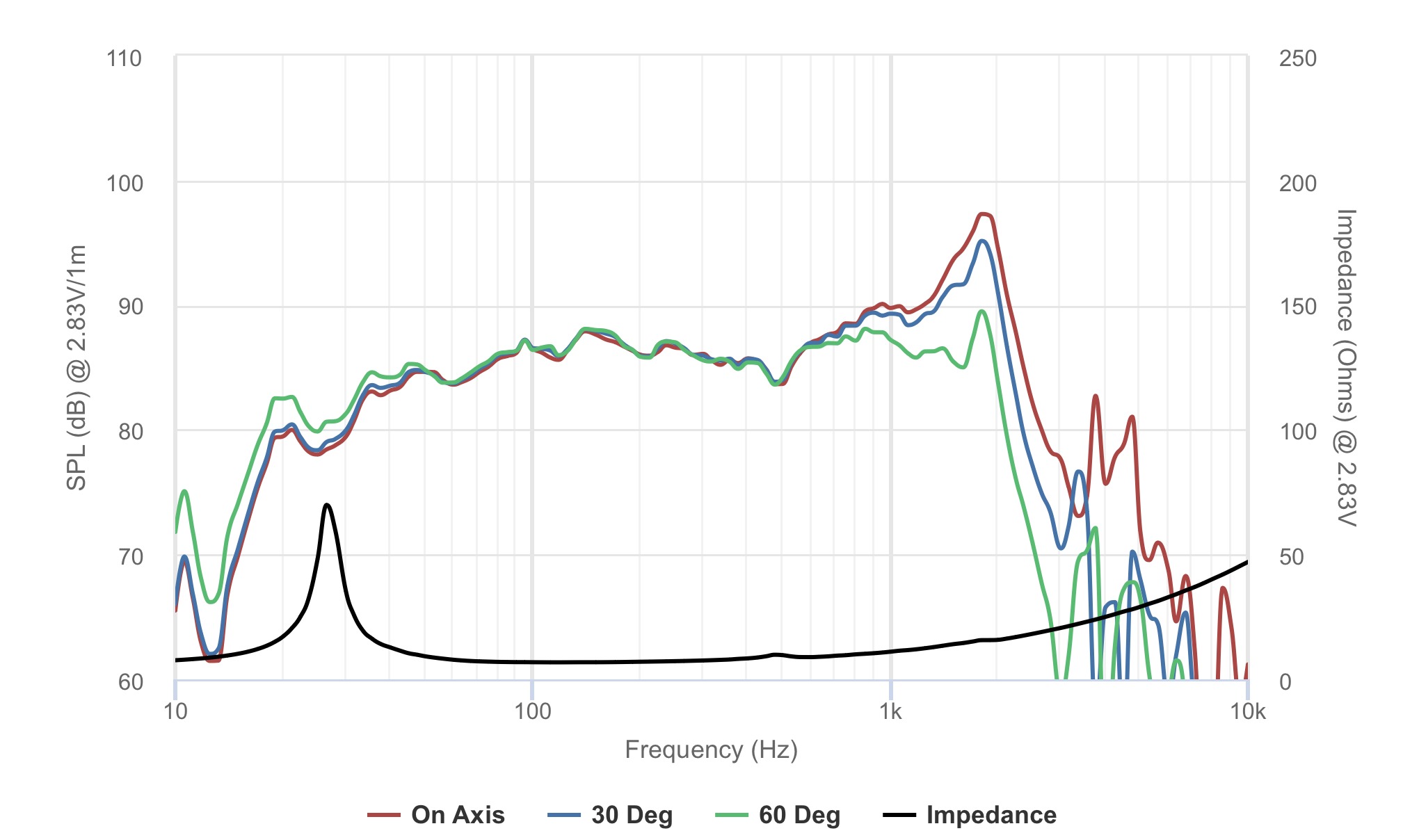

Here’s an example of a driver marketed as a 12” subwoofer (ie: <120Hz)
Here are the minimum information to check it it’s suitable for woofer use (ie. ~50Hz to ~300Hz)
Impedance | 8 Ω |
Resonance Frequency | 29 Hz |
Sensitivity @ 1W/1m | 85.9 dB |
Rated Noise Power | 175 W |
Minimum Impedancee | Zmin | 6.8 | Ω |
Voice Coil Inductancee | Le | 0.768 | mH |
Mechanical Q Factor | Qms | 12.5 | |
Electrical Q Factor | Qes | 0.69 | |
Total Q Factor | Qts | 0.65 |
Effective Piston Area | Sd | 491 | cm2 |
Maximum Linear Excursion | Xmax | 15.2 | mm |
