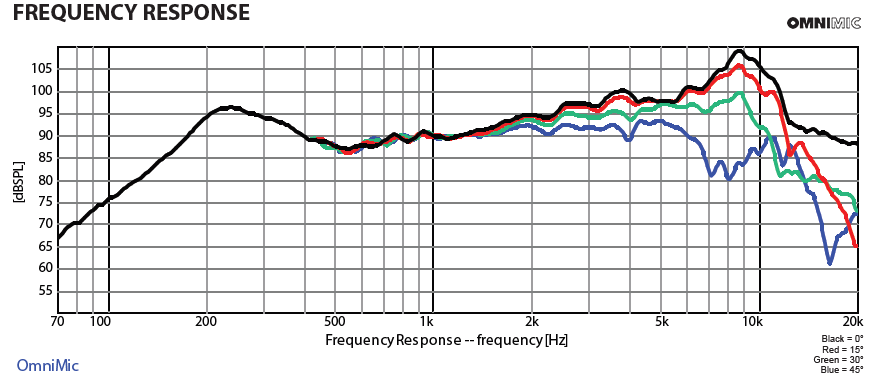

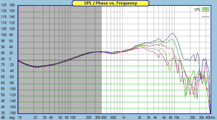

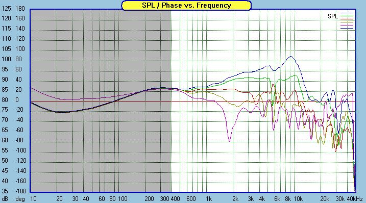

I was hoping to cross over to it around 700 to 800 Hz, but the response is starting to sag there, with the SPL dropping down to under 90dB/W (the driver is rated at a nominal 94dB@2.83V).

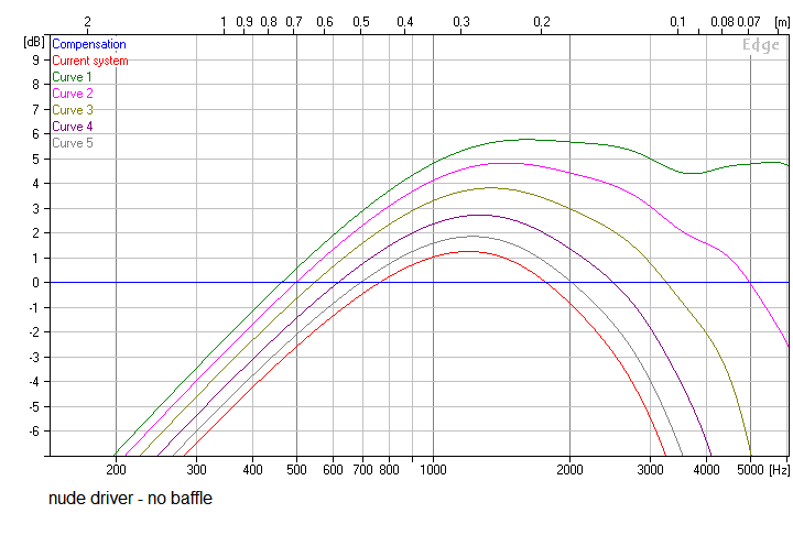

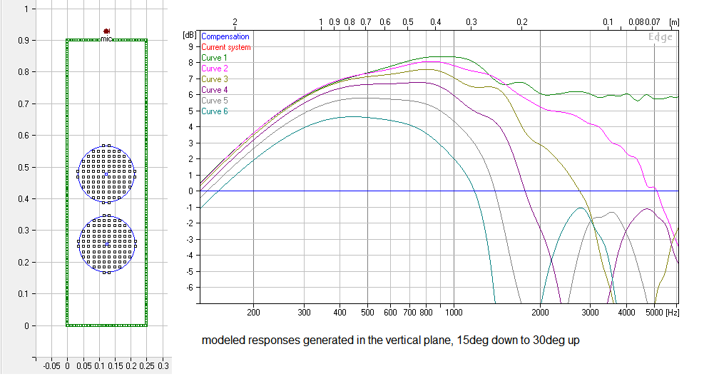

To get a sense of what I might expect in a baffle of anything from zero (nude) to as large as I want to go I used the Edge to simulate some responses at a few angle up to 45deg off axis. I thought I would share what I found, which I think is indicative of how many drivers in planar baffles will behave as you vary the baffle size. Keep in mind that this is only the response of the baffle - you have to add it to what the response of the driver will be, e.g. its nearfield response. For that I will use the MFG curve for now until I can measure it myself.
First, let's look at the "no baffle" or "nude" response. It looks like this:
This has a very smooth response. The curves all follow each other, with only a bit of narrowing above 1.5 to 2k Hz. I would call this "CD like". There is very little sign of a classic "dipole peak". But since the low frequencies start to roll off just about 1kHz using the driver like this would only add to the downsloping response based on the MFG data.

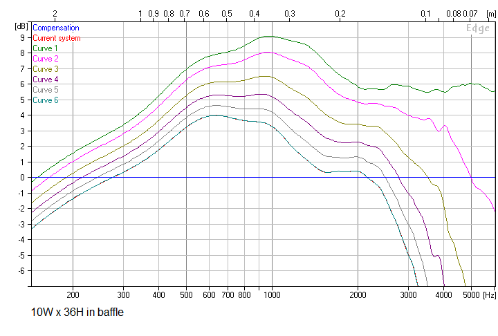

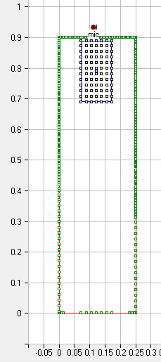

OK, since I was planning to build a "slim" dipole system, how would the driver look in my narrow baffle? I tried out a 36" high, 10" wide baffle with the top edge of the driver at the top edge of the baffle. This what that looks like:
We can see that even this slim baffle has changed the response quite a bit. Now the response has a broad hump in it, centered around 1kHz. The result is that the response below that point has been brought up by a few dB. This would help to offset the losses from the driver in that region. OK, good so far.

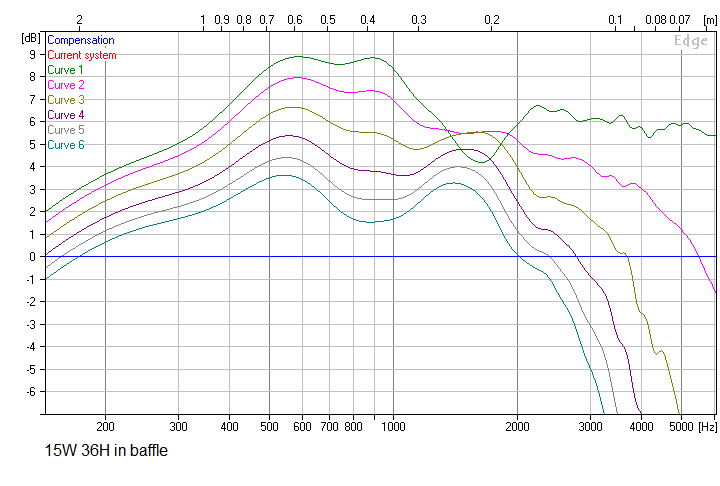

Maybe we can do some of that same thing, but more of it, by using a wider baffle. Let's try going up to 15" W with the same baffle height and top-center driver position. Here is what that looks like:
Indeed, the response down to 500Hz has been brought up a bit more. But there is a new feature - a pinching and even crossing of some of the responses around 1.7kHz. This is exactly what you get when you use a baffle that is more than about twice the width of a driver and has been pretty well documented. It's not desirable to have this kind of response feature, because there is no way to correct for it in the crossover. This happened just by increasing the baffle width by a few more inches!

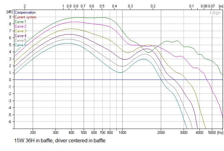

In fact, if you move the driver location to smack in the middle (horizontally and vertically centered) of the baffle, you will almost always get this kind of behavior:
Now the low frequency is well supported by the baffle, but the trouble spot remains, here at around 1.5kHz. It would be fine for a woofer but not for a midrange. This is why I feel that many wide baffle OB systems have built in problems. For instance the classic woofer plus fullranger in a large baffle - it is building in response issues that you cannot get rid of. Some of the Pure Audio Project systems come to mind, for example.
Usually I aim to implement a driver with as little a baffle as possible. As a result, some of my speaker systems are just drivers hung by wires. But that insures the driver responses are as smooth and CD like as possible.
But for this large planar driver it seems that the 10" wide baffle will work great. I hope to use it with a pair of 8" woofers below and a planar tweeter (probably the new GRS one) above, probably nude. It will also be visually "thin" which is helpful for dipole systems because the baffle will not block or interfere with the rear output, which you want to be able to let though so it can form that wonderful open soundstage that a good dipole system is known for.

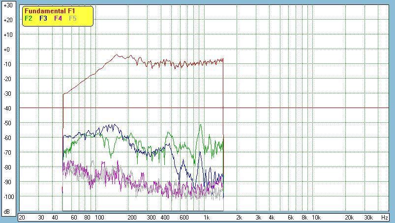

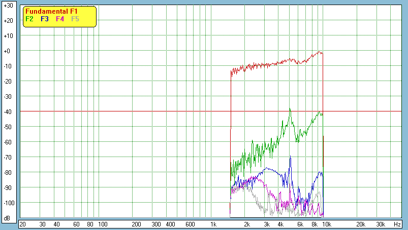

I'm hoping to see non-linear distortion testing on this.. I know from past clones that distortion was often quite a bit worse.. (..apparently getting the spacing right for the diaphragm is difficult - and when you don't distortion goes way up.)

I am indeed also very curious about the distortion of this driver
Just wanted to post a link to some measurements of the real NEO10.

What I am planning is similar to Gerrit Boers "Totem of Tone" project, except that I will (or at least hope at this point) put the PT5010 at the top of a narrow planar baffle to lift the response at and just below 1kHz. Gerrit did some measurements of the Neo10 with "wings" but it is not clear where in the baffle he located the driver. This might be why he measured the "response dip".
Gerrit crossed over the Neo10 at what I would consider a rather low frequency of around 400Hz, LR4. I am planning to use 700Hz LR4, which should relieve the stress on the planar driver.
Below that I will use two woofers, the Peerless 830869 (click link for measurements at HifiCompass). I may roll off the lower woofer so that only the upper one is crossing over with the PT5010. The pair of 830869 will be used in parallel, which will raise the voltage sensitivity by 6dB to about 96dB@2.83V. Because the baffle is slim, I only plan to use these down to about 100-150Hz or so. Below that the dipole losses are too large. I will cross over to some kind of subwoofer at that point. I could use sealed (for a smaller room) or dipole subs.
Hopefully everything will all work out, but only time and measurements will tell.

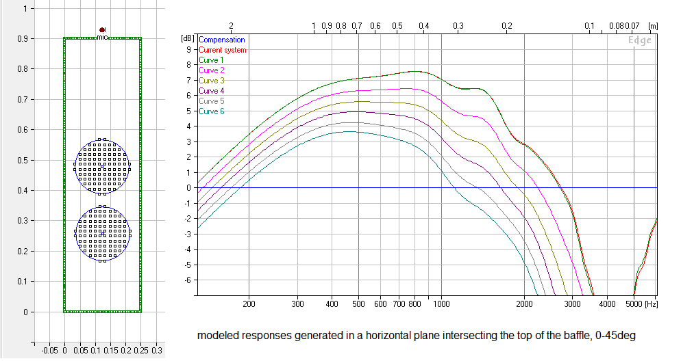

Here are the simulations for the woofers in the 10 inch wide baffle. 700Hz looks like a good place to cross them over. Also, the drivers (Peerless 830869) have a peak in 3rd order distortion around 1kHz that I want to avoid.
As shown in the third attachment, the PT5010 would be located at the top of the baffle above the woofers. I'm not quite seeing what Gerrit reported in his "with wings" measurements, but I am just modeling at this point. I could always drop back to a nude mounting if I need to.
Charlie, would contouring the baffle gain back some of the high end of the GRS?
As you remove baffle you will move through the responses back to the "nude" response.

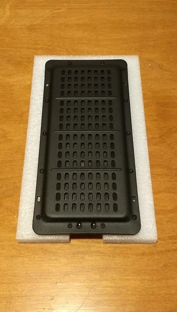

Wow, this driver is a total PITA to mount! There is only a slim bezel around the outside of the frame with four mounting holes. But also sticking up from the bezel are all the screws and nuts used to hold the driver together. Crap, that is going to be a lot of work unless I can jury rig something to hold it in place. Now I see why Gerrit just taped on some pieces of cardboard!
