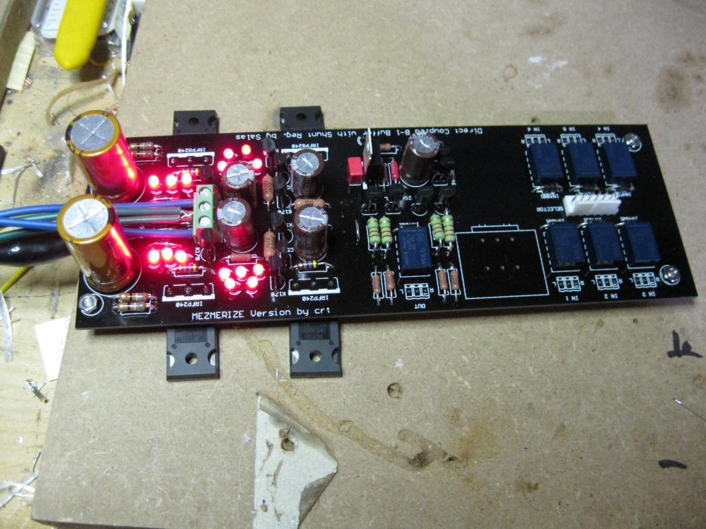

Given the interest of many DCB1S GB participants in exploiting the HYPNOTIZE board as a shunt regulator only, here is a guide of how it can be done properly. You can start exchanging experience and showing builds in this thread after the boards will be delivered to you. Avoid to post reg only related stuff in the DCB1S HYPNOTIZE & MEZMERIZE thread. Lets keep it organized right from the start.
A. Overview
The Hypnotize board's regs part was made to cater for the DCB1S needs. It does not have specially designed layout so to make it easy for a general regulator use, like accepting different sizes of capacitors, variable voltage on the fly, etc. On the other hand, its compact, spread by the GB, and can make do. Lets see how.

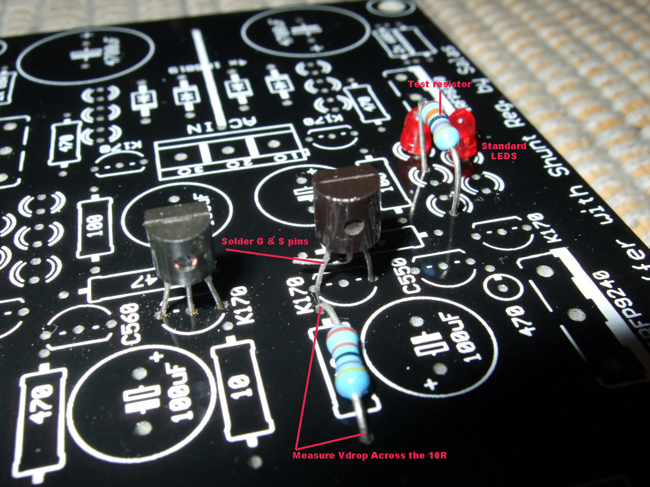

See the attached picture. It shows one side, the positive one. For the negative side you do the same, except one special move you have to do on the positive side considering its Vref JFET. You have to stuff the whole regs part of the board before you set, but the components of interest are shown only, for clarity.
In the Vref pads part you have to insert the two 3mm 1.8-2Vf leds shown. Red green or yellow generic leds are adequate. You put them ONLY in the shown positions. You also install a TEST 220R 1/4W resistor next to them in the specific position shown. You install it high as in the picture, the legs are going to be useful later on.
The positive side JFET MUST be installed with the two far legs only soldered to the PCB. The middle one is bent and soldered to the one on to its left as from the back, off board. The 1st picture is tell tale. So Drain and Source go in the PCB, when Gate is becoming one with the Source pin. You can prepare that before soldering the particular 2SK170BL to the PCB. Cut off the excess Gate pin length. THIS IS NOT APPLICABLE WHEN THE HYPNOTIZE IS FULLY STUFFED USED AS A BUFFER. THE JFET GOES IN NORMALLY THEN. **Also don't do the leg trick if with a BLUE Hypnotize board even if used as PSU only. Insert parts normally, and use the 100uF not the PP 0.22uF.
The negative side 2SK170BL goes in the PCB 3 legs normally, as it can be seen in the picture.
After the regs are fully populated and powered, you measure the voltage drop across the 10R resistors. I=V/R and that derives the current through each Vref for the particular JFETs and transistors to your build. Note that current (few mA) for each side.

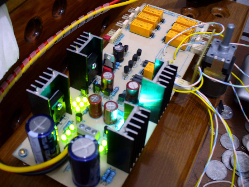

There are two methods. One is to mount the Mosfets underneath PCB like in the 2nd picture and bolt them against a wide sink or thick metal box, or use individual sinks when having the Mosfets upright like in the 3rd pic. Depends on the current and voltage levels, consequently the heat you produce, and of course on your build's mounting specifics.
The heat dissipated is the voltage across each Mosfet times the current it passes. The shunt Mosfets (last ones to the left near audio part) are dissipating Vout X current not used by the load. The CCS mosfets (the ones near the main capacitors) are dissipating Vdiff X total current. Vdiff is the difference between voltage value after rectification and RegVout. Keep that no less than 7V by choosing an appropriate power transformer as noted early in the text.

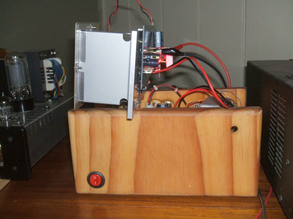

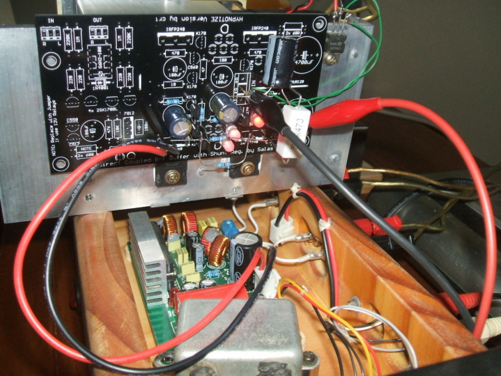

Hi Salas,
I followed your post #1 and it all turned out fine, except that I misread the instructions for the CCS, the value calculated is for each individual resistor in the pair, not the total resistance in parallel, not to worry. I fitted a 5W 0.47R in that spot for now which gives about 1.7A for the CCS, a bit low, but I was a bit worried about how good the heatsink is. I might go for more current after I let it all burn in a bit. So far the heatsink is doing well and I can keep my hand on it, despite being a hot 33C (93F) day. Something I forgot was the 4700uF cap at the DC power input end, doh. I have some at work, and at home only 16V rated caps, so had to make do with just 1000uF on the Hypno, and the T-amp has 4700uF 16V on board, (which maybe is now redundant?).
So despite being unfinished and incomplete at this stage, how does it sound? At first it was mediocre, but after 4 or 5 hours it was a different story. Compared to the switch-mode supply I was using, which I thought was pretty good, well this one as it is now, hardly broken in and unfinished, is a definite cut above the other one. The vocals are less "in your face", there is a mellow character but also greater detail, lots more detail! The amp seems to sound a bit louder for the same volume setting on the same track. The sound is fuller or deeper, or maybe better balanced is the right word. The characteristics are similar in many ways to the proto Hypno I built. Lots of detail with no sharp edges, and a very clean sound, as if background noise has been eliminated. I've been running it about 8 hours now and its still improving.
I did try powering the amp straight from the DC bench power supply to see how much current this T-amp draws at normal listening levels. From the analogue current meter, it never hits 200mA, just flicks up a bit towards 200mA for heavy bass for example. The amp is rated around 15W/channel into 4 ohms and I use 4 ohm speakers. With 80 to 90% amplifier efficiency I guess I'm barely using a watt per channel at normal listening levels. I'm just mentioning this in case it has any bearing on the operation of this shunt reg in this type of duty.
Some pics, it won't look like this when finished, I promise! It's rough, and still more things to be finalised. Its easy to swap power supplies for AB testing, takes about 20 seconds, just swap the white connector. BTW the Hypno PCB is a joy to work with, very nice indeed. Sorry for long post
