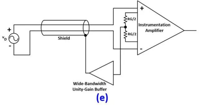

Covered in Horowitz and Hill... The inner shield is driven from a unity voltage buffer so it is kept at the same potential as the inner signal wire, so no capacitive loading occurs (at low frequencies at least - doesn't work with RF). Just another application of voltage bootstrapping. Was commonly used for very high impedance AC signals like EEG and ECG - these days we often just use a head-amplifier at the sensor itself so the signal is already buffered before the cable - after all a SOT23-5 FET opamp is way cheaper than special cable.I've just come across this concept and haven't seen any discussion of it or the theory involved. Apparently you "drive" the inner shield (somehow) to keep it at the same impedance as the source thereby eliminating any leakage current or capacitance seen by the source.

The voltage at the middle of RG in an instrumentation amp is the common-mode voltage of the input. Drive the driven shield with that to reduce the leakage from the signal pair to the shield. As pointed out above "instrumentation amp with driven shield" would be a good search term. "Guard ring" would be another good search term. The driven shield is basically an extension of a guard ring.

There is no signal pair, as it is no balanced cable. Just one centre conductor with two concentric shields around it.

Oh, true. A Triax would be a single conductor with two shields (one of which is driven). I was responding to Post #4 which shows a signal pair.

Definitely effective with single ended signals - in fact it can't work for differential signals unless each signal wire is individually guarded. The circuit in #4 doesn't make sense to me as it bootstraps only the common-mode signal, which is then ignored by the instrumentation amp!
If he stray capacitance of the input cables differ than this degrades the CMRR of the instrumentation amplifier. The driven shield ameliorates the problem.
