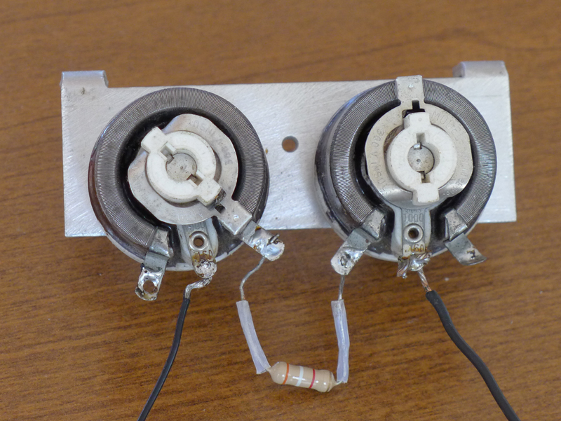

Exactly: you don't want to be casual with high voltages or cheap low wattage pots. That's why my pots are mounted to a small panel that screws onto the chassis, usually where the bottom panel would be screwed on. The panel is secure, the shafts facing me, and I can attach a meter to the terminals. Having several volt meters on clip leads saves a lot of probing into a live chassis.
