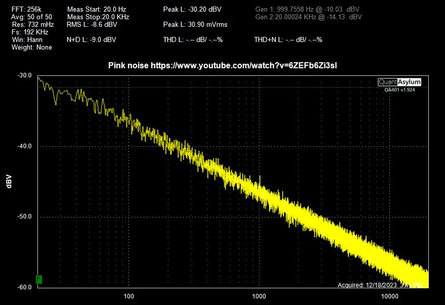

I'm gonna post a couple I've found and document why I think you can just use these instead of buying dedicated hardware. My postings here will all be taken thru an old 2 channel DAC I've got - not the latest by any means. This will not give you every signal imaginable but there are many.
Here's what seems like perfectly usable pink noise. The ten dB/decade slope is nice & tight all the way across.

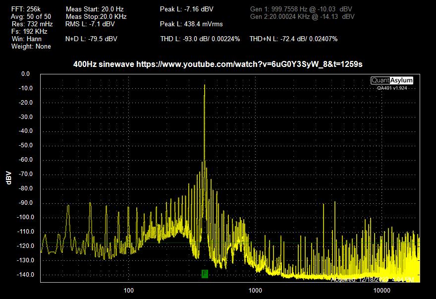

REW is for speakers. The 2 files I posted are great for, say, working on an analog tape deck.
What I'm saying is, properly vetted, there's plenty of "SOTA but 25 years ago" test signals on there.
I use that pink noise file all the time. But vetting is the key as many of the YT files are inaccurate.
