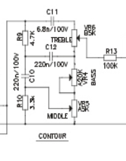

hi, its a pretty cheap chinese amp.It would help to see the plan of the amp it is going into.

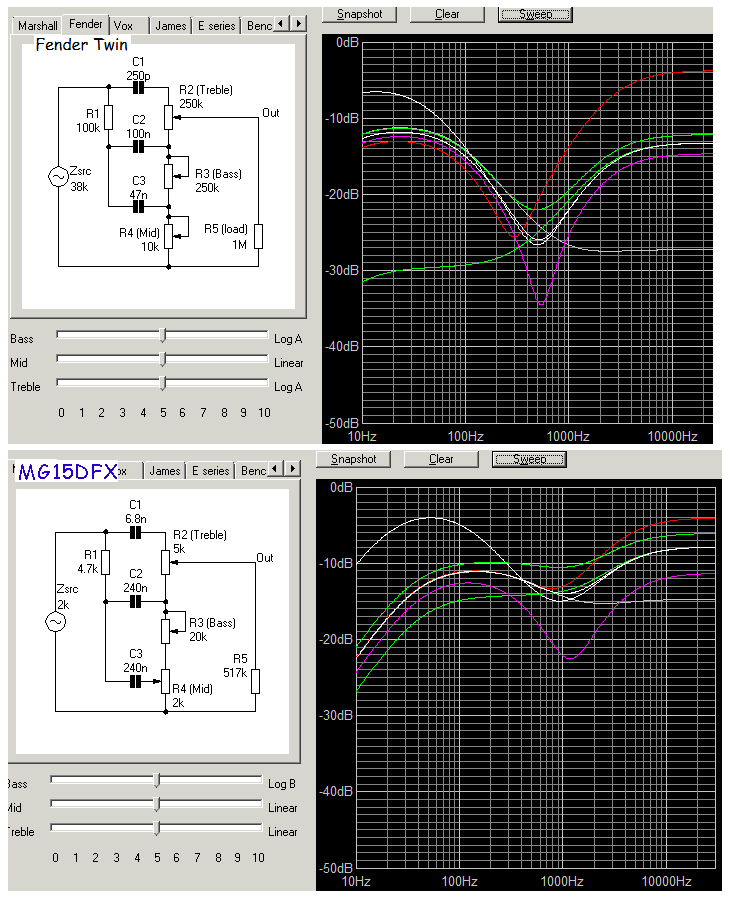

1st step: Reduce the band pass of the first opamp stage.
LT Spice shows the mg15 is (3dB) flat from 850 Hz to 100kHz. Nasty.
Make C4 a 1n cap and your -3dB band pass becomes 800Hz to only 12kHz. Still plenty for guitar work - could be reduced a lot more. Tune by ear.

Is that really 850 Hz, or is it perhaps 85 Hz?LT Spice shows the mg15 is (3dB) flat from 850 Hz to 100kHz. Nasty.
Guitar low "E" is between 82 and 83 Hz.
850 Hz is between 16th-fret G# and 17th fret "A" on the thinnest string, i.e., the vast majority of all notes playable on the guitar have fundamental frequencies below 850 Hz.
If bass cut off is really 850 Hz, the sound will be thin in the extreme, severely lacking all bass and body.
It is possible, though: I believe the Roland micro-cube is equally bad, with a lower cutoff frequency somewhere up around 1 kHz (!), higher than virtually every playable note on a normal 21 or 22 fret guitar in standard tuning!
I agree. Somewhat to my shock, I am having a hard time finding any good musical reason for more than 6 kHz bandwidth from any electric guitar, including electro-acoustics. Only unpleasantly harsh sounds seem to live up there....your -3dB band pass becomes 800Hz to only 12kHz. Still plenty for guitar work - could be reduced a lot more.
-Gnobuddy
That is 850Hz according to LT Spice. 80Hz is 13dB down from 850Hz. Yes...nasty. Maybe ok for the OD part of the circuit but no bass or body when clean. Currently putting the rest of the circuit into the model.
Yikes! 😱That is 850Hz according to LT Spice. 80Hz is 13dB down from 850Hz. Yes...nasty.
Thanks for doing the simulation!
-Gnobuddy

Increase C7 to 1uF for a 6dB increase on your Clean Channel bottom E.
Decrease C5 to 0.47uF so the extra bass is kept out of your OD channel.
C4 could be between 1n and 10n.
I suspect that these mods will also make the existing tone stack sound more responsive. (All suggested values came from LT spice sims.)

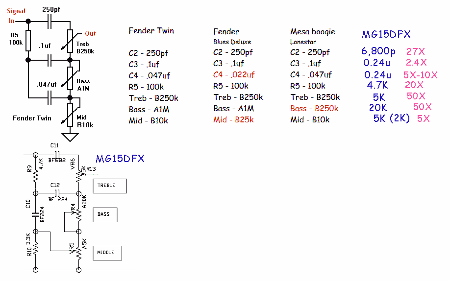

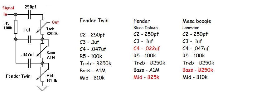

That amp HAS a "Fender Twin tonestack" IN it.
Except all the values are different, and not all the same ratio. (If it was same-ratio the response would be unchanged.) And a minor difference in how the MID pot comes in, which only matters at extreme. The result does not look "wrong".
I'm not sure if djgibson's 850Hz is a mis-reading of those cap values, or may be real. Some of those caps do seem awful shy, but I hate that notation and the sloppy labeling. 13dB down at 85Hz is heavy bass-shave but *may* be appropriate for a small g-amp working with a bass player. (Don't compete for boom; sing higher than the bass.) It won't be impressive playing alone.
