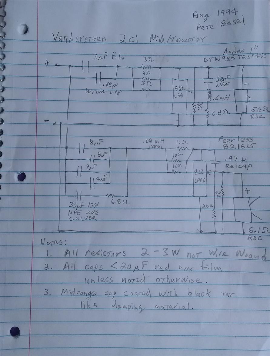

I reverse engineered the Vandersteen 2Ci back in 1994 and am posting the crossover
schematics here in order to help others that have problems with burnt out resistors and
for general educational purposes. I never intended to post these in public and never
redrew them with CAD tools. I chose to show how component values were built up from
smaller values, obviously it can be redrawn with some simplifications.

First is the mid/tweeter crossover, it can be seen to be a simple 1st order cap to the
tweeter, one ohm fixed resistor pad, an Lpad, a shunt 20 ohm fixed R, and an RLC
with a resonance at 918 Hz - very basic.
The mid also has basic HP and LP first order filters with an Lpad and some shunt
resistance to flatten the driver impedance.

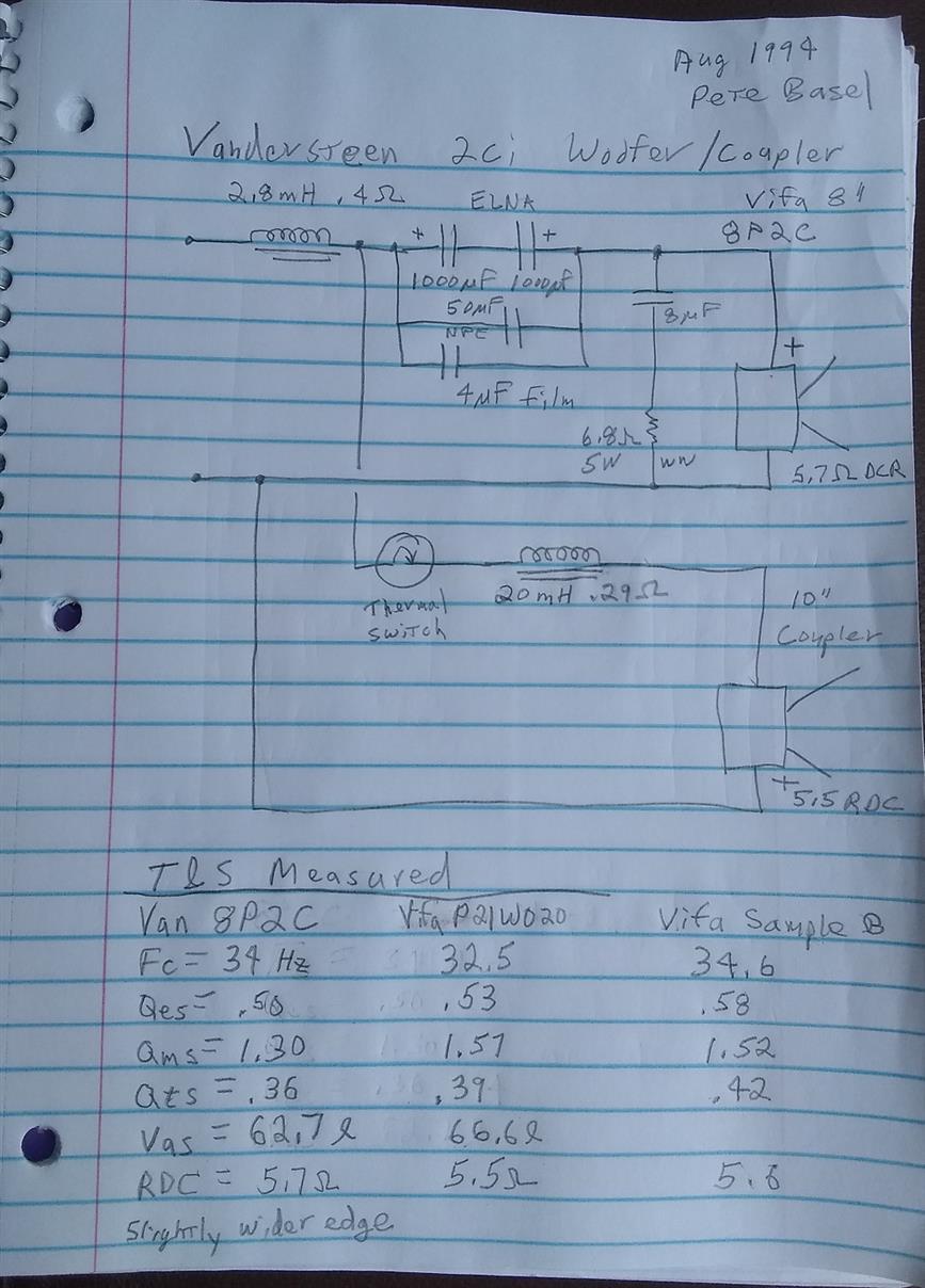

Second is the woofer/coupler crossover with a 2.8 mH inductor providing some baffle
step and a total of 554uF HP to the main 8" woofer and a huge 20 mH inductor to the
10" acoustic coupler (AC) assist. They share a common air cavity with the AC coupled
like a passive radiator but with drive to boost the output. Keele, in his Audio Review
confirmed this by disconnecting the AC and noting the change in output level around
Fb, the box AC resonance. That was 38 Hz from memory and the boost was something
like 3 or 5 dB - I have to look it up to confirm. The AC has a thermal switch in series
that trips at about 5 minutes into a bass heavy track played at a level that I like, it is
also close to the displacement limit of the main woofer. Some say that the switch
doesn't age well and the trip point lowers and suggest removing them. Note that in
the next post the picture of the woofer inductor has the number 3 on it and I seem to
remember it being 3 mH. I'm not sure why my notes have 2.8 mH instead.

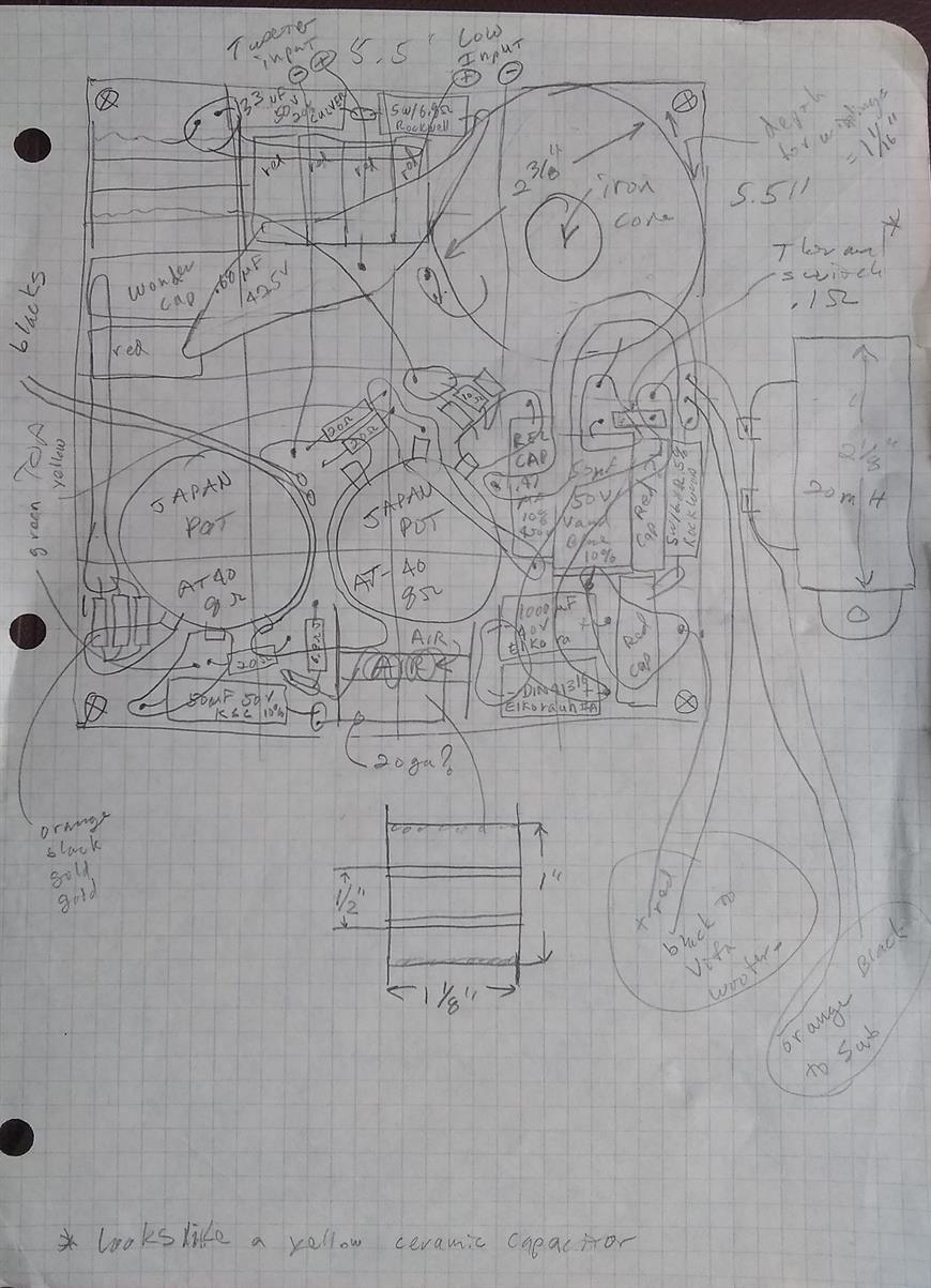

Third is a pictorial layout of the double sided circuit board which is glued in and very
difficult to remove so I didn't. I used an ohm meter to confirm how the traces are
connected.
Fourth is a side view where I measured the driver offsets in order to enter them into
CALSOD, the program I used to model the system.

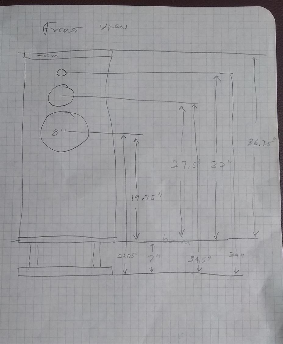

Fifth is a front view providing the height positions of each driver also for use in the
CALSOD program.

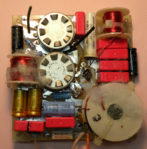

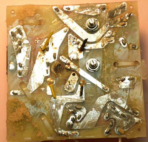

Here are front and back pictures of Vandersteen 2Ce crossovers, different model, that were
posted here. The board and components look exactly like mine from what I remember,
note the burn mark on the back as a result of the resistors overheating:

Later in the review Keele does an experiment where he disconnects the Acoustic Coupler
on the rear and vector sums the outputs from the two woofers. He finds that the Acoustic
Coupler drive boosts the output at box tuning of 38 Hz by 5 dB. This is very similar to a
B6 alignment where a peaked high pass provides 6 dB of boost. The -3dB frequency of the
woofer system is lowered from 51 to 43 Hz.

It is clear that they do not want you driving this system very hard, the 10 ohm resistors in
the midrange path are only 2W and there are reports of them burning out. RV knows he
can up the wattage on those but I think that they are a way for him to know when a system
has been over powered. He asks customers to return them in such cases which is going to
be very costly just for shipping.

It is a 10" stamped frame woofer in the same box, so acoustically coupled, to the 8" woofer
in the same way as a passive radiator. It is weighted like a PR and resonates with the box
volume. They drive it such that it provides about 5dB of boost over a passive radiator.
