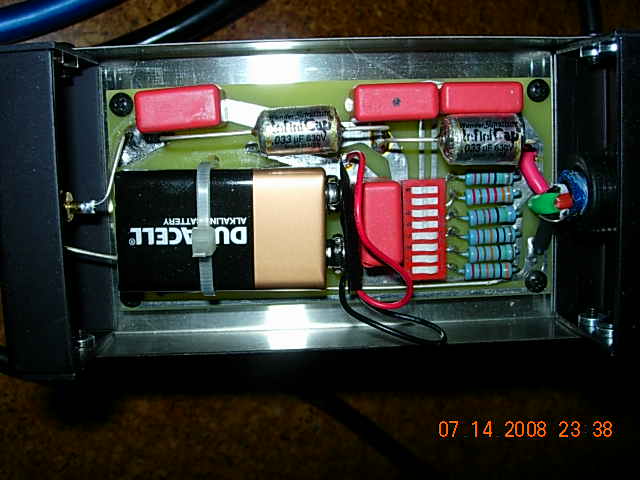

The crossover is the M5-HP crossover, same as the model 5.
Prefer feedback before I do a parts swap.

Take a picture and post it. Picture is worth a thousand words, plus I am curious to see another hi end loudspeakers crossover full of 5c parts.
sdclc126 said:Oh it's an active XO - thanks for saying so. Don't touch it.
what's so active about that? perhaps it's just "biased" with the battery.
Either way it would have helped. "Upgrade" would be to replace worn out parts - still no science behind more expensive of the same stuff.

OK, you can go home now. Not sure that you have done any work, other than to explain how "science" fails to corroborate differences between capacitors... (actually, there are hard measurable numbers to describe the differences in performance, even between similar film caps. How that relates to what we hear is a bit tougher to quantify.
Now, let's roll up our sleeves:
First of all, that 9V battery is indeed a "bias" battery. It keeps the caps "formed" by biasing them up by 9V. This is not an active XO.
Second of all, this is NOT the speaker crossover. This is a 100Hz high-pass filter that does its work at line-level.
I'm not sure I would expect really big changes by swapping out caps in here. The InfiniCaps are quite good, not the $0.05 parts our skeptic friends were hoping for - these are something like $15 retail. At double that price I would recommend Mundorf Silver/Oil caps, but they are large and you may have a tough time fitting them in. You could bypass the Wimas with silver Mica for not a lot of money or time involved.

Yup HP filter and a PITA to roll amps into my system.
I have K40 and Gudeman caps of the same value to swap for the infini and wima caps. I figure someone must have tried a parts change, for better or worse.
Those InfiCaps look like polystyrene. Are they? I like polystyrene caps - they just don't come in large values.
Maybe the red Wimas could be replaced....

A biased capacitor line level crossover ..... 100Hz high pass allegedly.
What is it adjustable for ? levels, frequency or both ?
(edit : Its input impedance matching for the correct frequency....)
$600 a pair ? Hmmm...... and you want to upgrade the components ....
Looks a trifle complicated when this can be achieved by the
input coupling capacitor of most power amplifiers quite easily.
FWIW the capacitors appear to be paralled film types, and you
do not get much better than the large (not value) polystyrenes.

I am not prepared to argue the point, they seem to be flawed.
I would set about trying to adjust this, cannot do any real harm.

Active/passive/line level - doesn't matter - design is more important than components in audible performance differences.
"OK, you can go home now. Not sure that you have done any work, other than to explain how "science" fails to corroborate differences between capacitors... (actually, there are hard measurable numbers to describe the differences in performance, even between similar film caps. How that relates to what we hear is a bit tougher to quantify."
Yup - thanks for helping me make my point.
"First of all, that 9V battery is indeed a "bias" battery. It keeps the caps "formed" by biasing them up by 9V. This is not an active XO."
Doesn't matter - it's still a filter/XO and expensive components won't make any audible difference.
"Second of all, this is NOT the speaker crossover. This is a 100Hz high-pass filter that does its work at line-level."
See response above.
"I'm not sure I would expect really big changes by swapping out caps in here."
Sounds like we're on the same page here.
