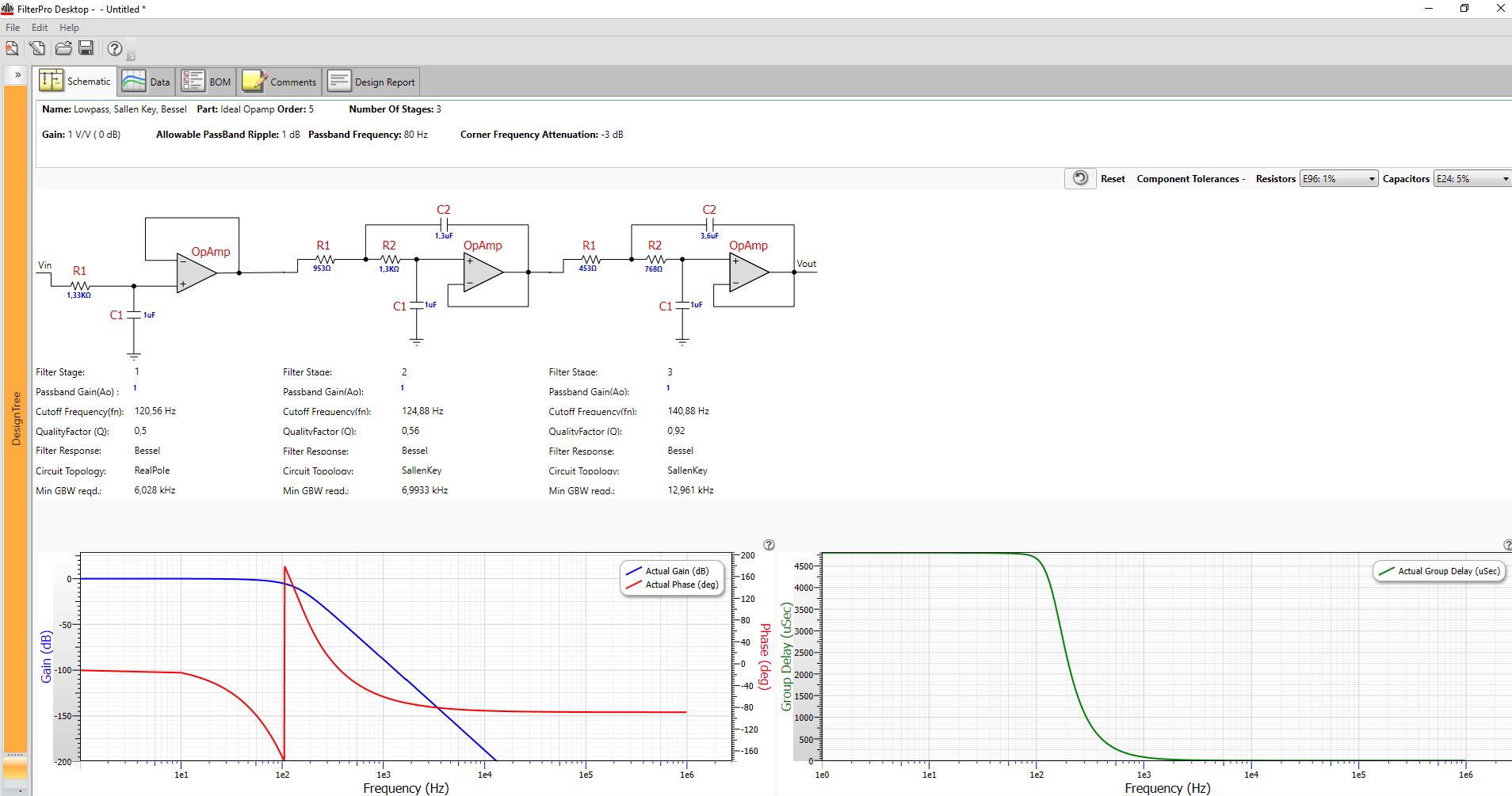

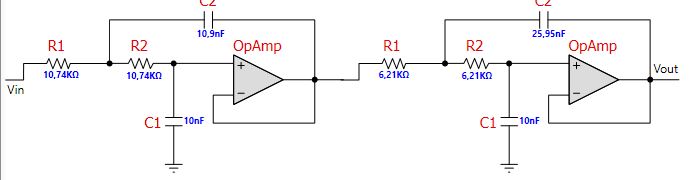

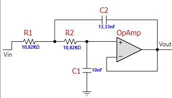

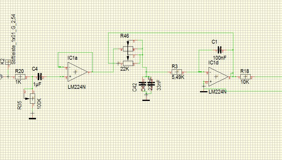

Don't know, if i got the point, but to chance the cut-off-frequency you need a 2way-pot like in the first pic. chancing the slope with the same ops? the second and third pic shows a 12db and a 24db 1000hz-filter...you have to use more switches and difficulties than useful. it's easier to built 2 crossovers with one switch...

why so steep? "normal" is a 2nd grade filter at 80hz...high grade analogue filters struggle with complexity, noise and bad group-delays. dsp are in a better position to handle this...
