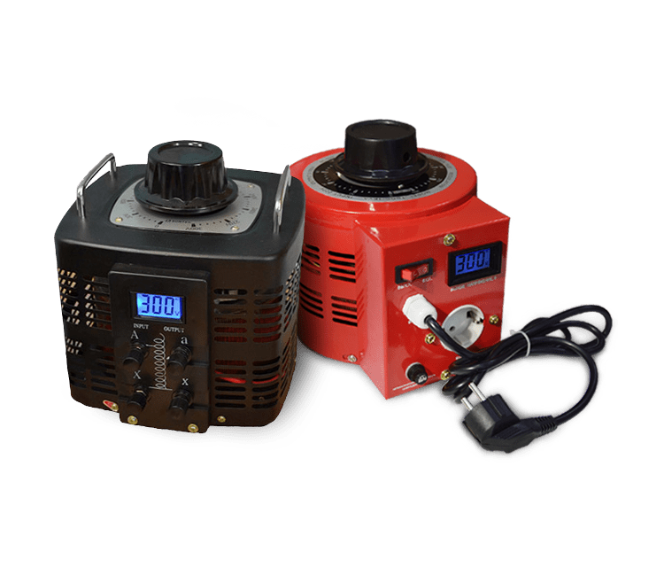

Variac transformers SUNTEK 0-300 Volt
The accuracy of the input voltage for your audio equipment can simply be set using a variac transformer. They are on 2,4,8,12,20, etc. ampere. How to choose the right one. The calculation is as follows: let's say your equipment is 500 watts and you are going to use it at a voltage of 100 volts. The choice of the correct variac model is determined by the current consumed. We divide the power by the voltage, we get the current, in our case it is 5A. Thus, the nearest model variak 8A will be the solution.

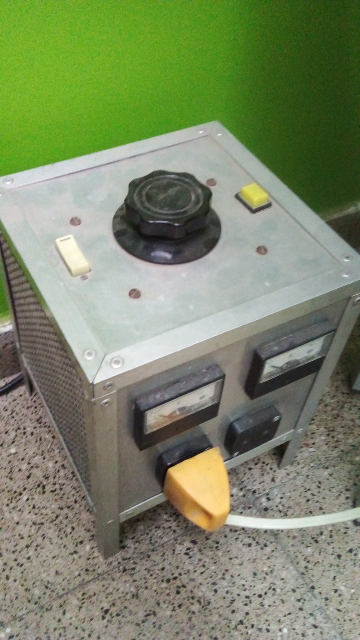

I know very well Variacs. I rewound the one inside this home made box. It was blown in 3 parts so I re-made it completely some decades ago.
The only issue is that I take the tap for 220V imput wrongly, so the knob operates increasing voltage counterclockise. It's not an issue becase I only use it.
Continue your business and my apologies by my meddling.
