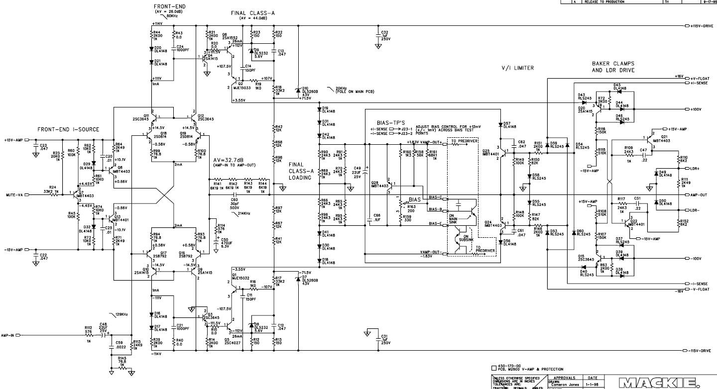

I success design class H amplifier with 120VDC power supply (Schematic from me and layout PCB by my friend). My friend ask me to design class H amplifier with 180VDC and use 3 step of stepper.
Can you suggest me a VAS (Voltage Amplification Stage) transistor which have max. VCEO 400V and low Cob?

That is quite hard to find. Crest Audio Used MJE13007/MJE5852 in their high power amplifier.

Reconsider not using SMD parts. You will have a tough time trying to find suitable parts in TO-126 now. Use a cascode arrangement for best results.
You’re going to be stuck either using a cascode or a darlington. Won’t find anything with the low Cob typically needed for high performance AND enough SOA to handle the currents you need (peaks of 20-ish mA). C2752/A1156 are suitable as the darlington *drivers* for MJE18004/MJE5852. A little wimpy for a VAS stand alone. The MJE’s are too big.
Creat did use the MJE’s as VAS in their earlier models. They have abandoned the conventional Lin topology in their Pro 200 series for something that looks Ike the QSC PLX. No transistor ever sees the full 320 volt rail to rail voltage swing - the penalty being an output stage with gain. That has a bit more commutation distortiion than a unity gain output stage, but perhaps more reliable. And relieves the conundrum of finding a VAS transistor with 2 pF Cob, 400 Vceo, Hfe of 200, and 50 mA of SOA at 300V.

Thank you for your suggestion. I will try to sim output as CFP and followed by emitter follower with gain. VAS use medium voltage.
Cascode VAS works well with high current BJTs. I simulated my amplifier with 2SC3503/2SA1381, and with MJE15032/MJE15033. Almost no difference in distortion...

Search Mackie amplifier schematic class H ( Mackie M2600 + Mackie M3000 + Mackie M4000 ) .

That would be one method. The Crest (and PLX) simply use commn emitter output stages. They also use op amp input sages, giving them a very high negative feedback factor, which helps keep commutation distortion down to inaudible levels with normal music signals.
The Pro9200 does lend itself to DIY quite well if you just use a conventional toroid power supply. The SMPS isn’t very DIY-friendly, but the amp is. You could also marry the amp section with any number of rail switch varieties - including more than 2 steps if you were so inclined.

Only problem with a cascode VAS is that it robs voltage swing. I just hate wasting 3.9 volts if I paid for them with iron and aluminum. If the higher performance matters more than the extra dissipation, go for it.

Agree. In audio pro, max. power is matter than sound quality. But in most case, I will choose quality over max. power.

I use the Marantz verision. It use LED for the cascode, which means only 2,5V loss. Compare it to the 180V psu. There are many solutions to keep the VAS rail higher...

You can see my VAS on the picture. Yes, this is not pro audio version, but not a big loss, if you use it. You will loose much more with the triple emitter follower output.
The common emitter output stage of Crest or even the QSC has much better efficiency...

I often use that cascode (Hawksford cascode), too.

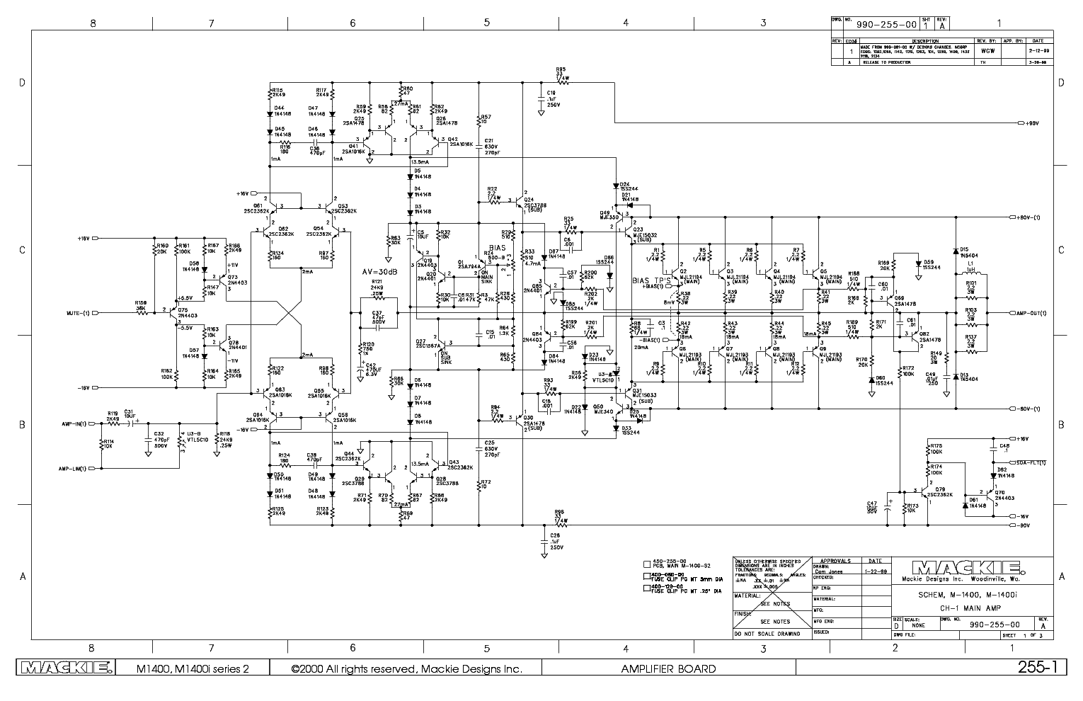

is there another scheme that is almost the same as this scheme?Search Mackie amplifier schematic class H ( Mackie M2600 + Mackie M3000 + Mackie M4000 ) .
KSA1381/KSC3503 are both 300V, 1.8pF and TO126. That would be about the limit; a 400V transistor would be rare, since video drivers have gone to the dodo.
In your cascode you can go down to 2.5V loss of headroom. That is acceptable.......
