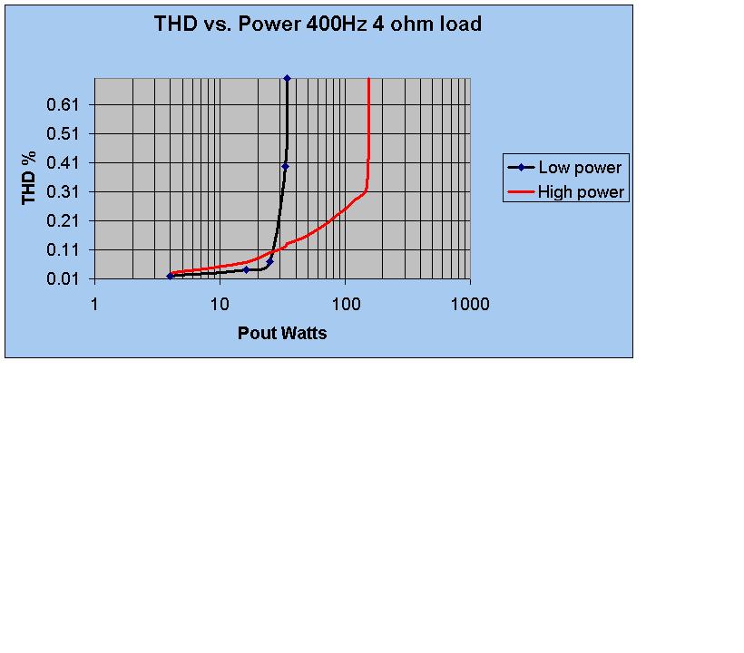

Ian# Gingertube,
Circuit dia of 30/ 150 watt power amp. Power supply uses Switchmode /PFC not shown.
Graph of thd 400Hz performance.
I can recommend this amp although the 7199 is getting on the rare list
The circuit is simple but amps of this class there is alot of safety watchdogs and warm up procedures thrown in.
Generalised;
s/n -70dB down full o/p
no measurable switchmode interference.
richj
