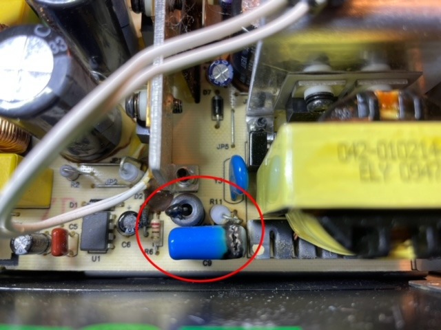

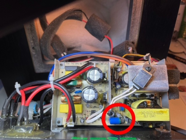

Condensator 9 sparks.
what is the capacity of it and with Voltage please.
Velodyne CHT 8QR BVE. 2010. Not used for many years.
Are there no visible markings if you bend the leads to lay the cap on its side?
It is quite likely very critical in both value and also specification and could be part of the 'tuning' circuit for the chopper transformer. Typically such caps have to withstand not just high voltages but also fast risetimes of the voltage.
