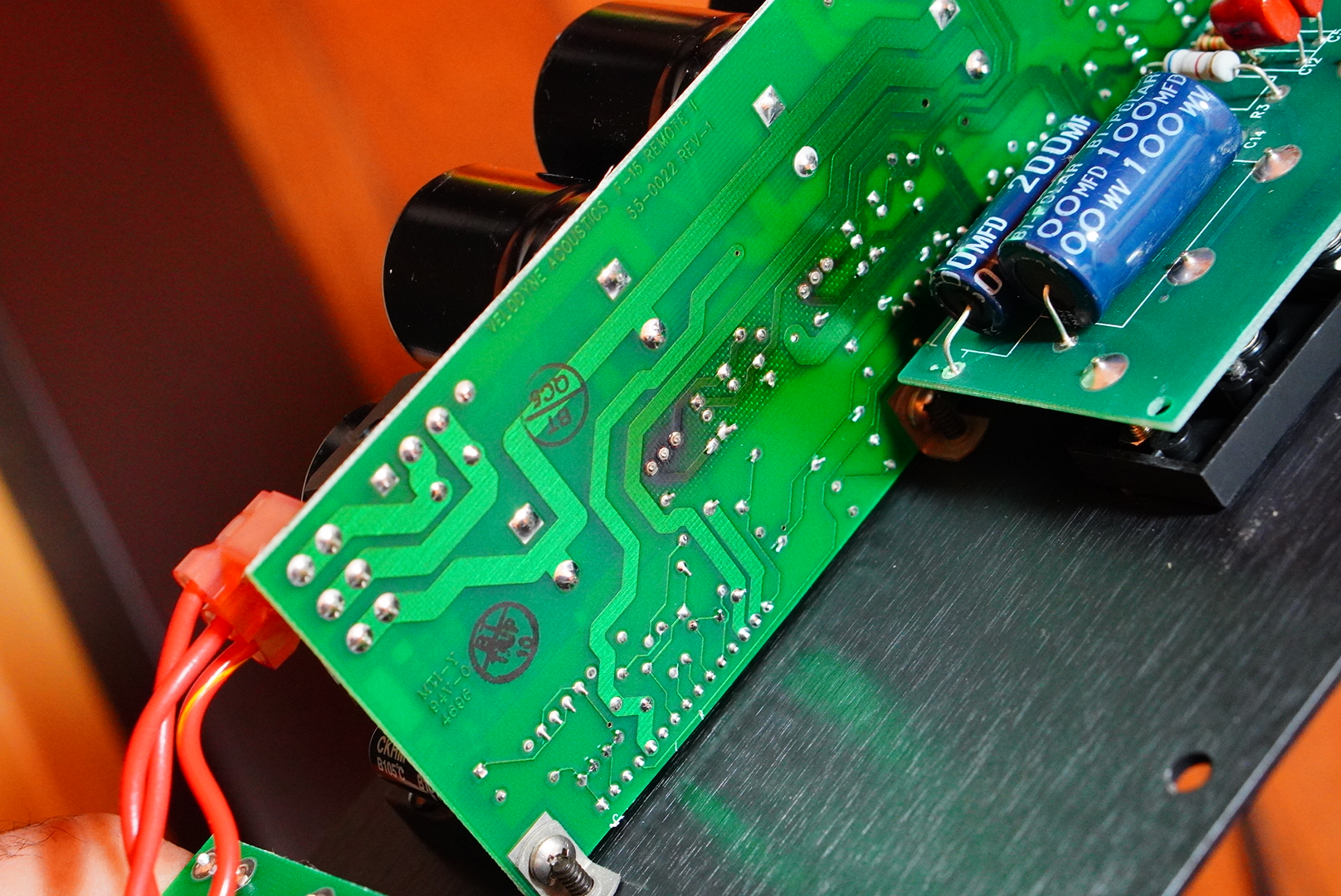

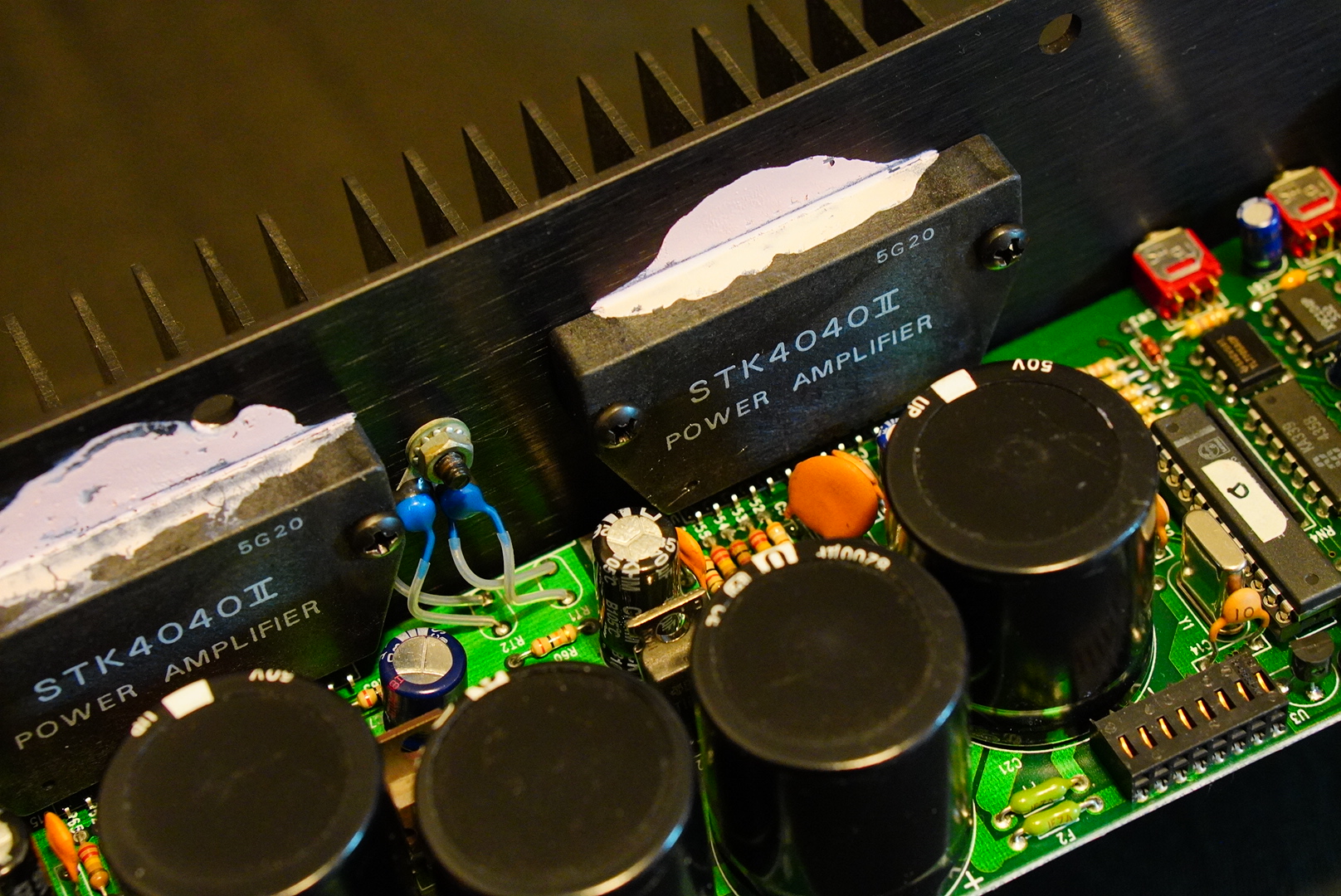

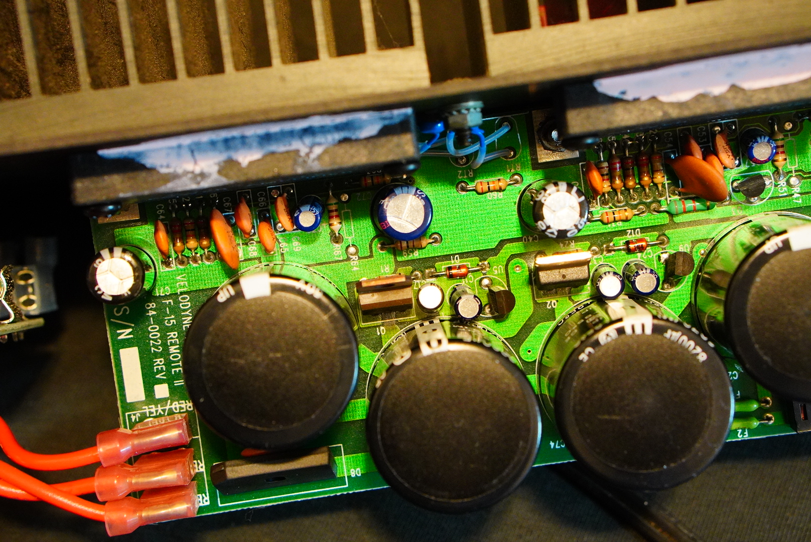

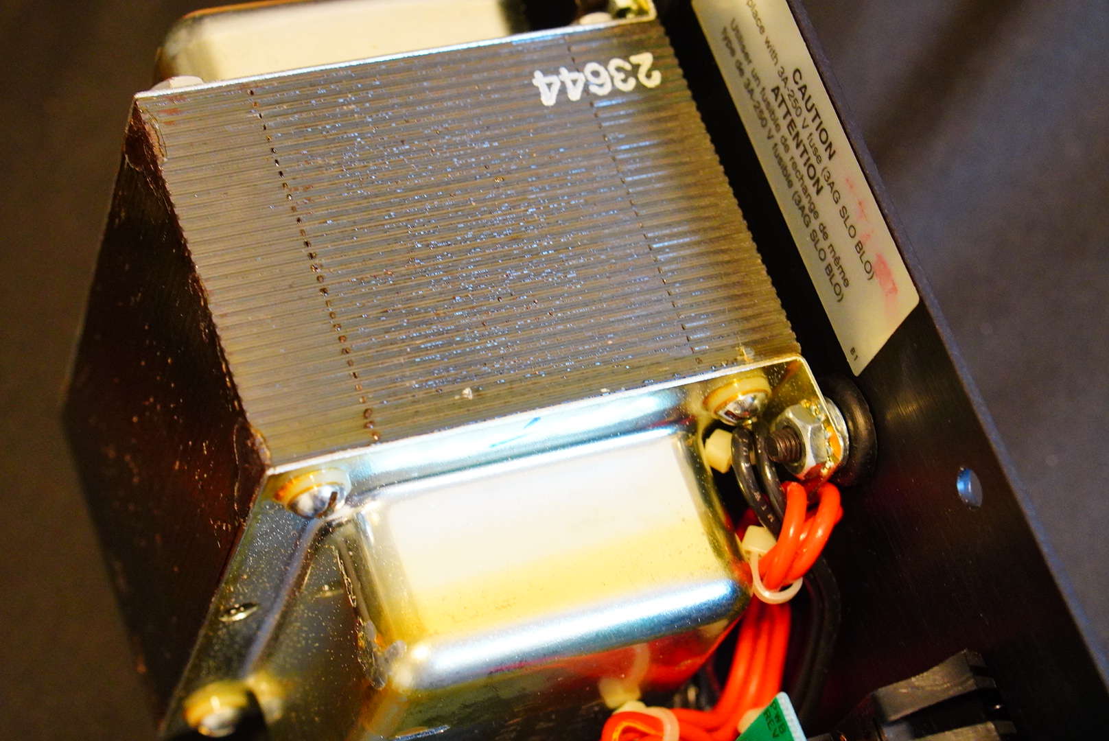

I removed the amp to source capacitors. Notice one transistor is running hot. See pics.
Velodyne customer service phone clerks get very combatative and almost wants to get into fist fight when you ask for service manuals. So I could not find service manual for this amp. But will call velodyne tomorrow to double check.
Attached are some pics.
Transistor that is running hot says "malasya TIP29C" it's labeled q1 on the board. Looks dull brown grey instead of black. It's connected to one of the filter caps
There is another transistor labeled q2, which looks different. Says "8823 TIP30B"

1) is it possible to say what could cause q1 transistor to run hot
2) do these all in one power amplifiers (stk4040ii ) go bad like capacitors. Are they wearable components

What's it using for a power supply?
One of those SMPS jobs?

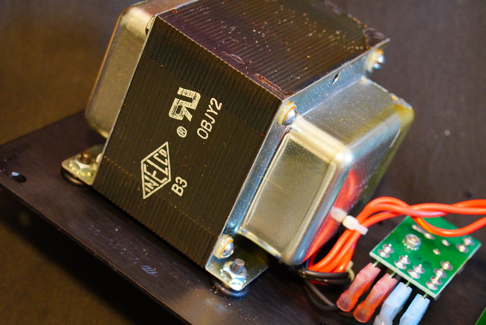

Inelco b3 transformer.
The shape of the amp is a little odd. Well the amp works. Sub is 22 years old.

Maybe a resistor r1 connected to q1 is not powerful enough?
My first suggestion would be to clean those charred/overheated areas of the PC board.
and all those overheated parts likely have compromised soldering now, which needs re-doing at least.
Those transistors may be weakened from overheating, new ones with a small heatsink fitted would be a good idea.
The diodes D!, D12, small transistors should also be checked, as well as the small caps in that overheated area.

I ordered original 29 and 30 from mouser. Will put some heat sinks.

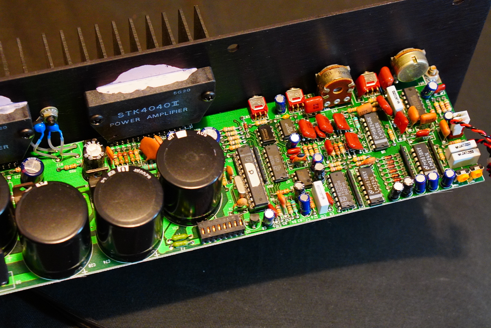

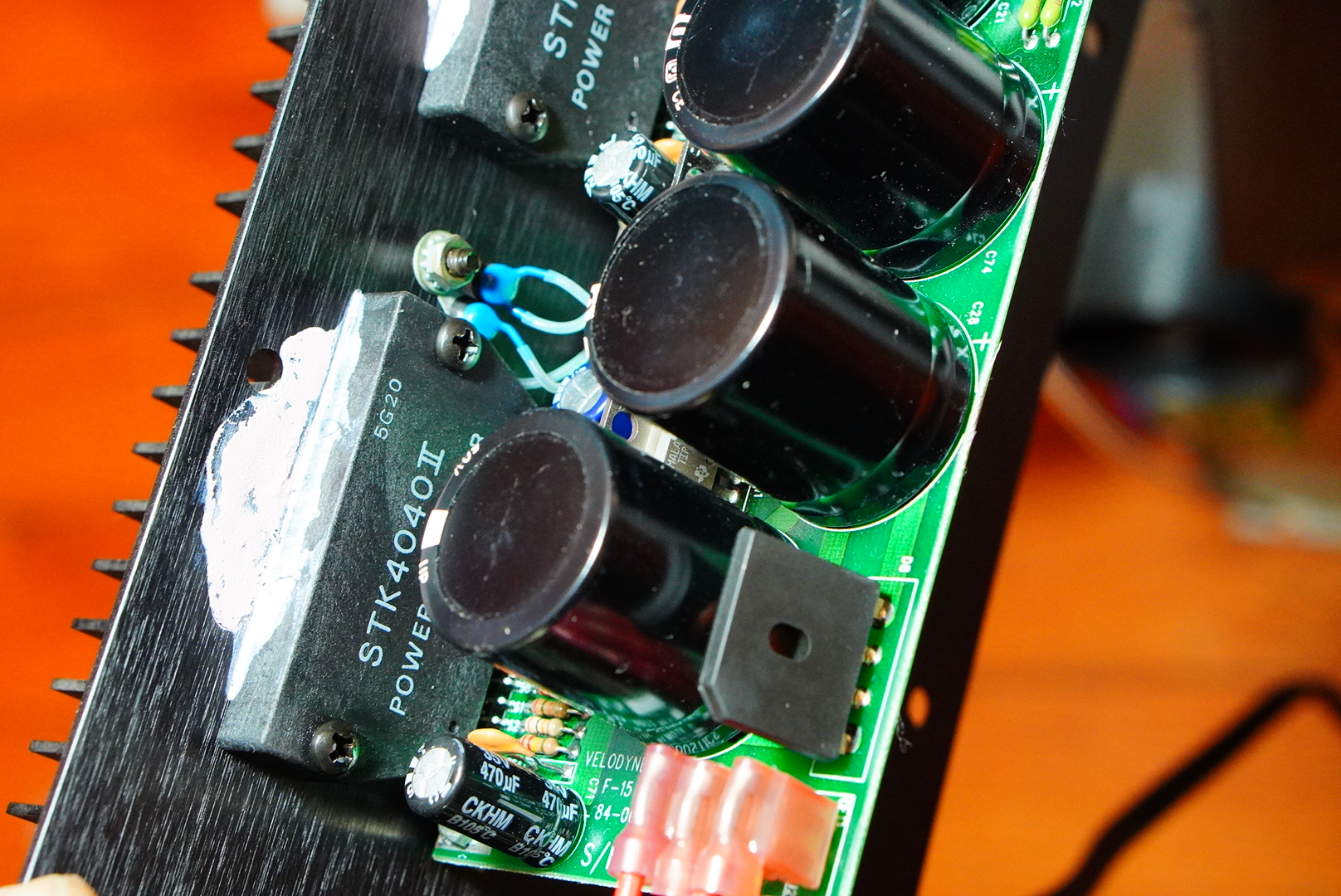

A friend of mine has one of these and we traced out a partial the schematic. To do a full one would require dismantling much of the circuitry as there are two or three daughter boards tightly grouped on the main board.
The chip is under-rated for the power claim for the unit - at least for that you can pull up info on the web and see typical application circuits. I was surprised that the built-in crossover is a simple 6dB slope. His problem was with the signal detection for auto-on/off turning the amp off during quiest parts of the music, then turning it back on with a definite 'click'. This is done through the current source for the diff-input of the STK but we could not trace that part of the circuitry.
Most problems with Velodynes come down to the accelerometer (piezo element) becoming detached from the cone, or the cable to it breaking. Some have two wires and some four. The circuitry related to this is not disclosed.
