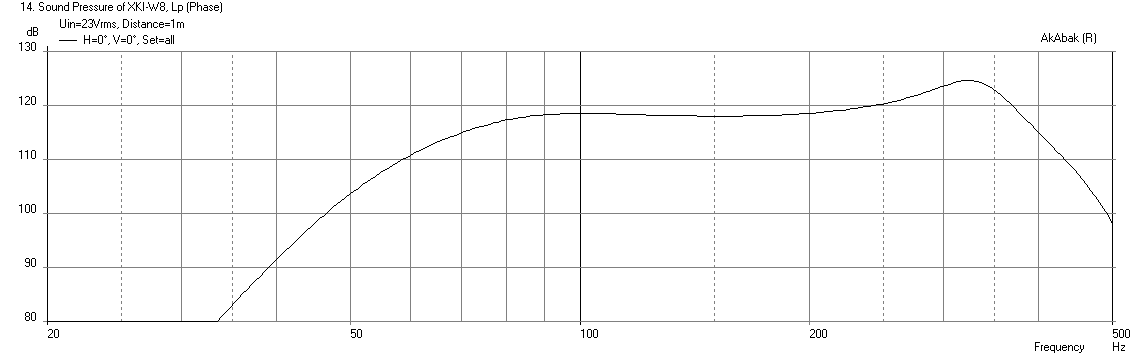

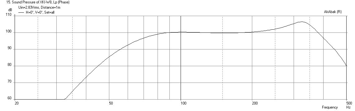

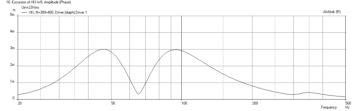

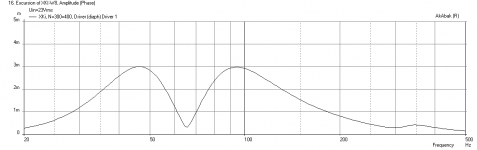

Dual 10in drivers in XKi works well
Freddi has a good suggestion for an XKi for this purpose. I agree that tuning this to maximize 80Hz and limit excursion is the way to go. I used the Vas spec to size this at 46 liters for both drivers and this will tune it a bit higher for more output and less cone movement. With a 12in wide cabinet and qnty 2 x 12in wide x 1in deep x 9.0in long vents, make the front chamber a "V" with a vertex in the middle so that 20% of the box volume is in the front chamber and 80% is in the rear chamber. Wire the drivers in parallel and here is the predicted SPL vs frequency for 2.83v input. It is 100dB sensitive with 03dB at 72Hz. This will play the 80Hz notes very clearly and loud. Ignore the falloff above 300Hz as this model is for the bass response only (I do not have the direct radiation from the cone passing through the aperture captured here):
Here is the cone excursion at 23vrms input, use a 51Hz high pass filter:
Here is the max SPL at 23vrms - about 118dB at 1m, not too shabby:
XKi - X's ab initio Karlson 6th Order Bandpass

It is actually a pretty compact cabinet. If you want deeper extension, say to 40Hz, that is a challenge as the fs is 54Hz. It can be done but overall SPL will be very limited, and cabinet will be double the volume.
