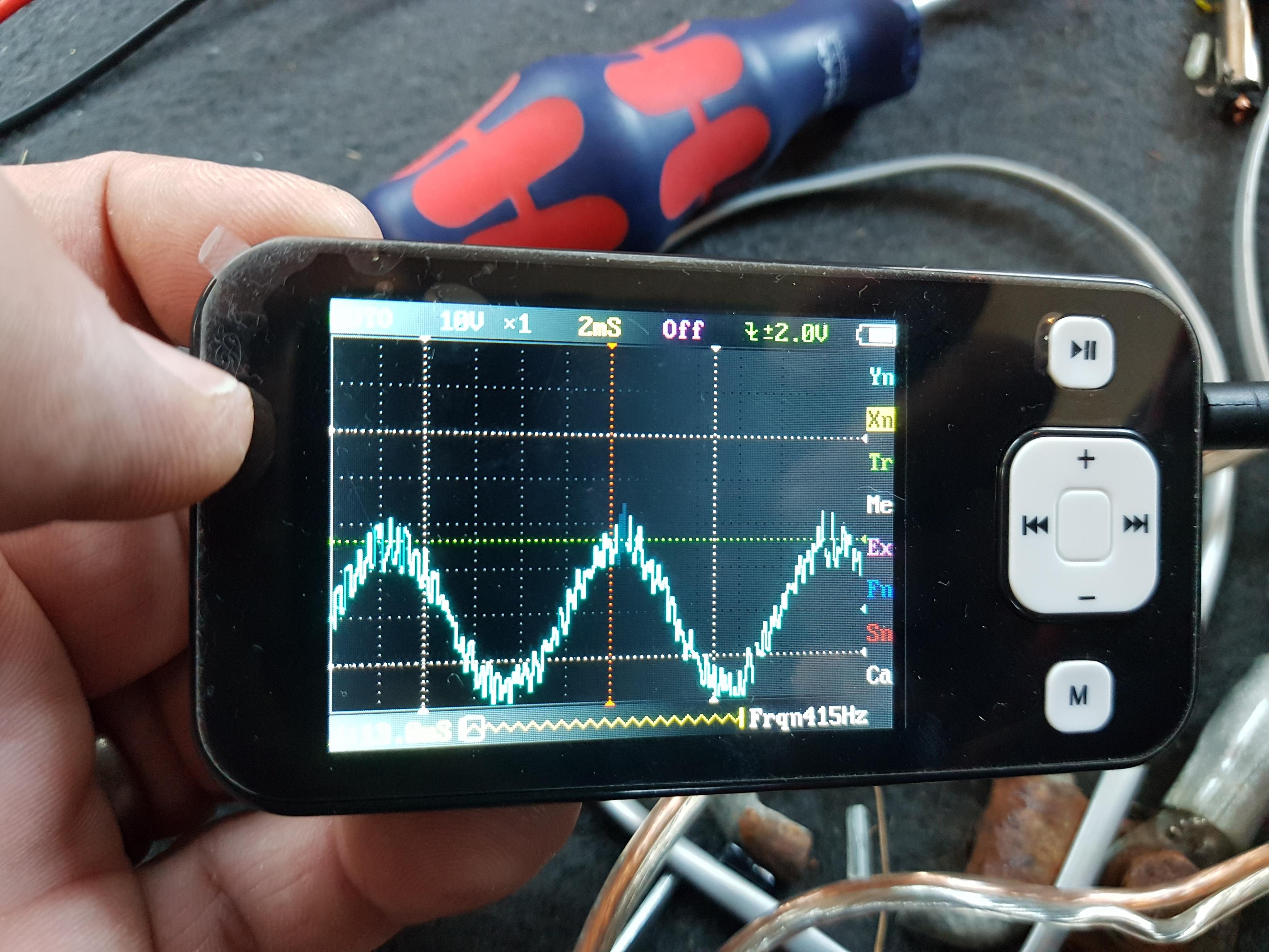

Ive Just replaced one of my car amps, an old Phoenix Gold XS2500 with a tiny Kenwood X301-4 Class D. I hooked up the scope and was surprised to see a complete mess, has anyone seen a sine wave like this before? The funny thing is I cant here any distortion, I know my ears are old but wouldnt I hear such a bad signal? Obviously Ive tested the same RCA's before connection and Ive also tested them on another XS2500 and the signal is sweet. Oh and just a heads up, this amp has the worst potentiometers I have ever had the misfortune to come across, they have drove me mad, they seem ok upto about 15v then in the tiniest increment the amp is off doing 75-100v, Iv settled on a lower number than i wanted and the channels are 2.5v out, would love to here if anyone has had similar grief.

Does the amp have a DC offset pot?
Are all channels offset by the same amount?
Dis you measure the DC directly across the 2 speaker terminals for each channel?
What was the vertical amplifier setting for the scope?
What does it look line at 10v/div?

Thanks for the quick reply Perry!

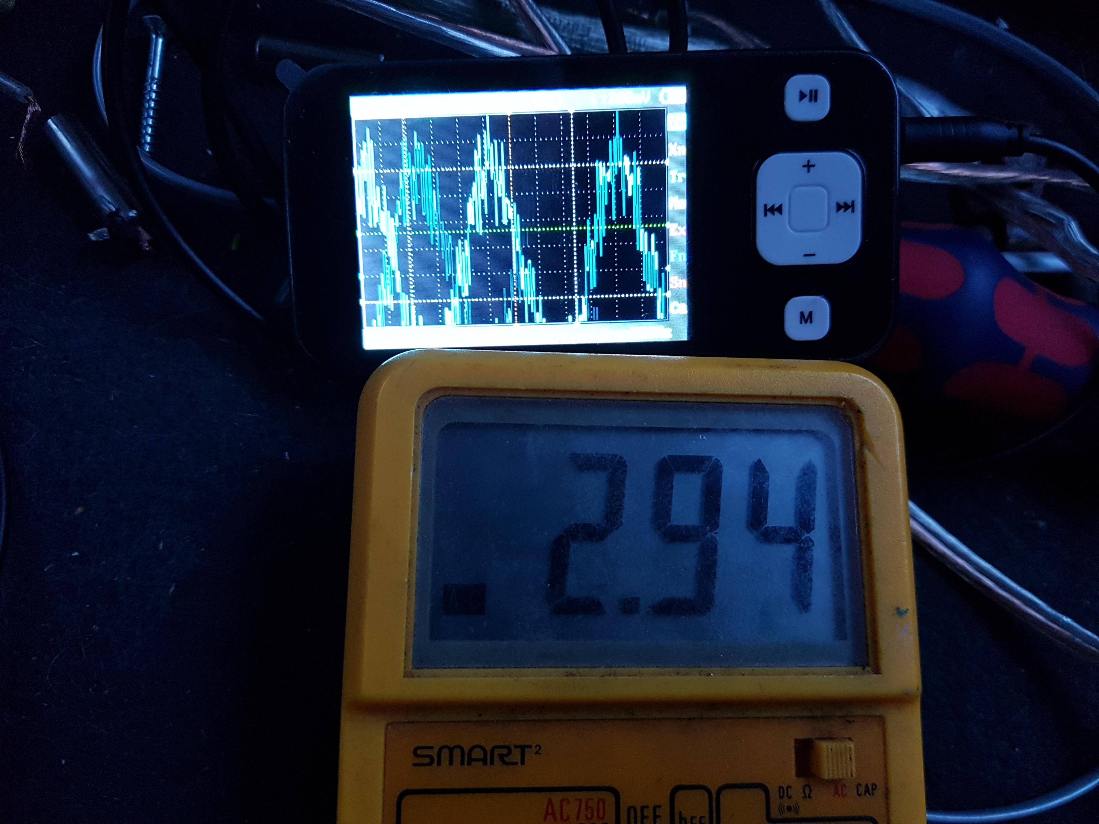

No there is no DC offset pot, not externally anyway, I havnt actually tried to measured DC on its outputs, I didnt realise it was relevant, I kind of just get by with this stuff. 😱 The voltage in the picture is AC measured directly across the amp terminals, I am measuring the amp bridged so basically as it would be connected to my speakers and i tried both A and B amps, (the kenwood has 2x stereo amps they have named A and B.) I will measure again and let you know what settings I used on the scope, They will be different now as ive increased the input sense for about 18v output.
I misunderstood. I took the 2.4 AC as 2.5v DC offset.
The output of many of the full range class D amps are awful, if you look at them with a scope. At low vertical amp settings, they look really bad. I generally look at them at about 10v/div with about a 20v output to judge them.

To clarify...
The scope will be set at 5-10v/div. Try both.
The timebase will be set to 2ms or whatever gives you about 3-4 cycles of the input waveform on the scope.
The amp will be driven with a sine wave of about 50-100Hz.
The input signal level (volume) will be great enough so that the amp produces about 20v AC at the speaker terminals.
The 20v has nothing to do with the gain control.

Thanks Perry, its pretty much the same, the only difference here is i have set the signal level to 16v using the head unit, close as i could get using the stepped control, it goes way over on the next notch which is strange because its not like i can here a massive change listening to music. I am setting the gain on the amp for roughly 100w at a specific setting on the head unit, tested to be clip free, so this is why im using the Input Sens (GAIN) on the amp. The end result is the same, 20v at the speakers for a setting of the number 30 on my head unit. I ran 100Hz.
With some class d amps there is residual carrier on the output.
It depends on the carrier frequency and output filter components as to how much.

Thanks Nigel, I've sent my findings off to Kenwood, if they say the scope is normal then I may just send it back anyway, I've got another class d coming this week for the sub so will see how that reads too.
The carrier frequency looks to be very low but it could be just how your scope is displaying it. Many of the less expensive scopes can't capture the high frequency waveforms as they are. That may also explain why the carrier residual is so irregular.
In many of the full range class D amps that I've worked on, the amplitude of the residual is similar but at a timebase of 2ms, the frequency is so high that it simply makes the trace look wide/blurry, not jagged.

My class d amps have always had a little residual carrier too.
I would be inclined to measure the frequency of the carrier to make sure it is correct.
The OP says he cant hear the carrier so its probably OK.
Thanks guys, it is a cheap scope, never had to doubt it with my previous car amps, I guess this is just how class D is then.
The specs are fudged a bit on most of the less expensive digital scopes. I was trying to find a cheap way to check the drive signals in class D amps. It requires a floating ground (or a differential input to the scope, which most people won't use). The DSO138 was supposed to be good to 200k... not even close. It wasn't even good enough to read the relatively low frequency of a power supply drive signal. The owon VDS1022i (<<< the 'I' is very important) was the cheapest option I could find. It would be awful as an 'only' scope for repair work but it has its uses.
Wow, yeah I'm a long way from that, im just setting the gains on a car audio system! What makes me doubt this new amp is that I've tried my scope on 2 very cheap hifi class d amps, and I mean cheap, we are talking £5 per mono PCB, my power supply is a cheap laptop job, I've had my new car amp apart and it looks really well built for the money.
