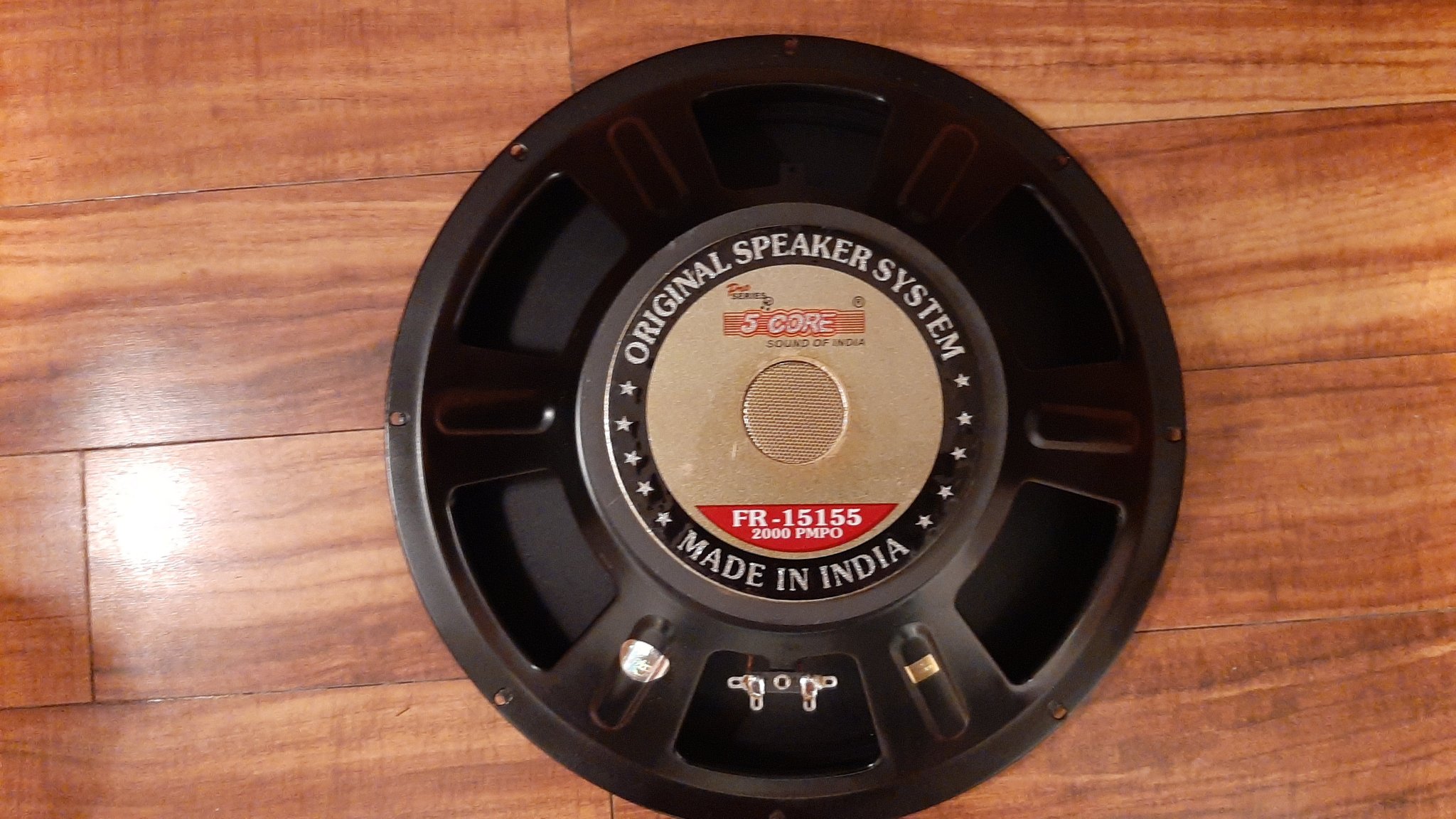

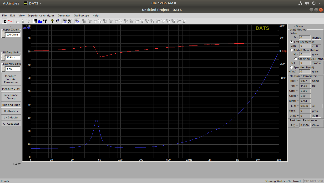

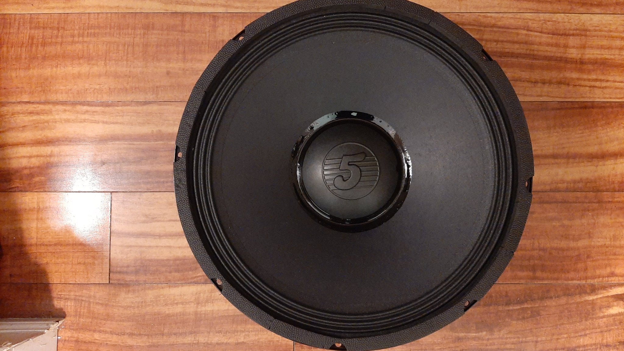

Run across some interesting woofers for open baffle use they are also very inexpensive. https://5core.com/products/pro-audi...b-woofer-loud-speaker-driver-full-range-8-ohm I actually run across these by accident. The QTS 1.29 the FS 44 HZ very close to the Eminence alpha 15" but these speakers have a 60 oz magnet vs the 25 oz magnet on the alpha's. These 5 core 15's are also available on eBay for $54.49 each free shipping $47.41 each free shipping if you buy four. Has anyone in the forum used these drivers for open baffle? Someone could build a pair using two of these per side for under $200.00 that is a steel. Hopefully I will have these mounted in a baffle and give them a listen soon. I have never heard open baffle speakers before hopefully these sound great.

The TS parameters are a useful start to figuring out whether a woofer will work for OB or not. The magnet weight has nothing to do with it. Also, you left out the most important parameter, Xmax.Run across some interesting woofers for open baffle use they are also very inexpensive. I actually run across these by accident. The QTS 1.29 the FS 44 HZ very close to the Eminence alpha 15" but these speakers have a 60 oz magnet vs the 25 oz magnet on the alpha's. These 5 core 15's are also available on eBay for $54.49 each free shipping $47.41 each free shipping if you buy four. Has anyone in the forum used these drivers for open baffle? Someone could build a pair using two of these per side for under $200.00 that is a steel. Hopefully I will have these mounted in a baffle and give them a listen soon. I have never heard open baffle speakers before hopefully these sound great.

Do you really need the Bl value? Users can get what they need from Sensitivity (dB/W @1m), fs, Qts and Xmax - and Vas if it's not for an OB. There is redundancy in the list of T-S parameters, and Bl isn't something a user would normally require a number for. Maybe for comparison purposes?
