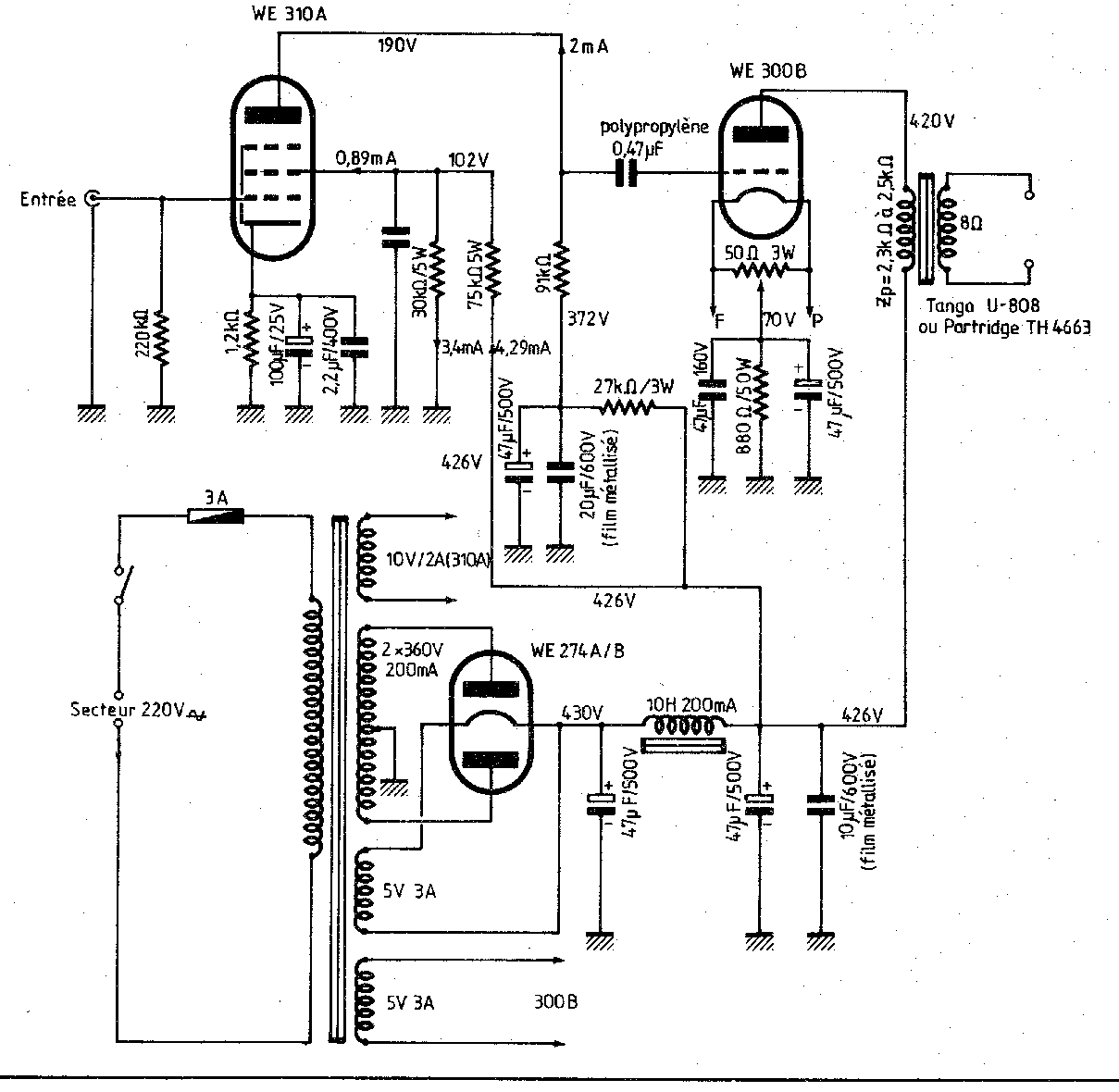

Attached is the schematic of the amp that turned me ( and 1000s of others) on to SET DHT. You could make it simpler, but probably shouldn't.
A single ended DHT is pretty simple to begin with. 3 tubes, 2 transformers, a choke, some caps and resistors. Nothing complicated about that. But it won't be cheap, no.
Nice diagram, but the screen grid (G2) of the WE310 has a capacitor whose value is not specified. Also, it seems (to me at least) that quite a few of the capacitor values are either cavalierly specified, or, just kind of wishfully over-specified. I'm sure it sounded quite nice though.
Those cathode bypass caps look marginal to me. Those old designs where constrained by what was available in a reasonable size rather than minimising phase shift and achieving low end extension. Again its another one of those compromises. Look at Allan Wrights 300B PP amp to see the size of bypass caps which take them completely out of the picture (8000uf back to back with 8000uf for an effective value of 4000uf).

As for the caps in that old design, it's just the first version of the schema I dug up. I will look for a more refined version. As for "over-spec'd", well that's Jean Hiraga for you. He never met a giant cap he didn't like. 😉 (see Hiraga Le Monstre amp)
Just showing that it can be simple, but you shouldn't bare it down to nothing. A pentode input, 300B output along with some caps and iron is pretty darn simple. You'd have to go to a 1 tube amp with an SS power supply make it simpler.
