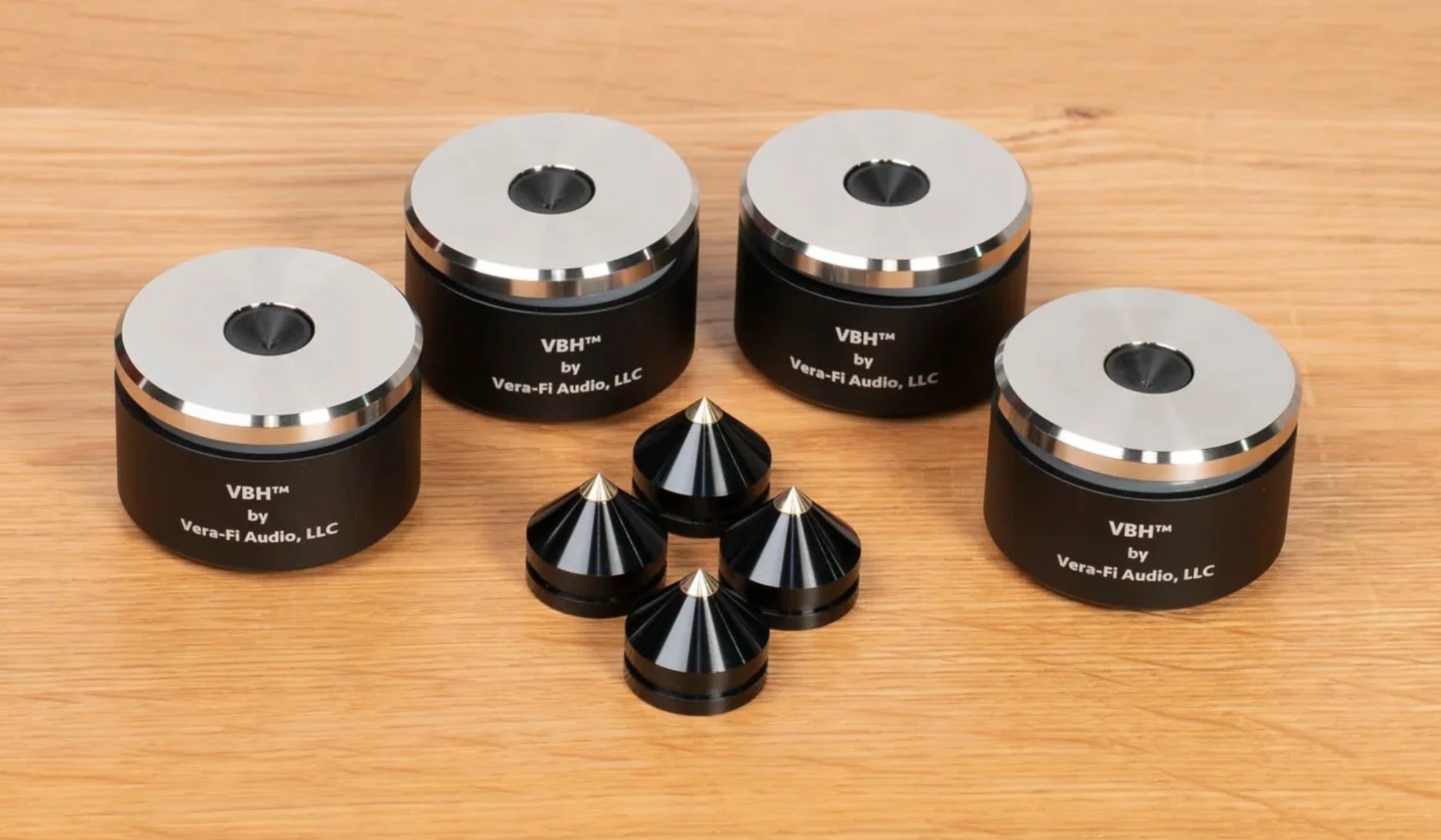

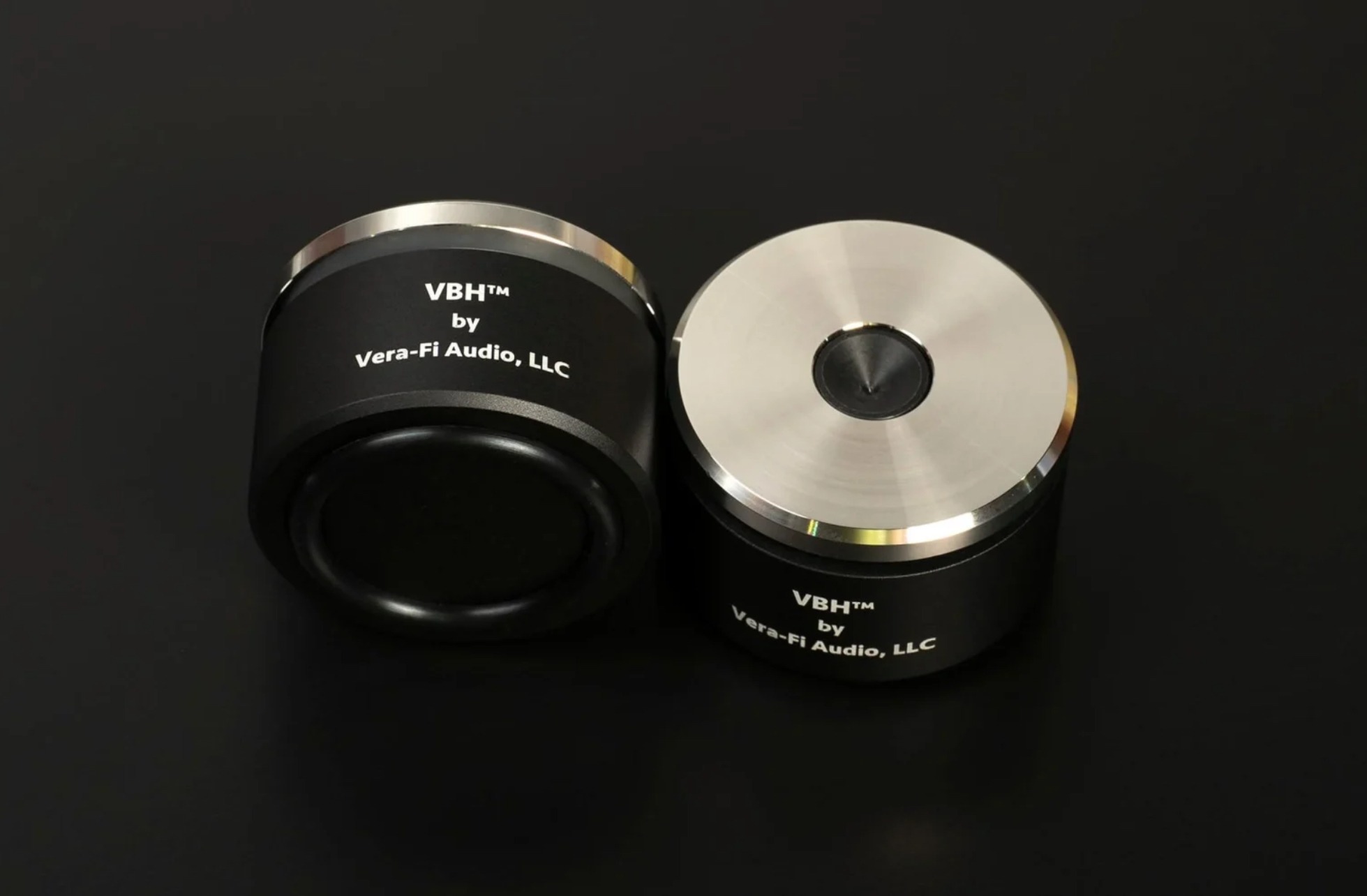

I am developing some vibration reduction feet named the Vibration Black Hole (VBH) for Vera-Fi Audio. It uses several stages of viscoslastic gel damping combined with changes in material density (aluminum to stainless steel to nylon) to produce mechanical impedance mismatches that enhance the loss of mechanical energy transmission. The feet are 50mm in dia and 33mm high. They are designed to be used with spike feet that contact a conical depression in the small black nylon pisto st the top. Self adhesive spike can be provided for installation on the bottom of the piece of gear. The feet work not only in the axial direction but also laterally (radial).
I set up a test to measure the attenuation of an impact to a table that is then transmitted to the plinth of a TT. By instrumenting the plinth with a piezoelectric transducer, we can measure the transmitted energy from a mechanical impact to the table. I use a special instrumented hammer fitted with a calibrated transducer (PCB Piezotronics, ICP Impact Hanmer). This way, we can quantity the hammer impact energy for accurate comparison.
This is the VBH:

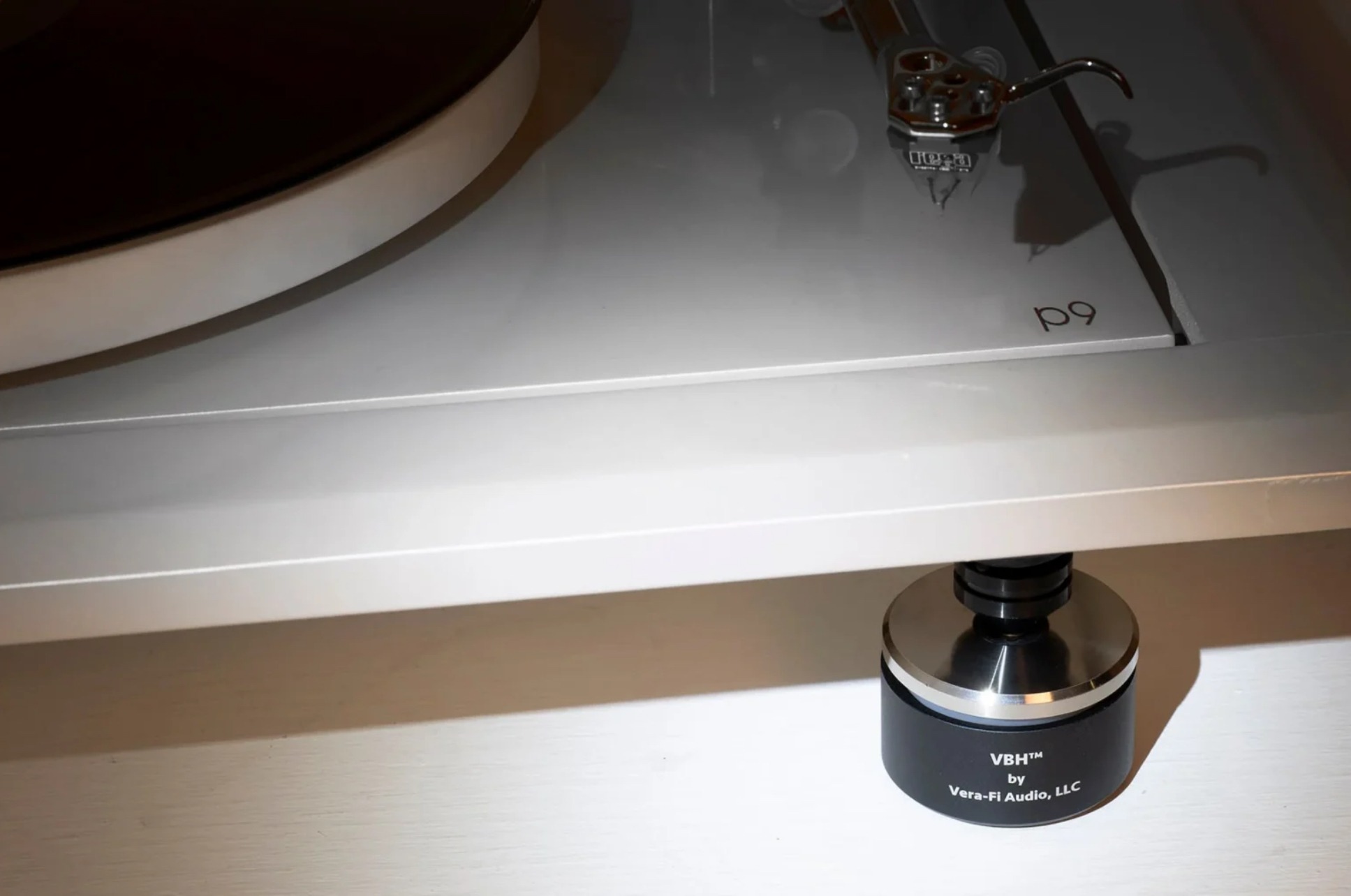

Here is a closeup of the VBH installed with a spike foot under the stock feet:
Here is the Oscope trace with VBH. Note that the hammer energy is approximately the same at around 24.6Vpp. The transmitted vibration is reduced in amplitude but more importantly, the high frequency resonances are smoothed out. The VBH will help to dissipate impulsive energy (taps, bumps, etc,):
