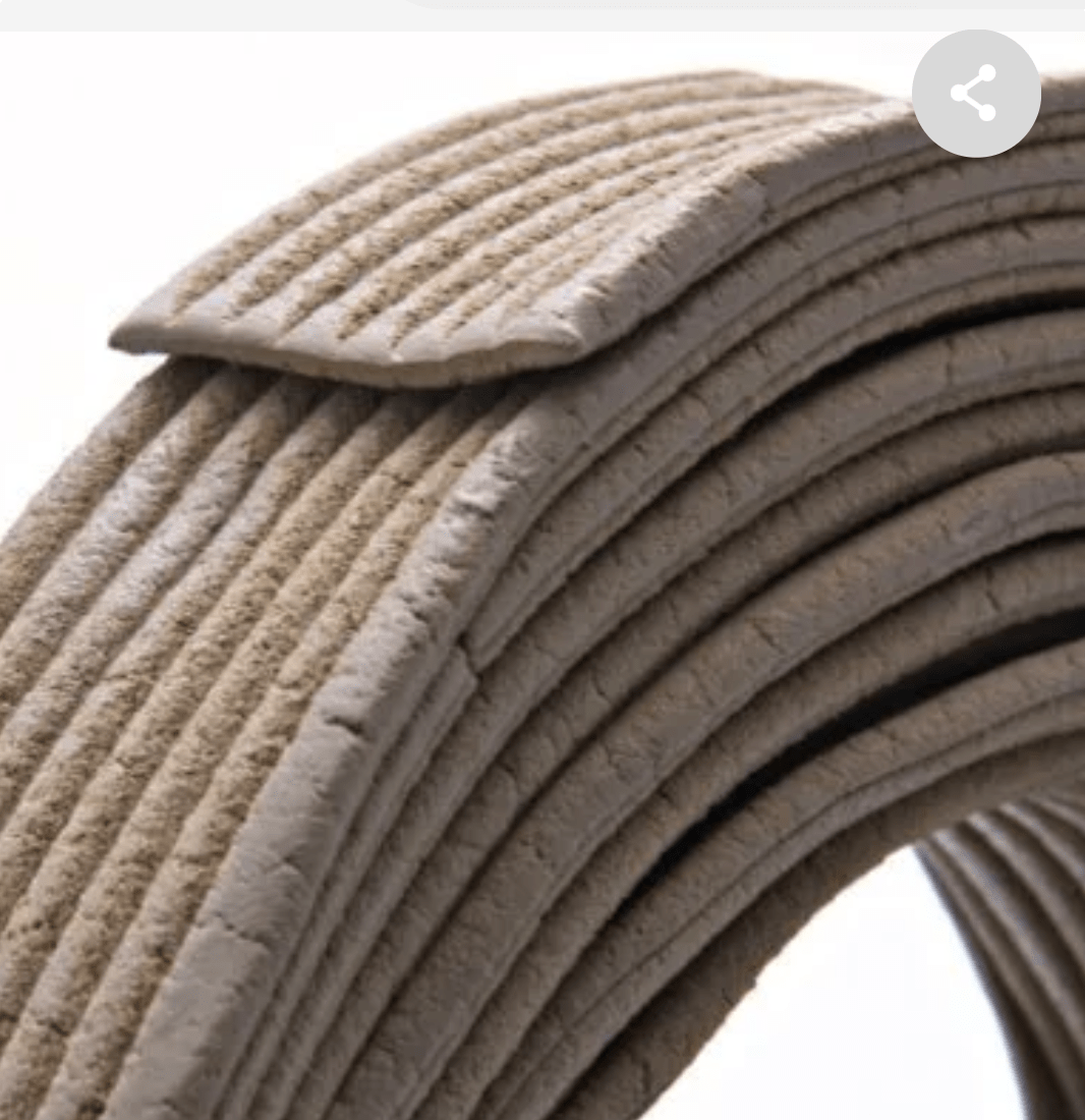

3M damping tape. Wonderful stuff!

Best damper is weight. So if at all possible. Connect the top covers to the bottom in the middle to 'ground ie weight' via a rod/bolt. This will couple the weight of the device to the top. If not feasible because there are electronics parts in the way or because it will look too ugly. Glue lead to the inside of the top cover.
Weight/mass doesn't damp, it just lowers the resonant frequency. Adding a strut between top and bottom is changing the resonant modes, raising the resonant frequecies. Damping involves dissipating mechanical energy as heat, usually using visco-elastic materials which self-heat when distorted.
Since your chassis is very nice and apparently could also develop quite a bit of heat I think it deserves a material like butyl (sheet) which I'm a fan of.Any suggestions for dampening material to use on these tops?
From the Internet: "Butyl has very high impermeability to gases, ozone, ultraviolet light and weathering. Butyl also has high chemical resistance and is particularly good where high or low temperatures prevail".
Something like this automotive sound deadener, just as an example.
P. S.: to be used under the lid, not on top...
