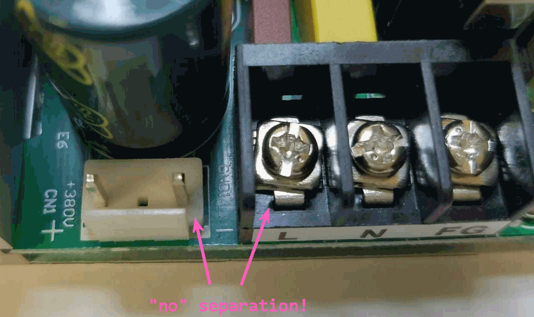

There are quite a few of these, and I haven't seen anyone mention them on this forum:
7R 230W 5R 200W Moving Beam Head Light Power Supply 380v 12v 24v | eBay
They are for some kind of high powered DJ lights.
What do you think is going on in this circuit?
Do you assume isolated?
The 380V output is beside the input connections, I would assume it isn't isolated but it may be.
Interesting though, I've never seen this one before.
...Do you assume isolated?
My bet is NO.
You couldn't fit a fat cockroach between "L" and "380V".
