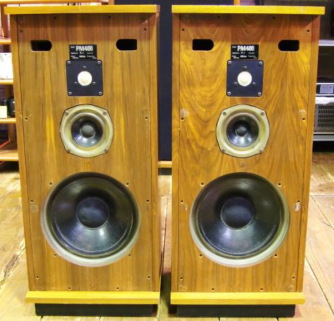

It wouldn't be hard to design a three way filter for this driver too, a la Chartwell PM400 style. Either conventional, or this Wharfedale E70 style with the PA projection of the all important vocal range. Lot to like, either way. 😀

The picture of the Chartwell takes me back to vintage driver spotting mode. The woofer looks like a maybe a Richard Allan HP12. The tweeter is definitely an Isophon KK10 or KK8. The mid, I do not recognize.We must accept that the Vifa P13-WH-00-08 is a thing of the past. 🙁
