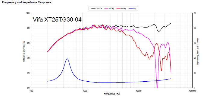

XT25 got some troubles in sub-4K region. Not that bad, yet...
For high-end no-compromise thing - 4k is fine.
For compromised design - 2.5k.
Waveguide helps here to tame the distortion rise under 4k - you pump-up the efficiency by the waveguide in the 1-4k range, and then flatten it out by filter = less cone movement, less HD. This way it could go down to 1k 🙂

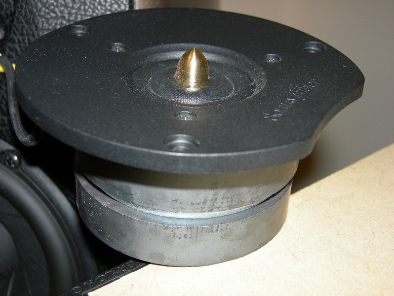

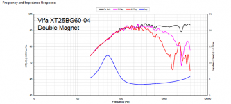

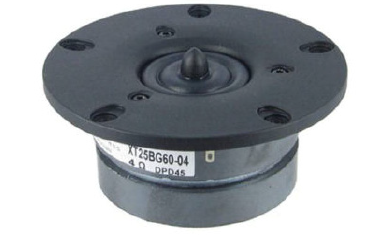

Just thinking aloud here, really. We had someone a while back who really rated the double-magnet version of the Vifa XT25. 🙂
FWIW, Troels Gravesen never crosses Vifa tweeters very low. Around 3.5kHz. It's actually a bit better behaved than the regular XT25TG30-04 version which Troels uses in the Paper woofer Ellam-XT and Polycone woofer VifaPL14WJ+XT25TG designs. But is 2dB more efficient, which is fairly easy to allow for I'd reckon.
Lack of ferrofluid DOES make for a slightly alarming impedance bump at Fs and the low impedance of 3 ohms DC needs correction. The other fix is of course a shunt resistor around 10 ohms to flatten impedance too. Hope it helps anyway.
