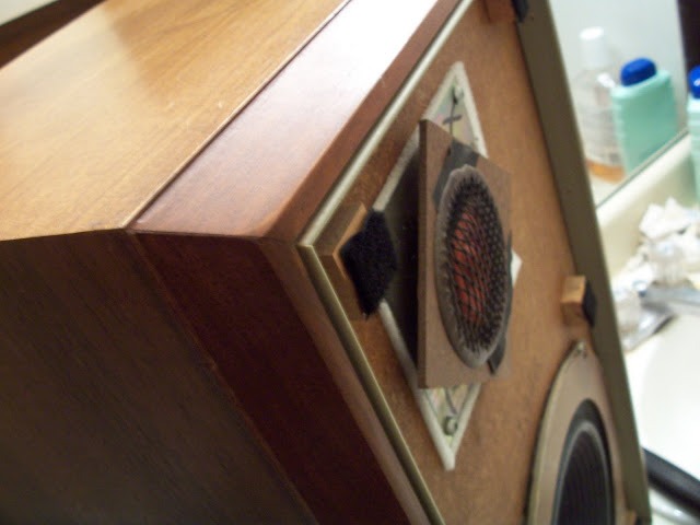

Hi Cliff! I've been waiting to see your next project. 😎
The Advent Loudspeaker (later called the Larger Advent, after introduction of The Smaller Advent Loudspeaker) rivaled the sound of the then top-line Acoustic Research AR-3a.
https://en.wikipedia.org/wiki/Advent_Corporation
Apparently, the Advent Loudspeaker was offered in both wood veneer and vinyl-covered "utility" cabinet versions, which were acoustically identical.
Accordingly, I wouldn't go to the lengths of applying a real wood veneer. Better options would be either to clean up the enclosures and sell them 'naked', or to apply a vinyl wrap.

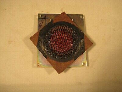

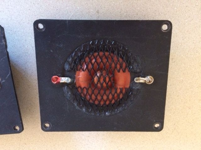

Yours have the original 'fried egg' tweeters with the square magnets, later to be replaced by a prettier version (see attachments).
Give the tweeters a careful visual check. Moderator planet10 told me that when they blew they would spew ferro-fluid all over the back of the cone in the area of the voice coil.
Regarding the capacitors, to return the speakers as close as possible to the way they sounded when new, I would recommend replacing the aged electrolytics with fresh electrolytics - not poly caps.
EDIT: I now read that the enclosures were available 'unfinished'. That will be what you have if there is no trace of wood or vinyl veneer covering.

Original Large Advents, which the OP has, did not have ferro-fluid. The New Large Advent tweeter in the third pic would indeed spew the fluid, as mine did. They were replaced under warranty back then.Hi Cliff! I've been waiting to see your next project. 😎

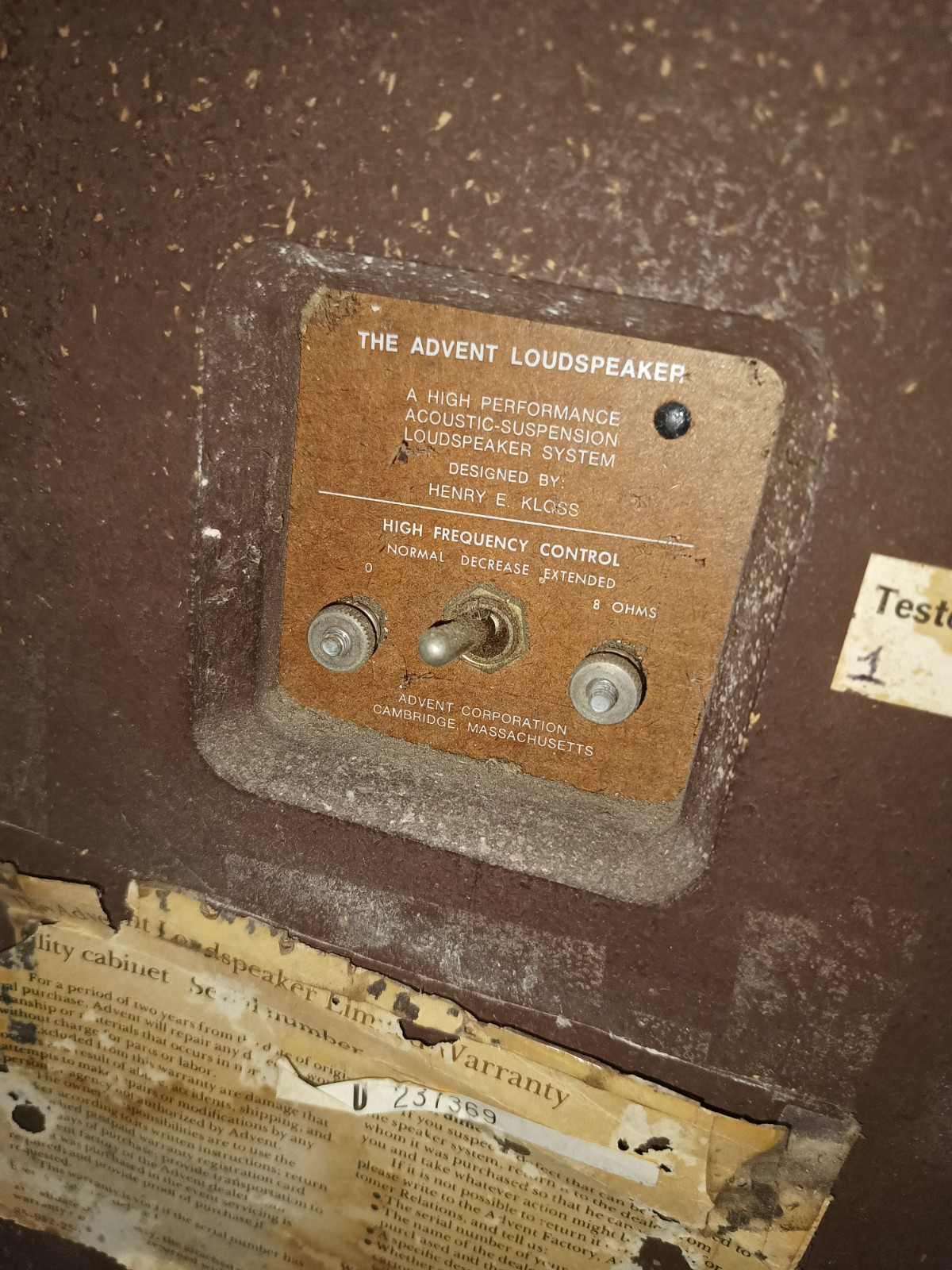

My latest acquisition, these Advents.
These ones are naked (no veneer).
I'll clean them up and listen to them and then decide.
If I do, vinyl wrap would set me back $27.
Would you recommend Walnut?
If I did replace them, which brand/model electrolytics would you recommend?
The baffle board is black so I can freshen that up with matt spray paint.
I also have velcro squares which I can staple to the six wooden blocks which sit on the baffle board to make the face look more presentable.
I'm keeping the same driver screws but have polished their heads on a metal polishing buffing wheel.
Everything else I'll keep original as possible, as advised.

1. Why not go funky with an orange vinyl to match those orange tweeters? 😀

The "Utility" cabinets that you have came in a walnut vinyl wrap. There was a walnut veneered version available at a greater cost. Those also had a solid wood bullnose that surrounded the grill. Even though I purchased both the original and New LA when they were current, I never heard of a raw cabinet being offered in the U.S.Thanks Galu and all contributors.
