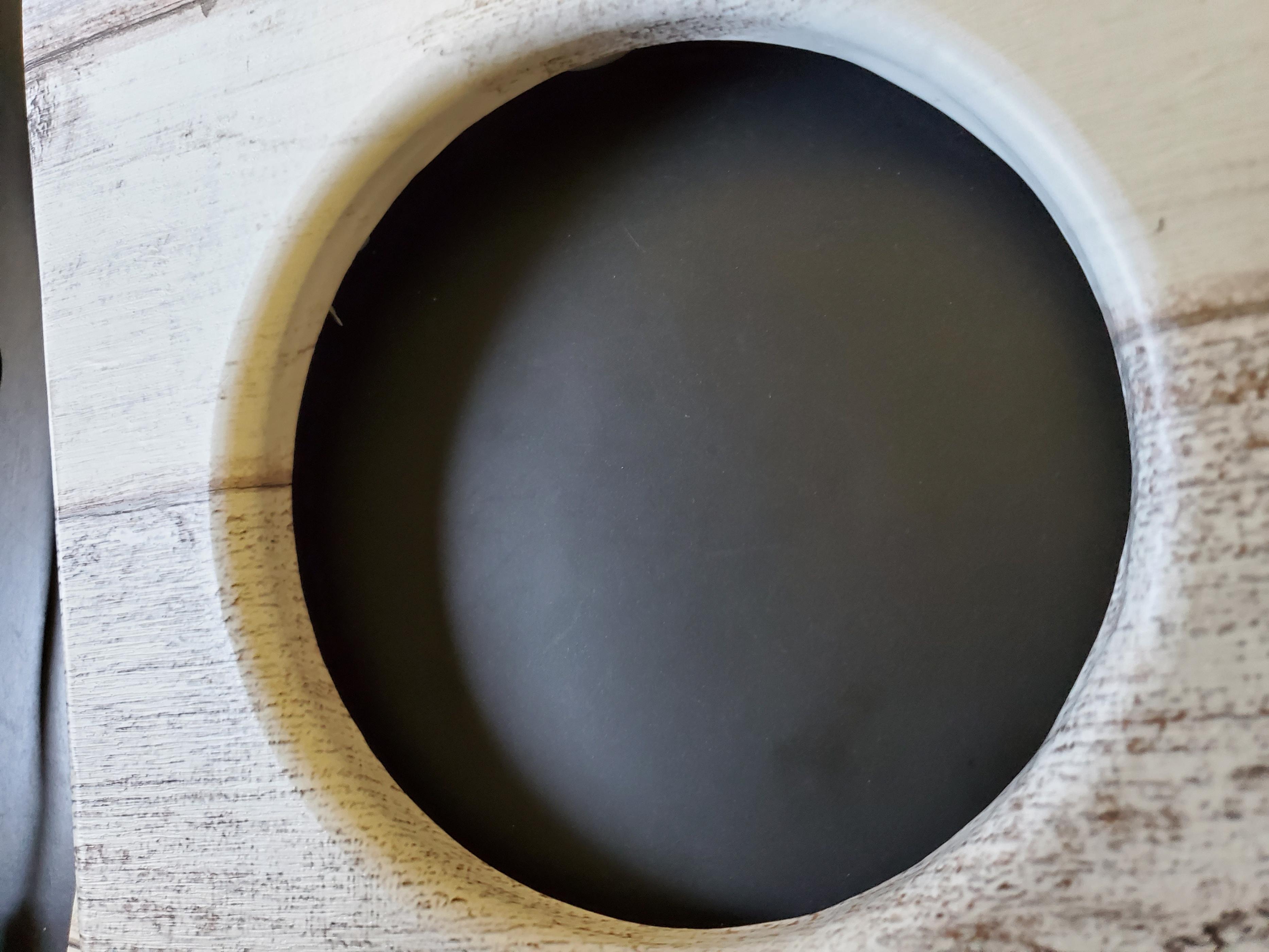

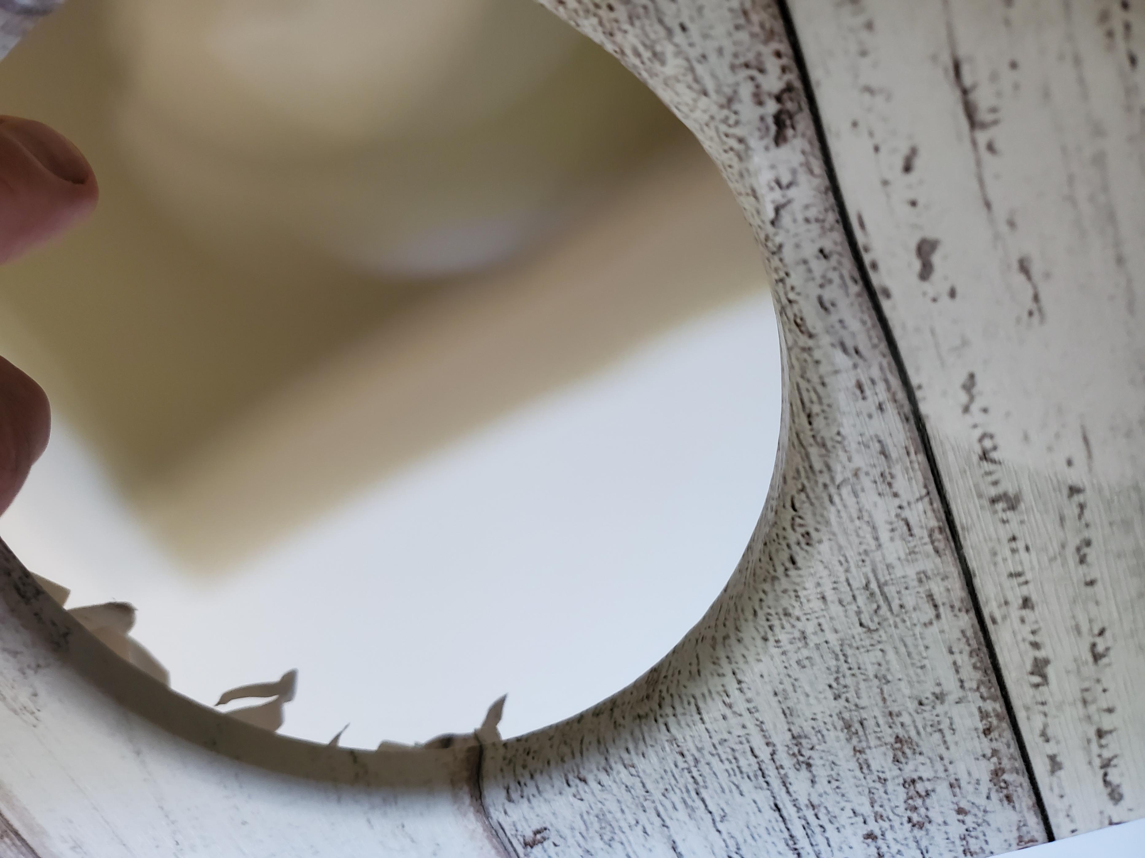

I have really been thinking about this a lot, and I know if I had unlimited resources to make this work, I could do it. I am speaking just of how I'd get the vinyl wrapped around the recessed woofer opening- I'd have a machine with a funnel shape, like a 'V' which would apply constant pressure downward through the woofer opening as the vinyl is heated. Eventually the 'funnel' would be as far down into the recess as it could go, where I'd then let the vinyl cool for a bit before removing it. That in theory, would work for this difficult situation: A corner-rounded recessed circle.
I'm off to give it a try right now. I figure the best I could do is to sneak one of my wife's measuring cups and use that as the funnel-shape. Maybe a ball of some sort...
The corners are a whole different beast, which I'll tackle after figuring this out. I suppose MAYBE I could just paint the recessed edges black so the vinyl doesn't have to conform to them, I don't know. I'm emailing vvivid right now, too. Thanks for the suggestions again, Russ. Have a great day.

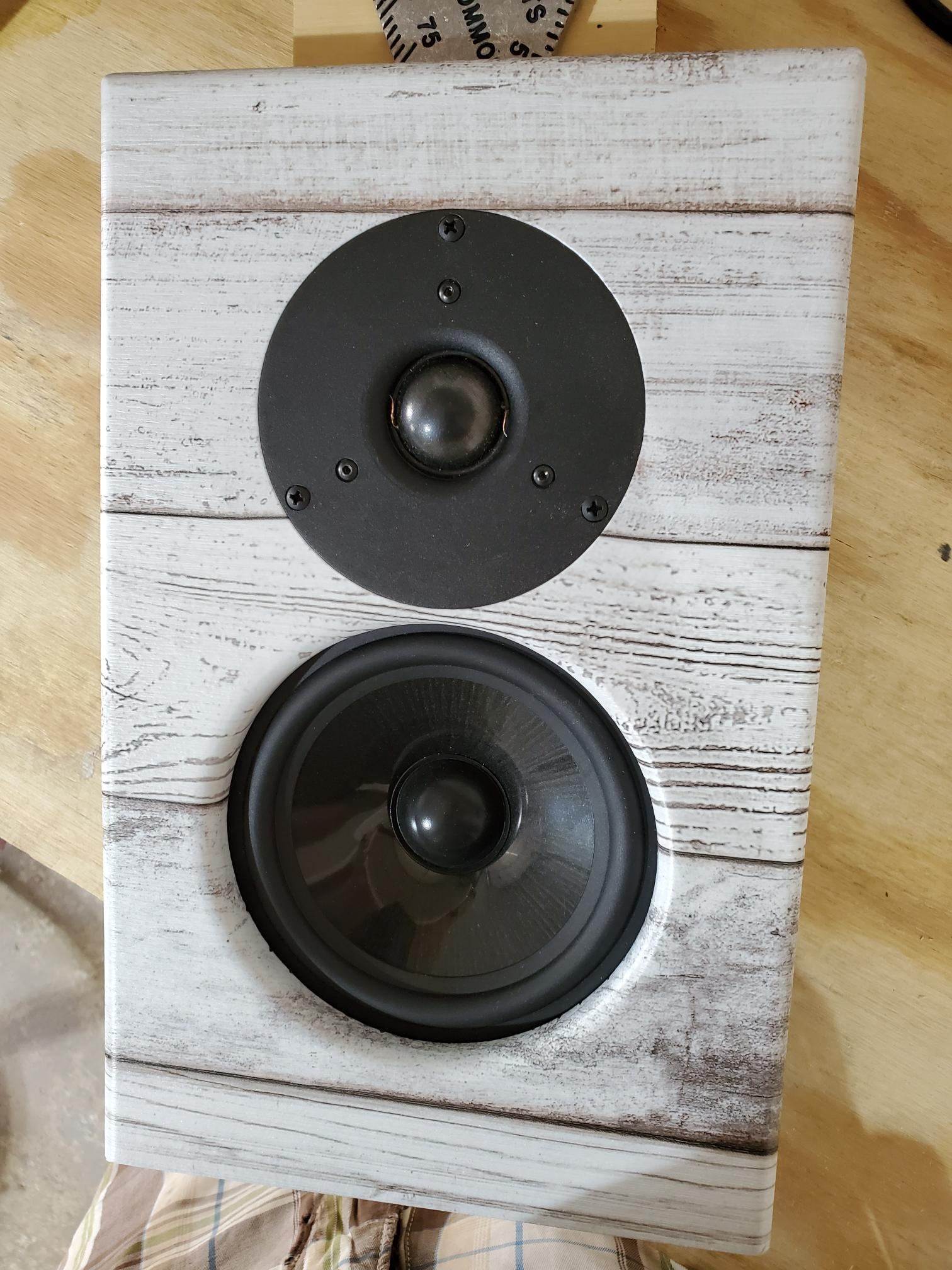

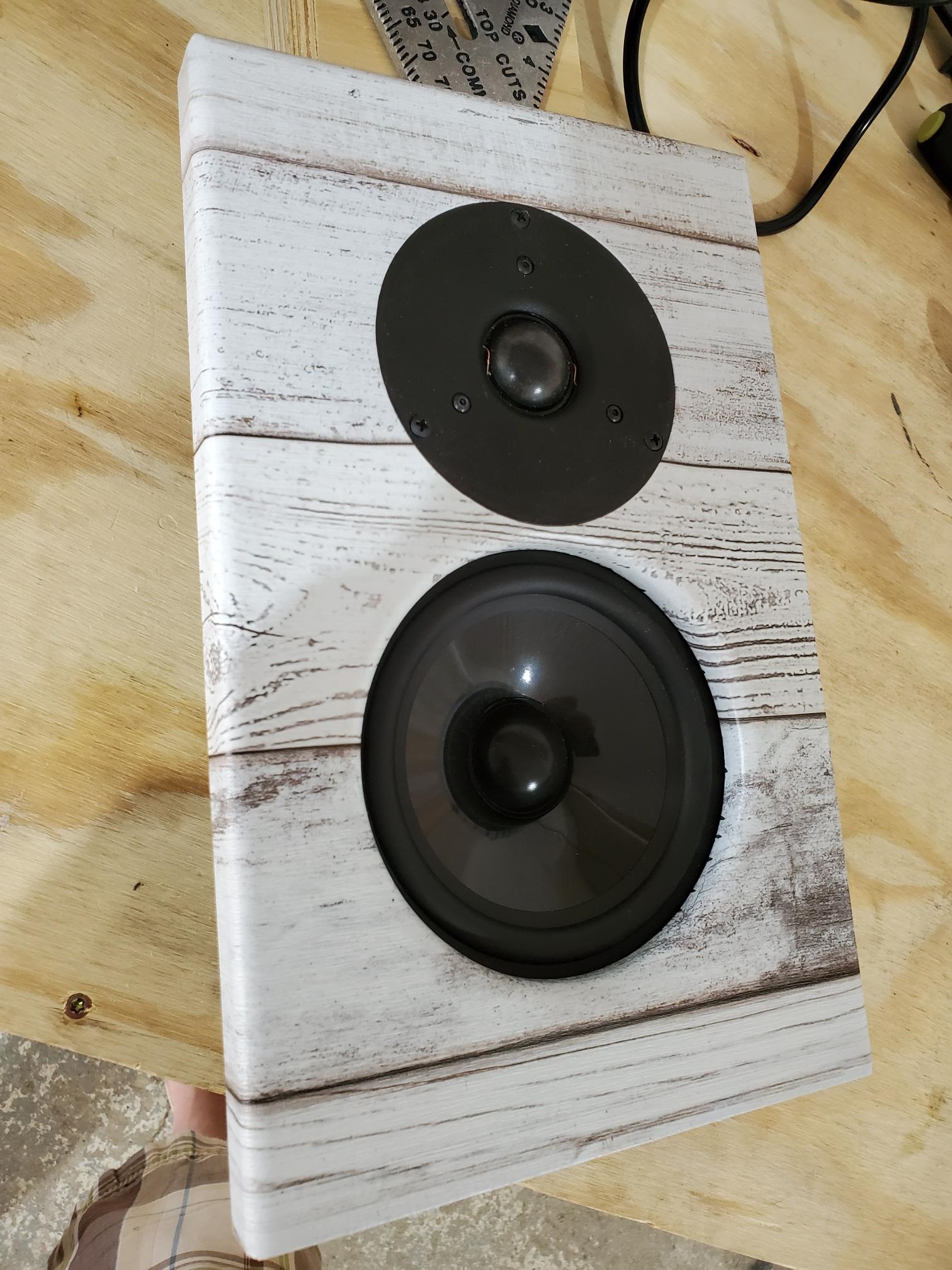

As usual, I overthunk it!
A little heat and some tactical slicing, voila!
I had to go very slow and do an inch at a time. Every time it seemed like it was getting too tight because of the stretching, I made another cut in the vinyl to relieve tension. I'm very happy with the results. What do you think?
Thanks again!
Thanks again!
Cool I'm glad you all like it. Really more-so because I know I typed the phrase "vinyl wrapping reclaimed wood look" many a time into the ol' googs, and never came across something explanatory like this. Hopefully it helps people in the future.
I must stop this accidental lie before it spirals any more. I bought the wood look from two brands- Vvivid and 'VeryBerrySticker'. Vvivid did not have the actual reclaimed wood look- the closest they had was 'light teak'- which I did buy, and does look/feel awesome! This look is from the latter of the two companies. However, I will be using the Vvivid 'light teak' for other speakers in the future. Honestly the Vvivid material feels even more wood-like than this one, but both have a realistic wood grain feel.
Yes, I'll probably post a review for 'verryberrysticker', commending them on a good product. This specific pattern has almost 900 5 star reviews, and I can see why. This specific pattern is their "Reclaimed Wood Distressed Wood Panel Wood Grain Self-Adhesive Peel-Stick Wallpaper (VBS304)."
As I said, the part that scared me was I didn't realize I bought WALLPAPER. Hey, it works. Don't know til ya try.
I hope everyone enjoys this 7th day. Thanks again- I'll post pictures of the final wrap as well, of course!

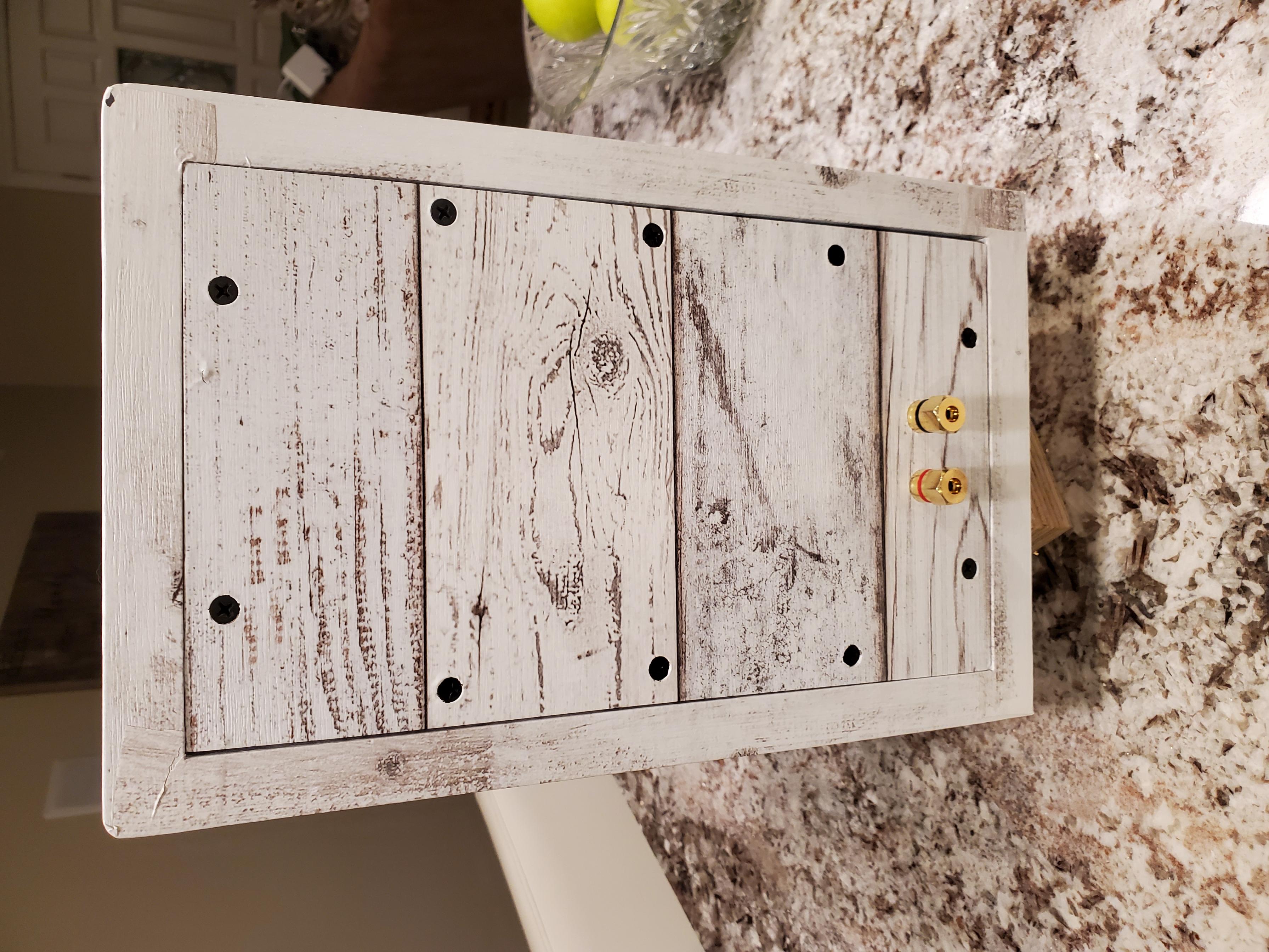

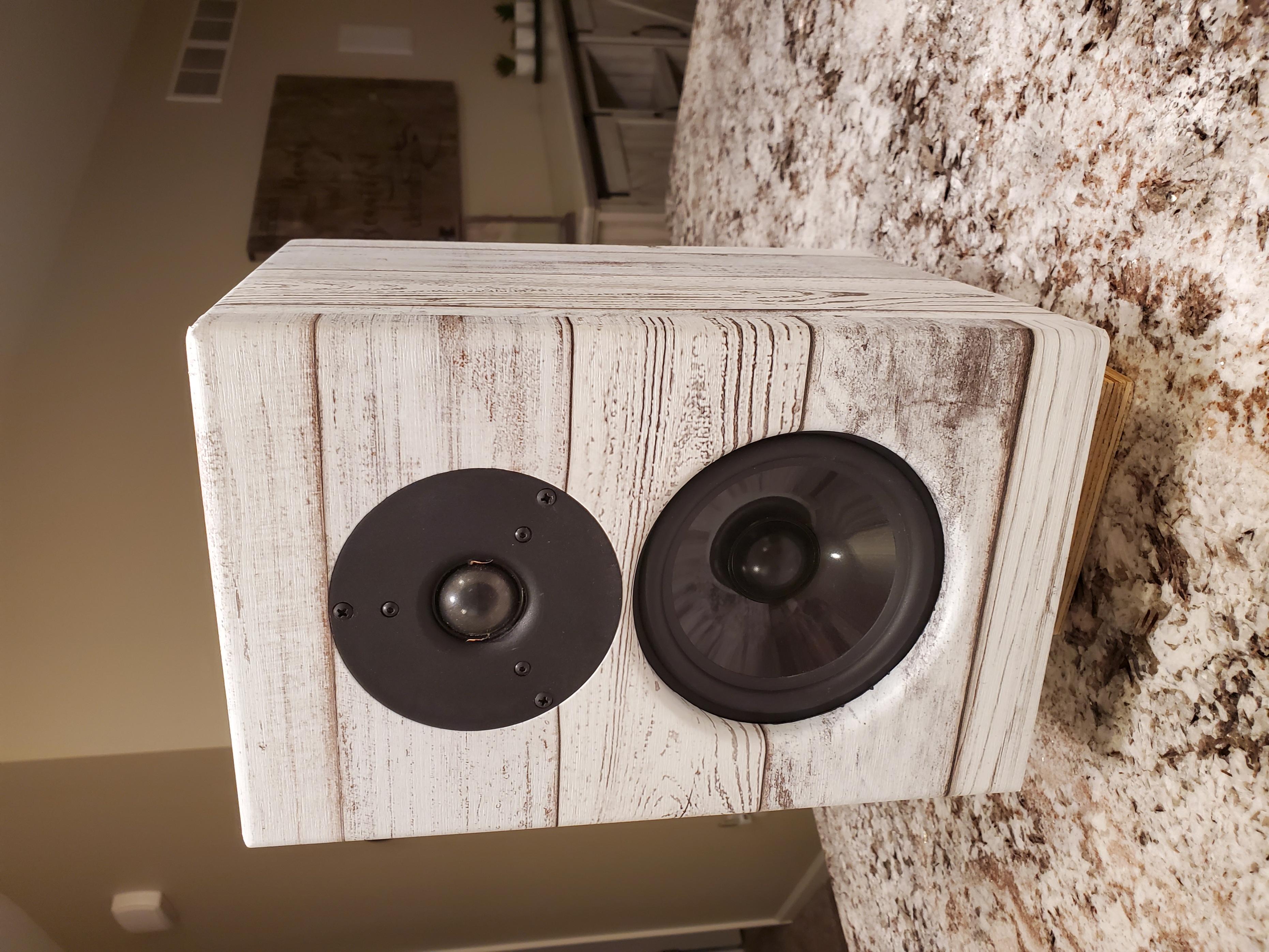

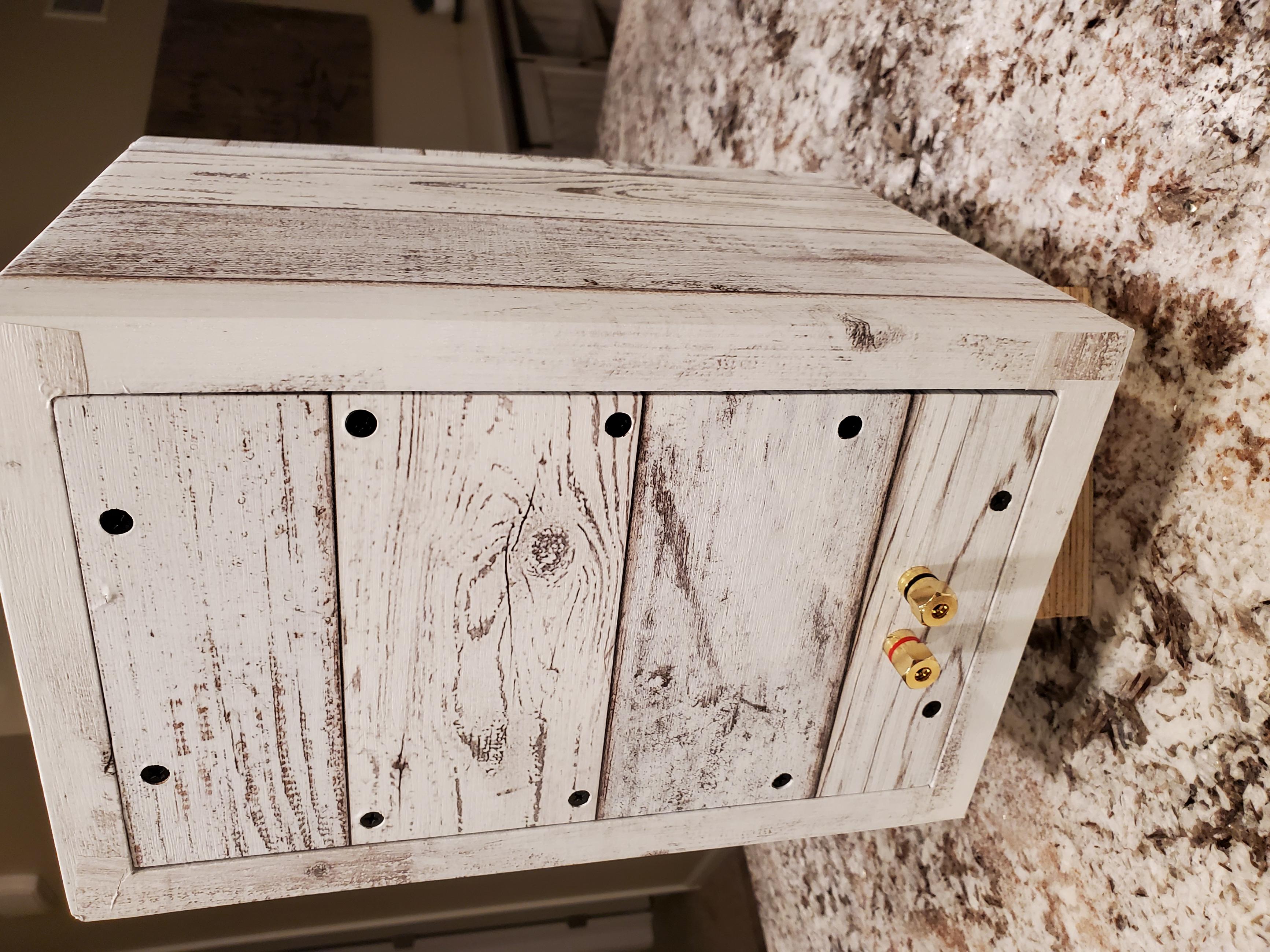

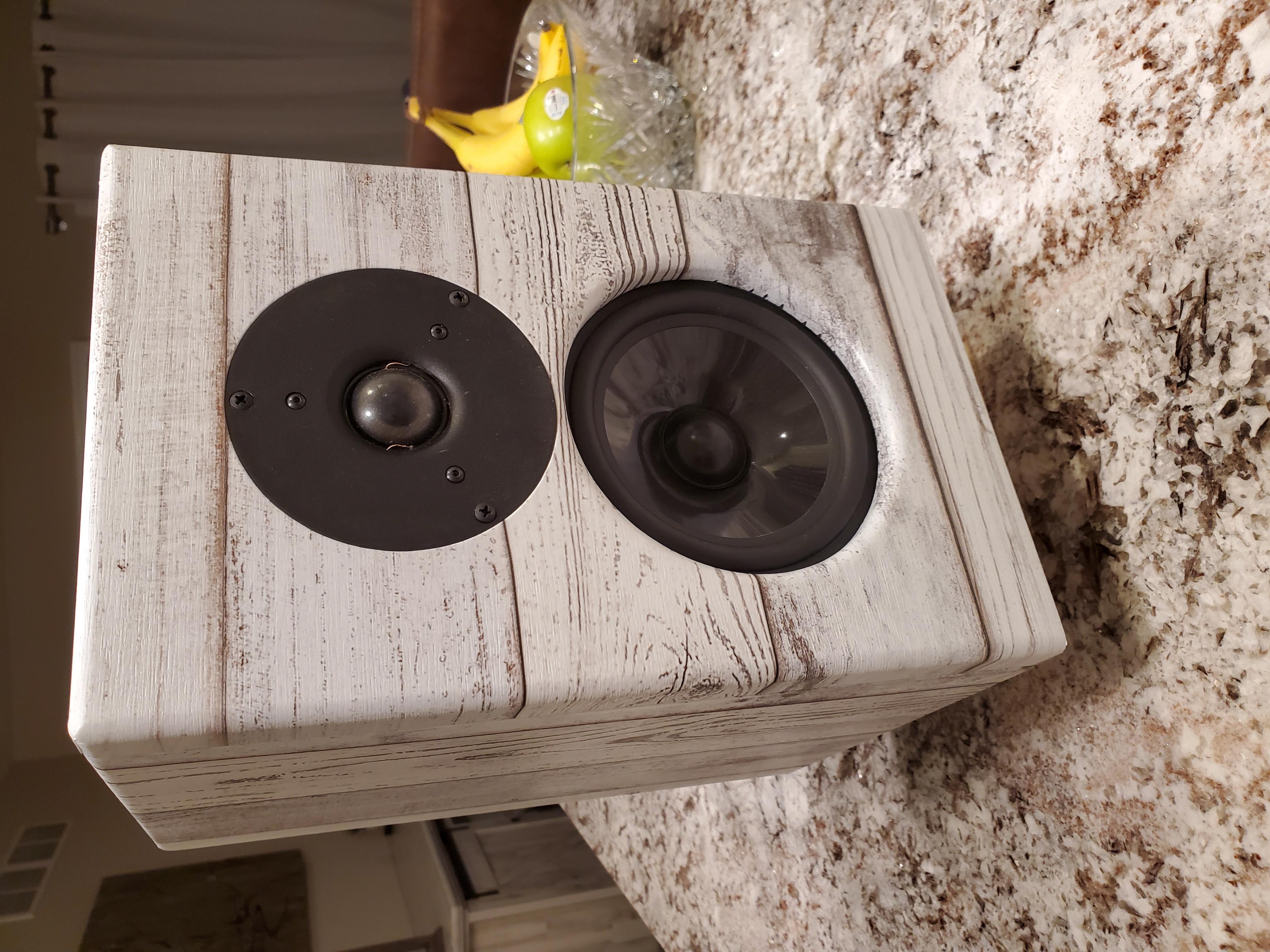

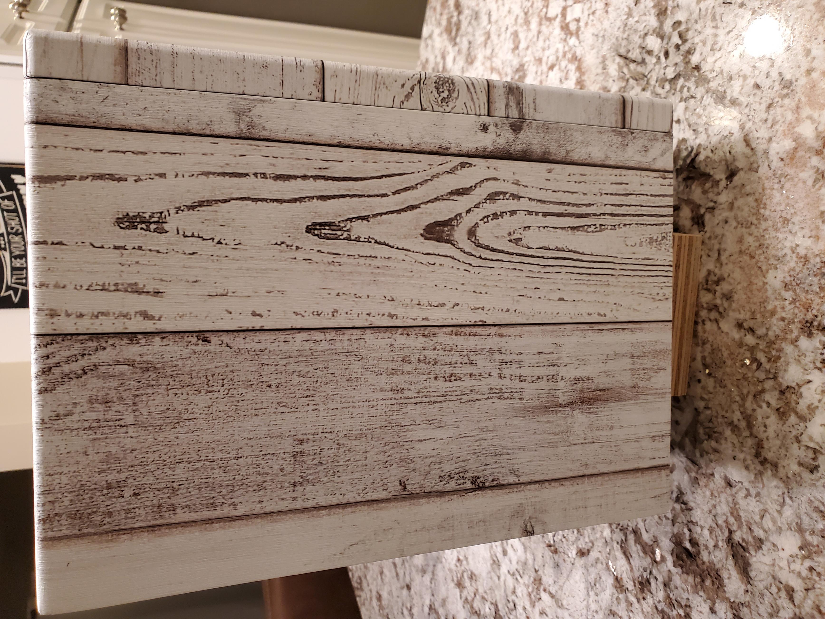

Completed Wrap
As promised, completed wrap. Now on to building a 3rd for the center channel in my living room.
