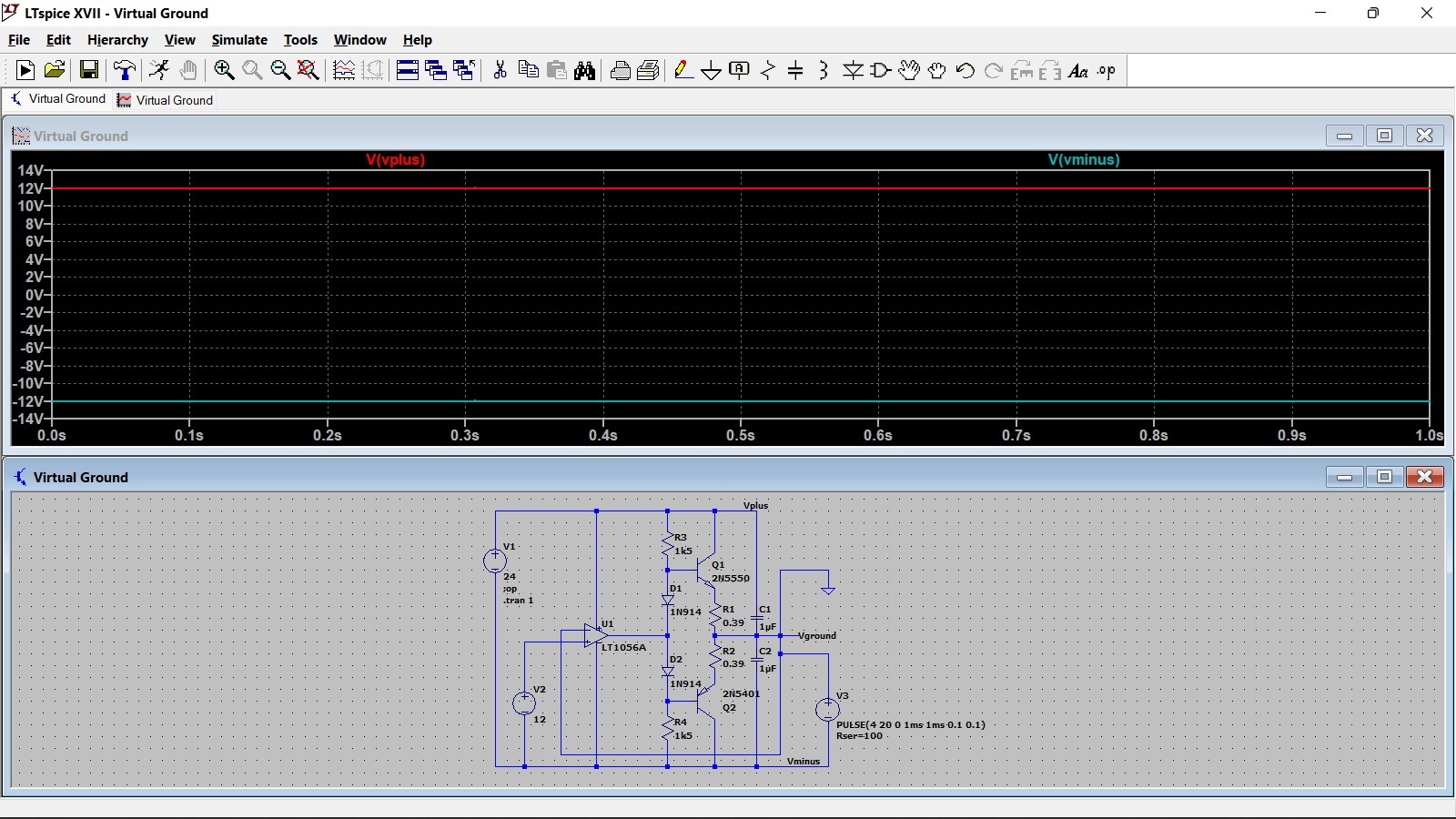

I am planning to build a virtual ground circuit as attached.
Now, the OpAmps that I have at hand are NE5534 and OP77. And I am really not sure, which one to prefer: The NE5534 is better at noise, the OP77 is better at bias current and PSRR/CMRR.
Can anybody give me a hint what the critical values are in this case? I really don't know 😢

My instincts say that given the 1uF filtering at the output that the opamp will make little difference. I'd even go as far as thinking a 741 would give similar overall results to something exotic.
Transient response might be more of a real and measurable difference which I suppose depends on what you are going to ultimately power with this.
That seems like a pretty easy sort of a load then and the circuit design looks fine at first glance
This is where transient response comes into play but your load is going to be essential constant so I don't really think you would have problems here. If the load was pulsing something at highish current then it might make a difference.

Also sharp pulses of significant current as a load probably would never occur in real life in your application. I set mine to have a rise and fall of 1 millisecond.

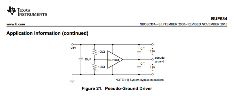

The little rail-splitter IC is cute, though. I hadn't heard of it before, and it sounds like a useful trick to have up one's sleeve. From the TI TLE2426 datasheet, output impedance is very low (nominally 7.5 milliohms), and it works very well by itself.
To tell the truth, adding the op-amp and buffer transistors only worsens stability, while adding cost, eating up board space, and adding complexity. Unless you need to source or sink much more current than the TLE2426 can handle on its own, I think you're much better off using just the IC by itself, the way the TI designers intended it to be used.

Just the TLE2426 is all you need. If you're concerned about noise, get the DIP version and use the Noise Reduction pin, as per the datasheet. Also pay attention to Figure 17.Actually, it's intended for the line output stage of a DAC, nothing more than a couple of opamps, caps, and resistors.

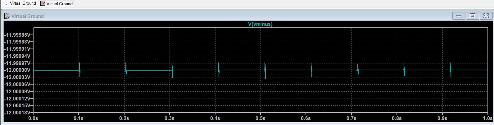

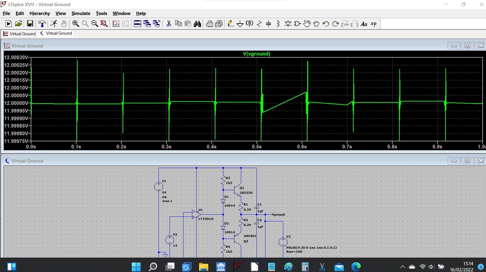

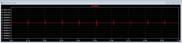

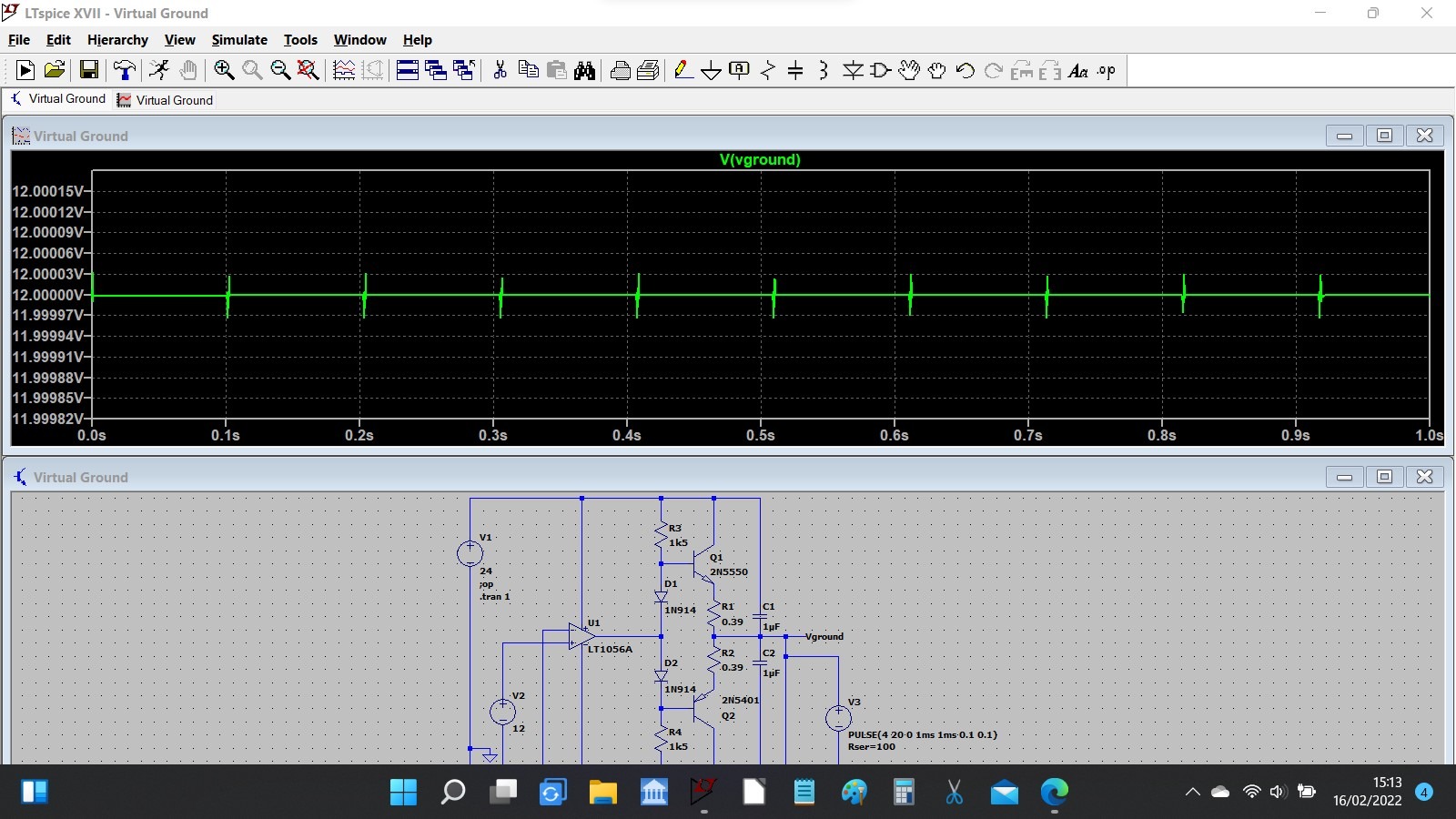

Well that's where it gets really interesting... because the virtual ground point becomes our 'ground' and so by definition is clean. So any noise or ripple or whatever is then transferred to the - and + rails as measured from the clean ground. Its a subtle difference.Finally, the truth will be at the output
Here is the sim changed to reflect that.
