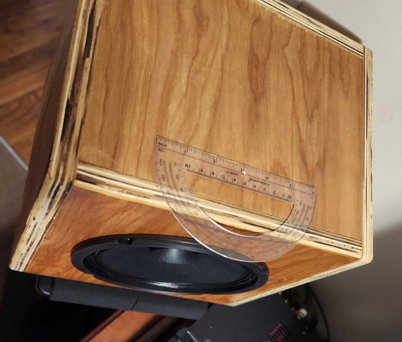

Finished cabinets with drivers:
Cutting, Assembly and Finish:
Some 3/4th inch thick birch veneer plywood (4x4 feet scrap)
Wen track saw with track
Assembly is just wood glue (Titebond) and clamps. I had just enough clamps to do both cabinets at the same time. I need more clamps!
Home made jig and measured with the hand router and an up cutting spiral bit for making the driver holes.
Calked all the insides at all joints.
Terminals pushed through some drilled holes.
Finishing:
A coat of Minwax Natural
Next, a coat of satin poly
Wiring, Gasket, Stuffing, Driver Installation
I made some basic cables with spades and hoop terminals.
Hot glued them after installing just to give them another level of "stay put."
Same thing on the hoops internally on the terminals, threaded down some washers and nuts and then got glued them to keep from vibrating loose.

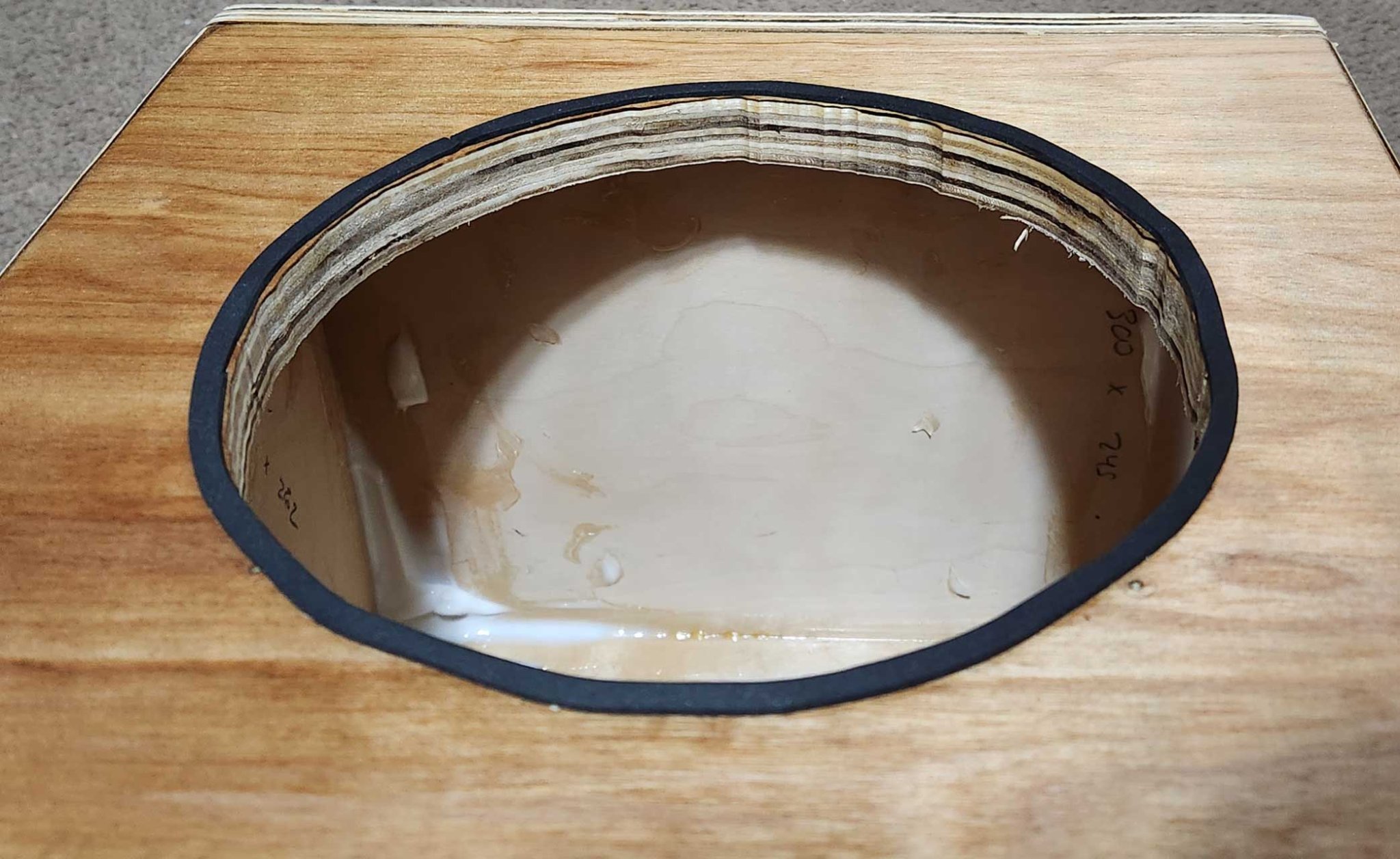

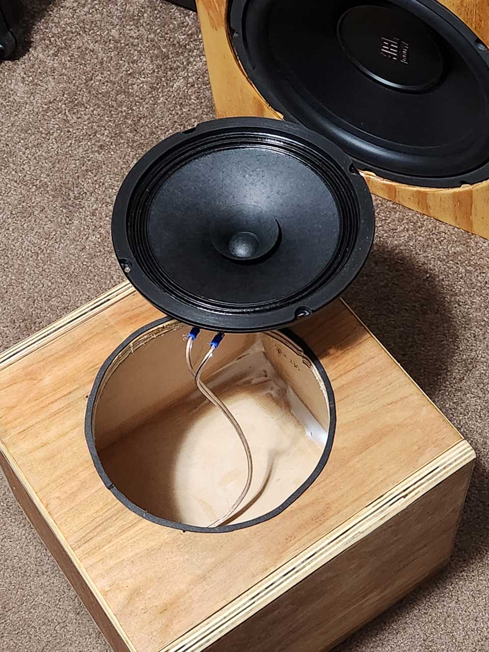

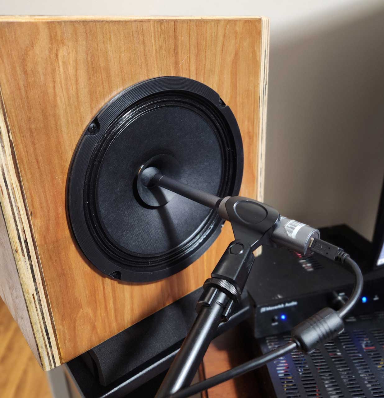

Gasket liner for the driver to sit on. I didn't do recessed because my circles are not perfect so there was no point trying to do a pretty rabbet bit recession. Maybe next time. I cut some liner down to about quarter inch and placed it on to help seal the driver.
Wired them up. Tested them. They worked. So time to stuff and install.

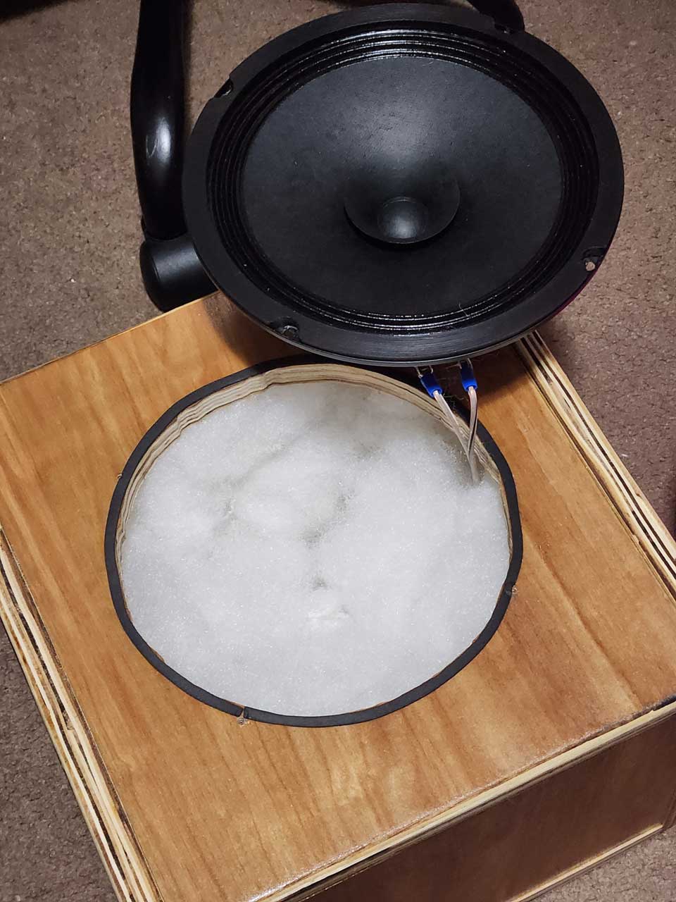

Stuffing. I used some left over polyfil. I measured about half a pound and came to about 228g and I got the same amount in each cabinet.

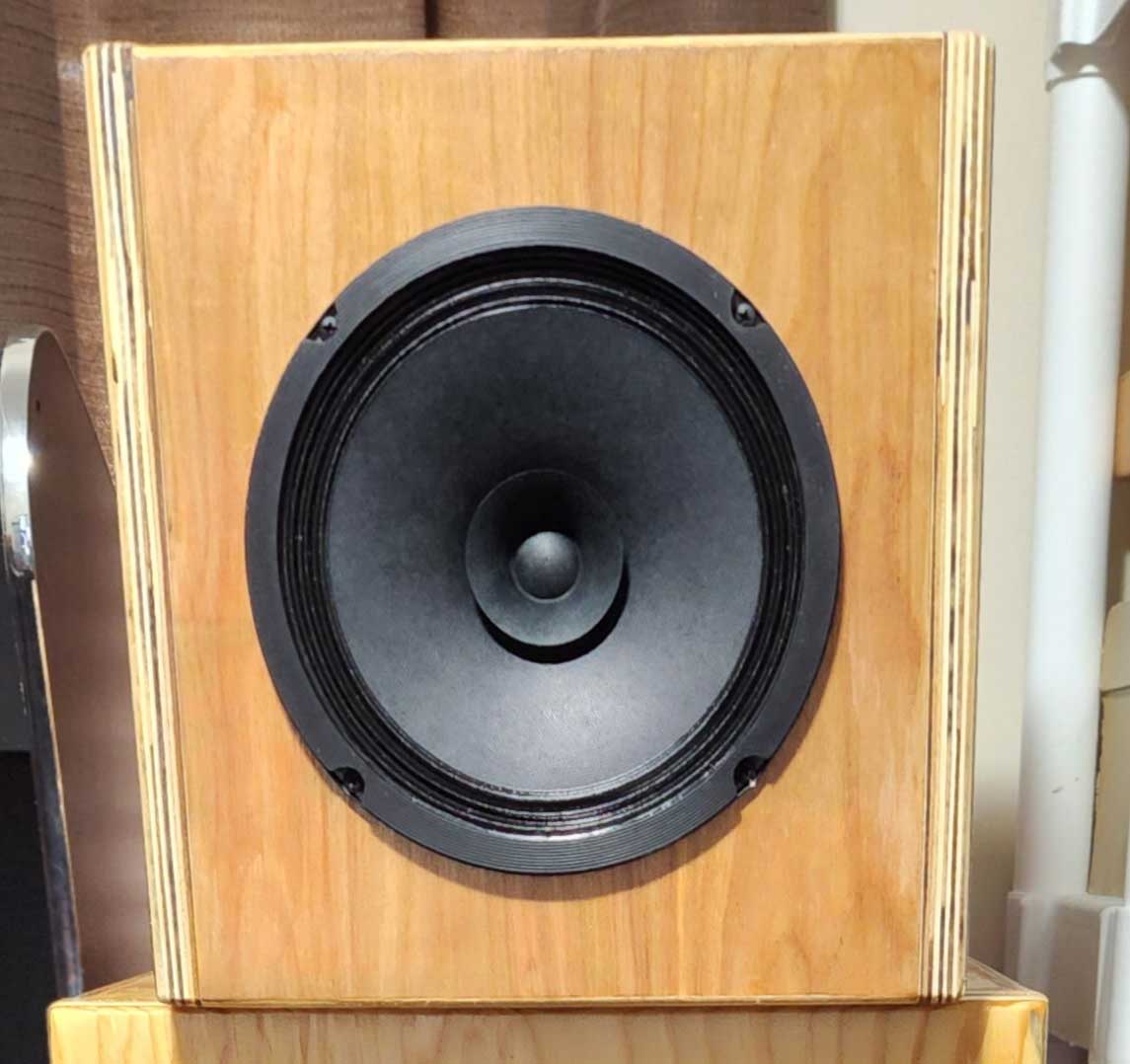

Installed
Measurements and Thoughts
From my cabinet dimensions, my internal dimensions are:
Top to Bottom: 264mm
Standing waves: 650hz (plus harmonics, 1.3khz, 2,6khz, 5.2khz, 10.4khz, etc)
Left to Right: 264mm
Front to Back (ignoring the driver's motor and magnet): 209mm
Standing waves: 821hz (plus harmonics, 1.64khz, 3.28khz, 6.56khz, 13.12khz, etc)
I didn't design the enclosure dimensions to achieve a golden ratio for standing waves, but rather, I figured knowing about them and seeing if they show up in a meaningful way might matter and if we can eliminate them if they do surface.

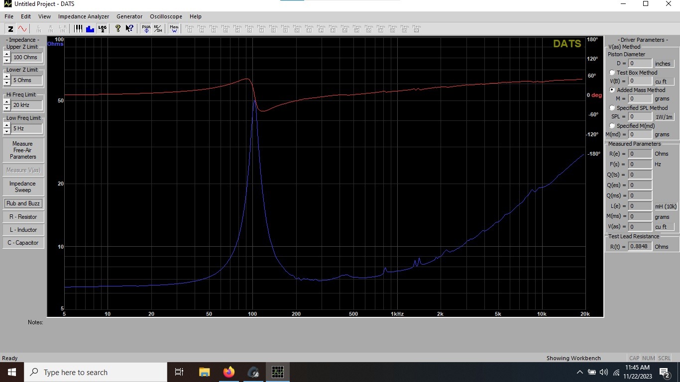

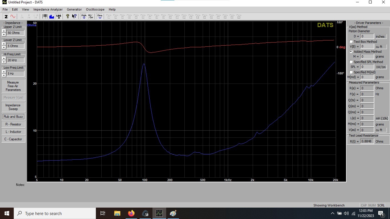

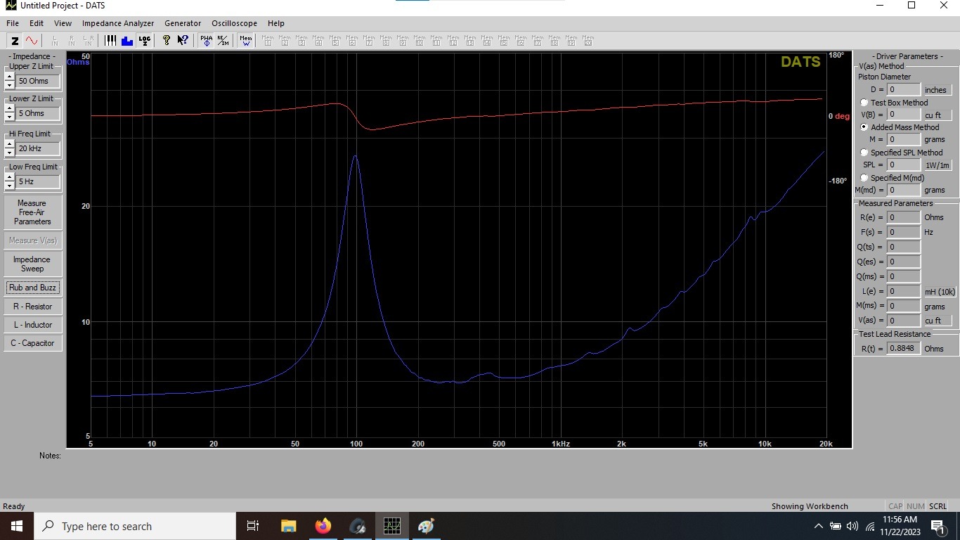

DATS (Impedance Measurements):
First impedance sweep, no stuffing in the enclosure (I just wanted to see before & after stuffing changes here). The impedance spike is where it was predicted.
I see a ripple spike just after 800hz, which may be a tiny result from the predicted 821hz standing wave.
I see two ripple spikes together around 1.3~1.5khz which may be results from the predicted 1.3khz standing waves.
They are quite tiny, so I don't imagine that they will matter much.
After I stuffed both enclosures with 228g of polyfil, I measured them both and here are both of their results:
Significant reduction in the impedance spike near 100hz.
Most of the potential predicted standing wave ripples were reduced to gentle humps.

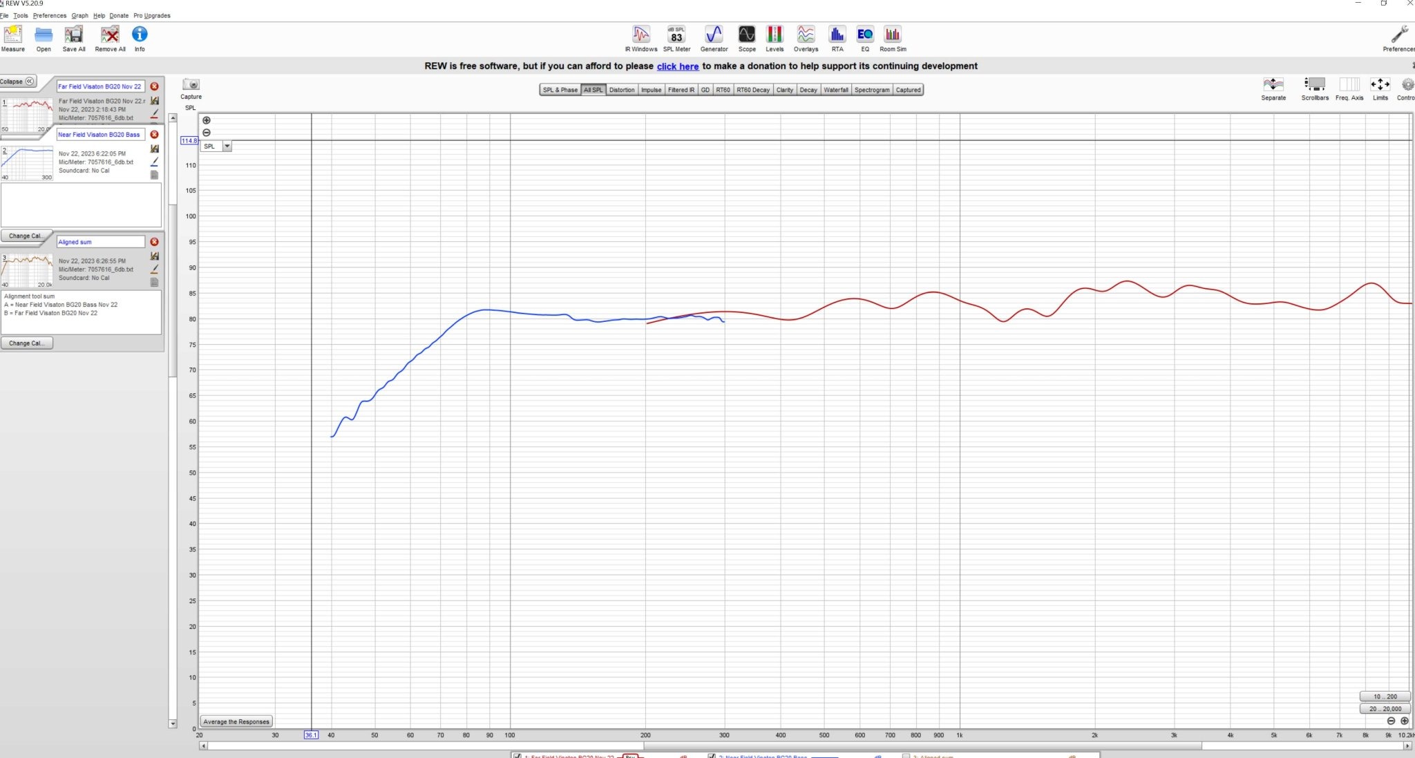

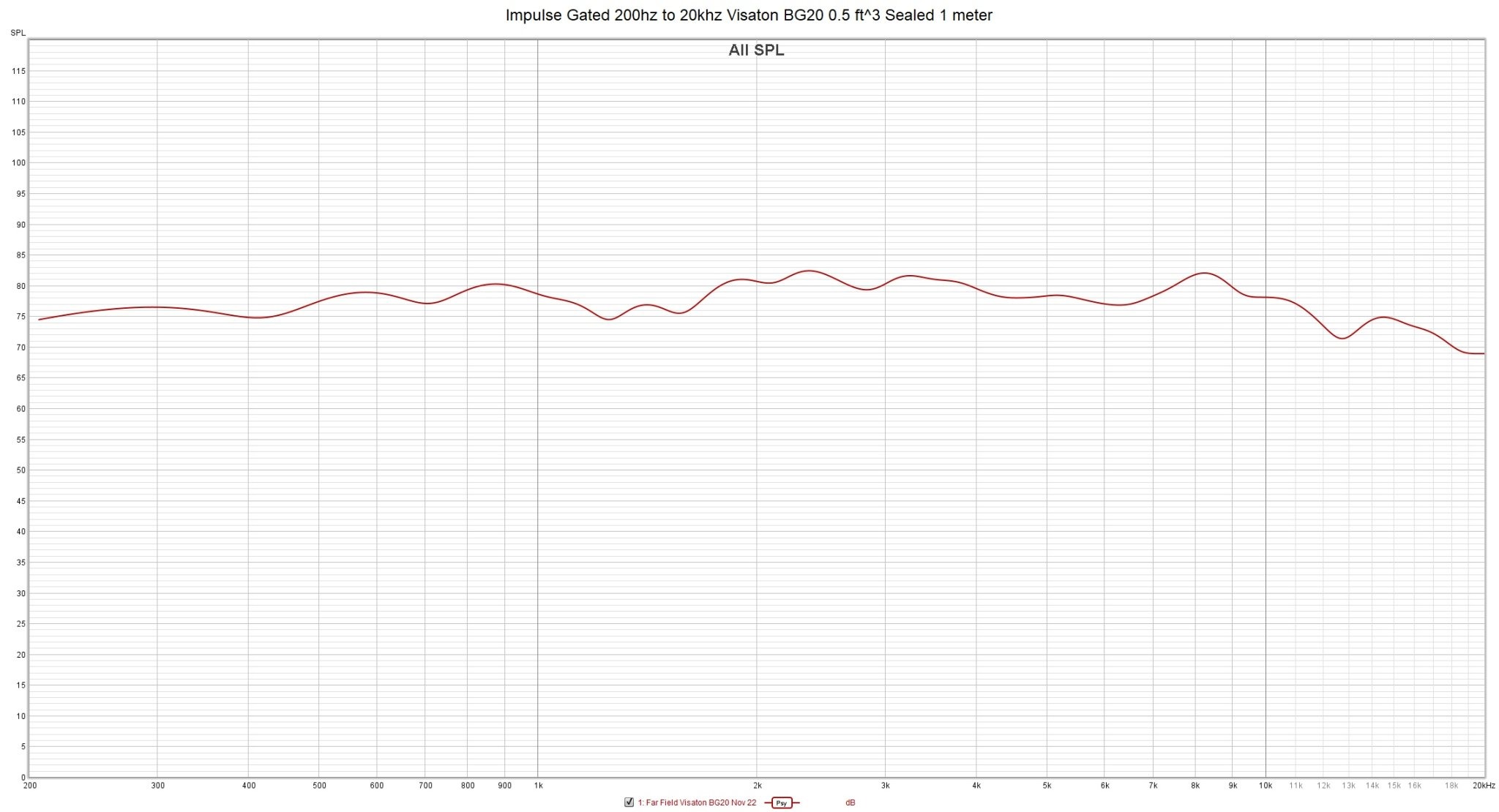

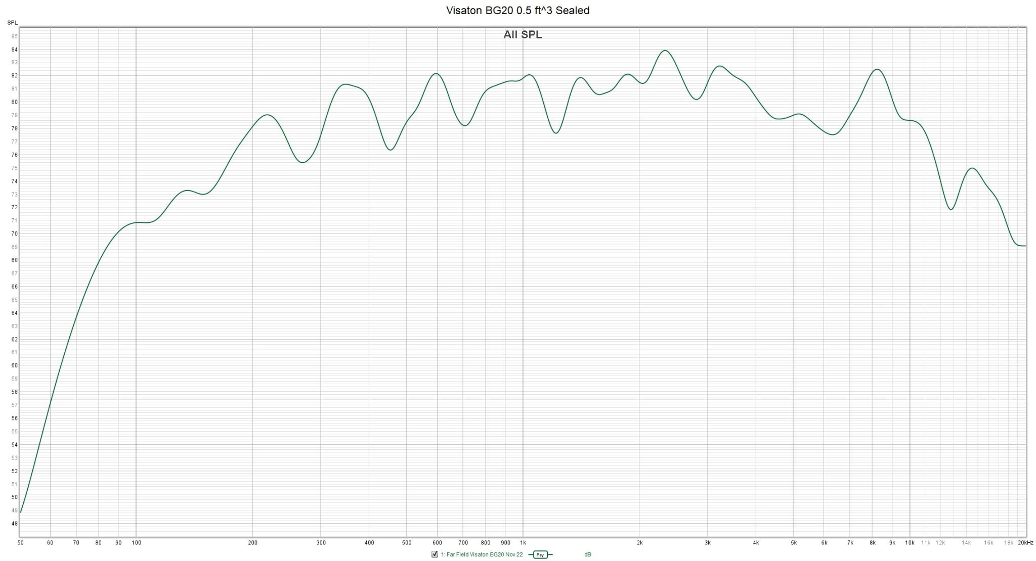

Frequency Response:

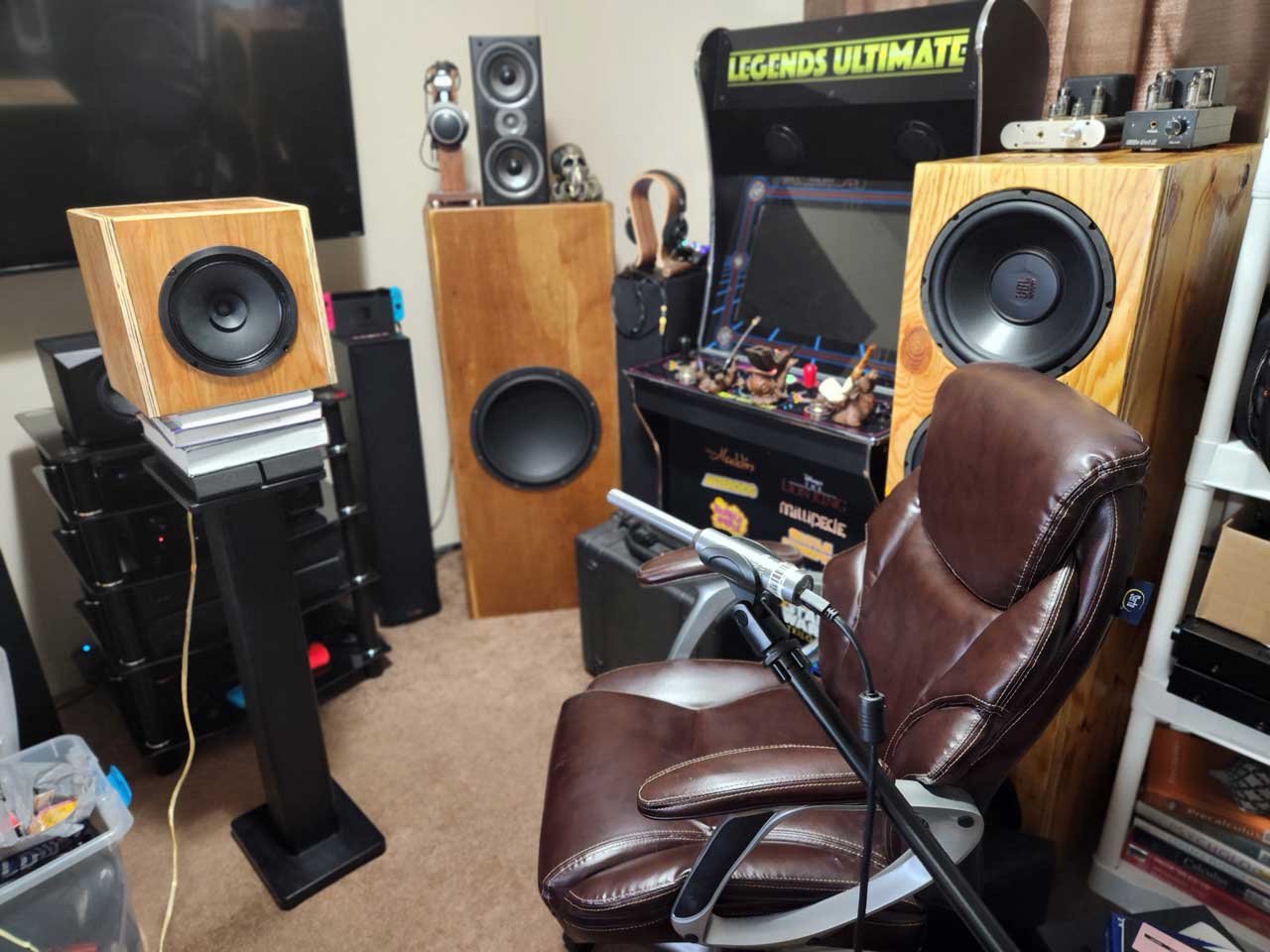

I set up for some far field measurements, not something I do often. I placed the driver center at the halfway point between my ceiling and floor (96 inches) and so the center of the cone is around 48 inches off the floor. I setup the microphone (Umik-1) at 1 meter distance from the driver center.
So the driver is 1 meter from the microphone for the direct wave.
The reflected wave will travel 1.3m reflect and another 1.3m to the microphone (2.6 meters).
So the 2.6m reflection minus the 1 meter direct wave is 1.6m
Speed of sound is 343m/s and if I divide this with my distance of 1.6m I get 214hz as being the lowest frequency I could potentially measure and gate to remove reflections.

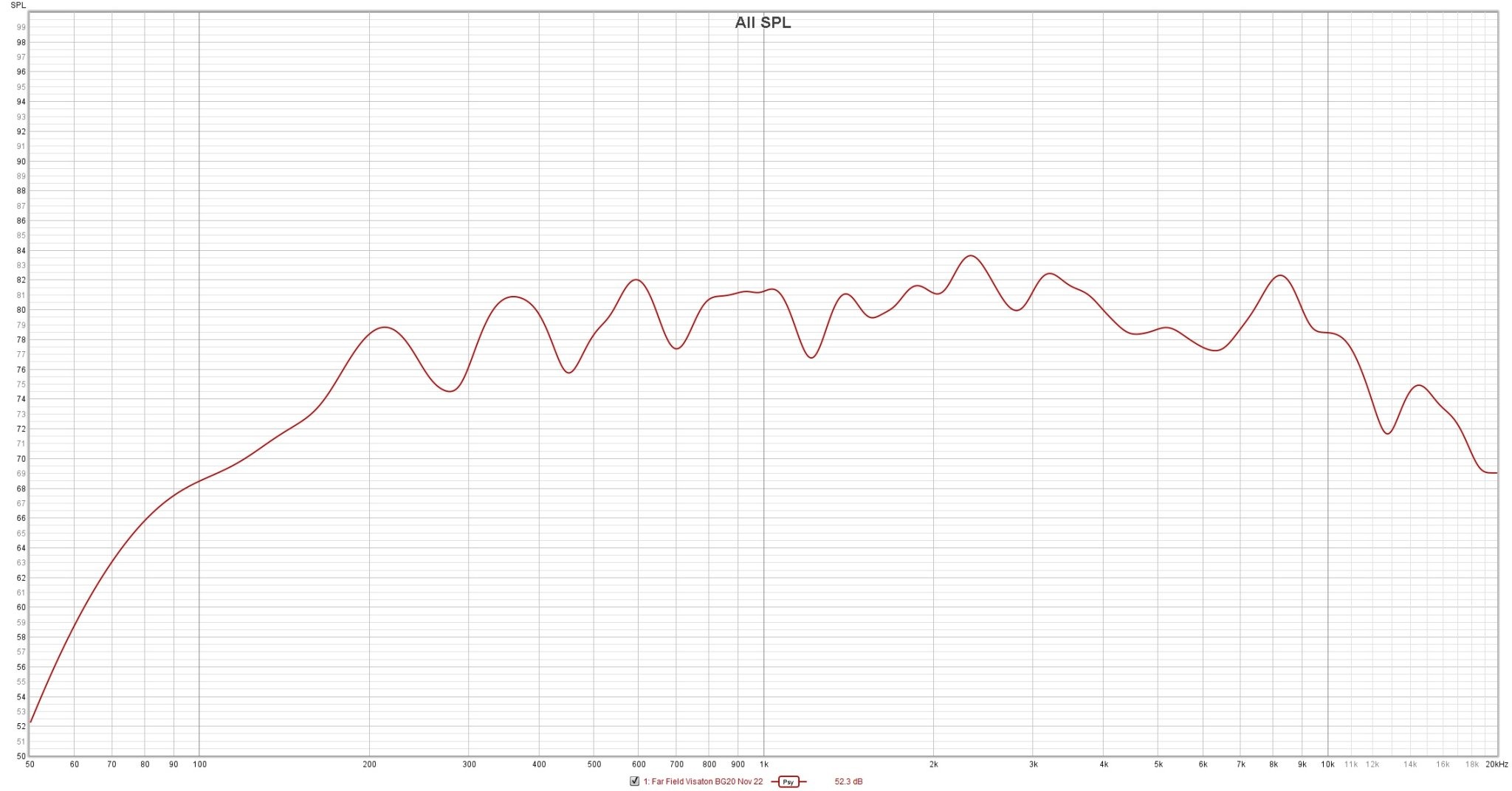

Here's the response, but no impulse response gating applied at this time and smoothed with psychoacoustic smoothing.
For now though, it rolls off as expected, mids are fine, treble rolls off heavily after 16~18khz as expected.
Here's the ungated response, far field, 50hz to 20kz, ugly:

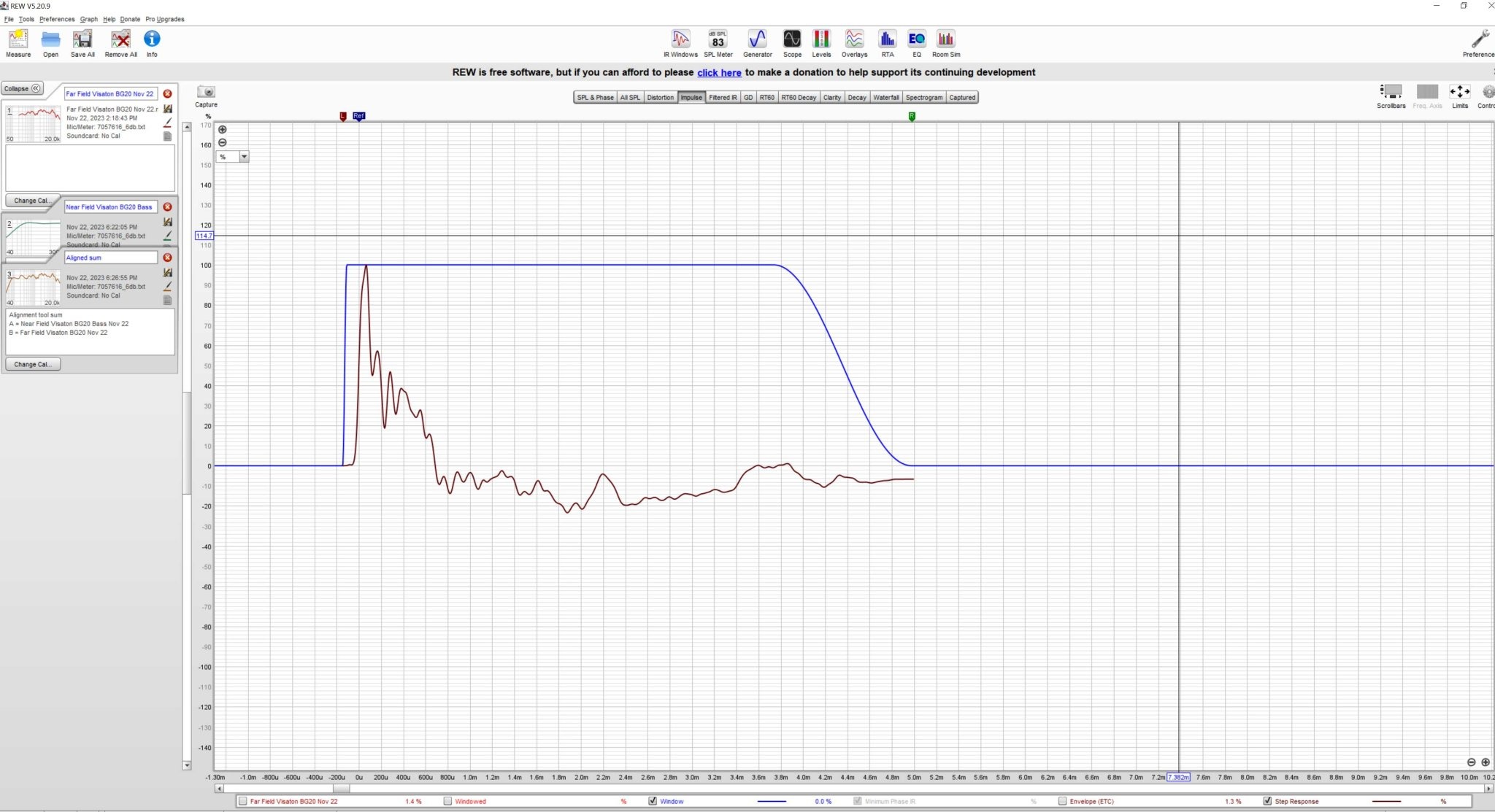

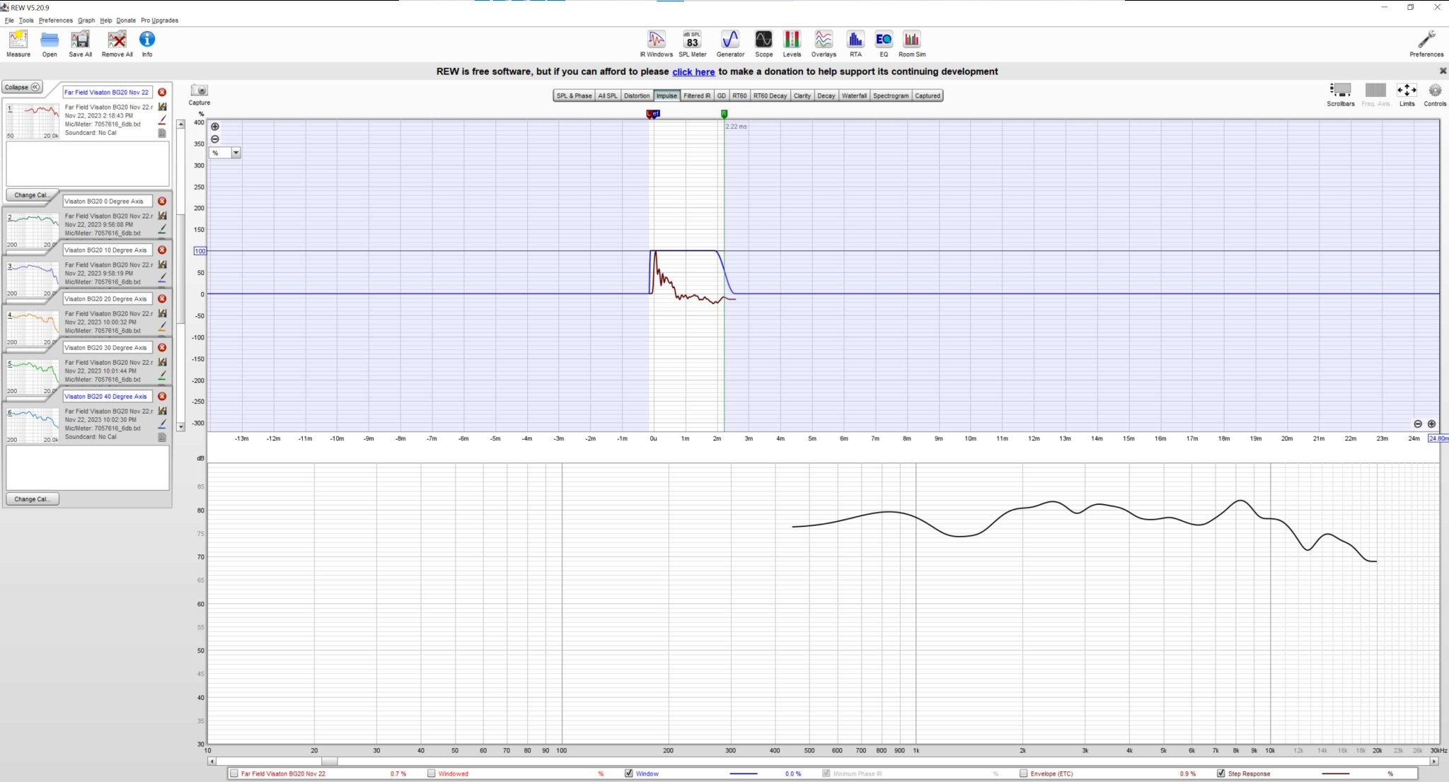

Working through impulse response gating:

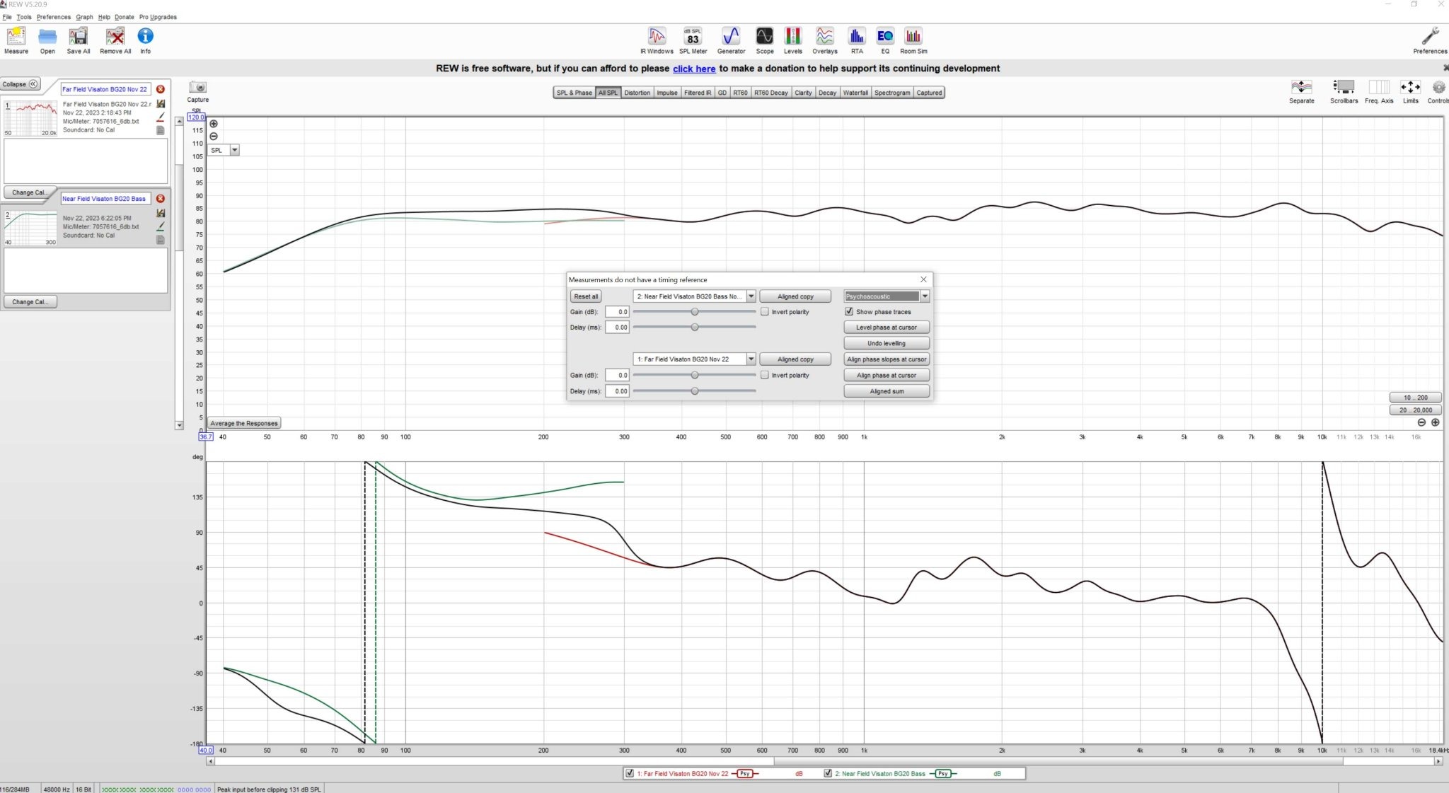

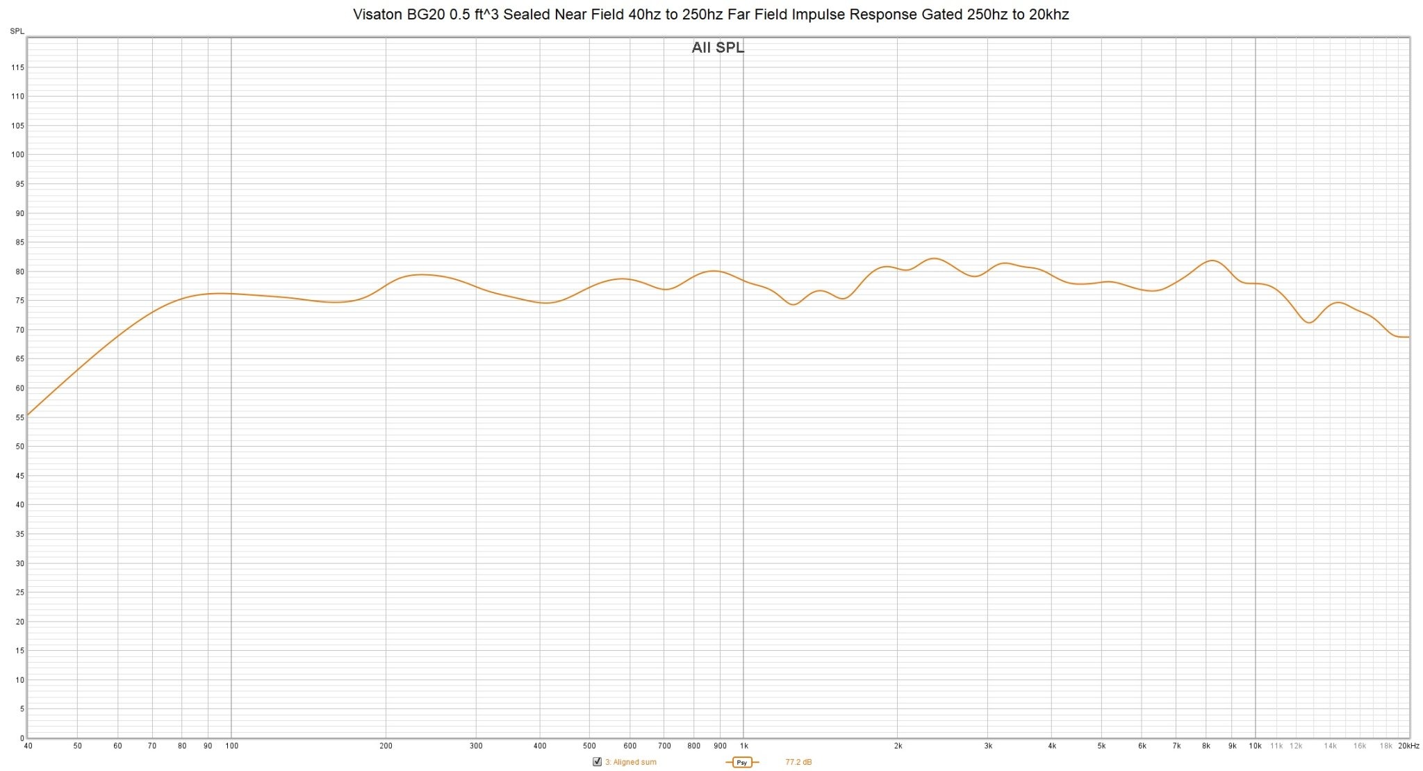

Gated response limited to 200hz (knowing 214hz is my lower limit that it would be accurate to via the calcs before):
Near field measurement, 40hz to 300hz. I will align around 250hz or so, above the lower limit of the impulse gated 214hz limit I calculated.
Aligned levels of near field to far field impulse response gated measurements:
Final response graph, if I did everything correctly. It's not purty and flat, but it shows what I need. I see the spike at 8khz as expected with this driver, the source of its brightness. The roll off is really closer to 80hz so the F3 is lower and this is great, this fully handles full range vocals of human speech. Variation is about 5db which looks ugly on a graph, but in reality it sounds fine.

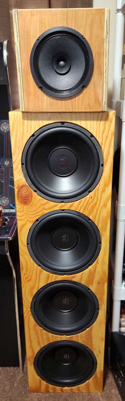

I have these in a stereo field at the moment and while I meant to put them up as heights or atmos, I'm totally happy with them listening to them as stereo and music. My Philharmonics are taking a small break while I listen to these for a while before I mount them up high and see how that is.

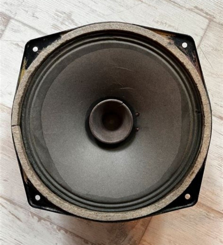

Yeah, when you consider that most popular music back then was mastered using Altec 604 Duplex systems, then tame the whizzer of a basic 8" 'FR' driver one piece curvilinear cone w/pleated surround and you've basically got a low power half scale 604My god, 70's rock sounds so good on these, despite not being anything special. It's like nostalgia or something. They sound a lot like how I remember these albums sounding back in the day.
That's an interesting approach for the BG20, well done!
Here is an example what can be done and is published by Visaton BG20 - pentaton-bb
For voices and smoother heights the much more expensive B200 would probably the best Visaton has to offer for a monitor.
B200 - monitor
Some people treated the whizzercone to get rid of the sharpness.
Put a foamring behind the whizzercone and imho some of the sharpness is killed.
In a DIY magazine I found it used with an extra magnet and they removed the whizzercone but also added a tweeter in a short horn.
Up to old hifi standard 5kHz the BG20 guitarspeaker does a perfect job for the price point.
Give the lady more room eg by using a TML or TQWT maybe even a BL horn and it really shines.

Could you post measurement with a 50 or 60 dB scale (50-100 dB)?Aligned levels of near field to far field impulse response gated measurements:
Thanks!
I tried to scale it as asked; it looks awful of course. I don't think I did the impulse response gating correctly or something, the ripples look like the ungated measurement; almost looks like a set of harmonics. Probably user error, trying to learn how to measure these things.
Compared to this one, which may be better, but still doesn't seem right. I may have to measure again.
Very best,
Very best,
The gating as you did seems reasonable.
As this is only one fullrange driver you could also try "farfield" measurement at 50 cm. Nothing axcept the mic should be near the speaker. The first reflection (floor?) should the be more clear then. Adjust the gating window to exclude this first reflection.
Thanks, I will try this again when I'm done with this work week. Not that I need to see a pretty graph, but I'd definitely like to learn to do this a little better.
Very best,

For fullranges I do measurement in 10 to 20cm distance to get the response of the box shape, too
So for that do you start at 10cm and pull back to 20cm and compare to associate the shape of the enclosure?
Very best,
No I mean something between 10 to 20cm measurement distance.So for that do you start at 10cm and pull back to 20cm and compare to associate the shape of the enclosure?
Very best,
To omit close mic effect disturbing measurement result.
And get the response of the baffle shape represented, too.
Multi way speakers are more difficult to measure because at wider measurement distance you measure the room influence.

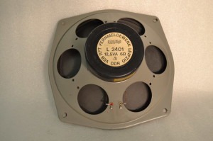

I once met someone who was in the production of these RFT goodies and he told me how they were fighting to get temperature resistant glue for the voice coil.
They did not have the patents for special glue. But could not get any from the west.
The voice coil former is made from paper so these 98db RFT3401 had only 10 to 20 watts power handling. Not more.
However I was listening sometimes with 100 watt peak power and they did survive. They measure up to 15k. Very good for 12 inch driver
You need more distance than 10-20 cm for that!response of the baffle shape represented, too.
