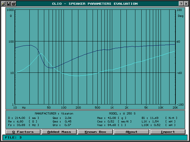

These are reasonably priced in Aus & good efficiency
anyone used them, or got any measurements?

It's a very well documented driver: W 250 S - 8 Ohm
It's OK up to about 2kHz from my estimates. You can model it too: Downloads
The only aspect that you might consider is that it has a pressed steel chassis. If you want a less coloured cast chassis, look around for stuff like this: H1305-08 CA26RFX

re:"look around for stuff like this:" - if only SEAS drivers were available locally any more... freight for big drivers to Aus is a killer for a tightwad like me, & I prefer to source locally.
Looking for some serious woof, 2x 8" SB might be more effective, or I might throw caution to the wind and buy a couple of cheap 15"ers
My mids will be the last of the pre-chinese 5" Peerless 850488, & Peerless tweeter from the same era, really nice low distortion drivers

Pete,
I had them measured once. Decent and simple drivers.
Have to see if I can come up with some more plots.
Lojzek, did you use delta mass or delta compliance test for generating TS parameters ?
- Visaton W250S
