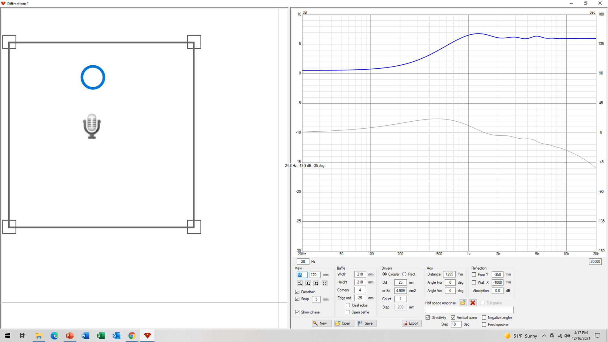

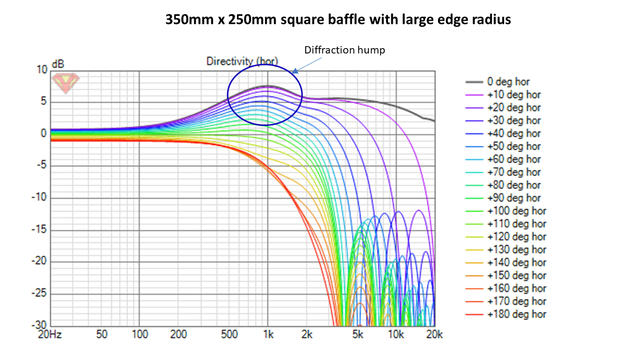

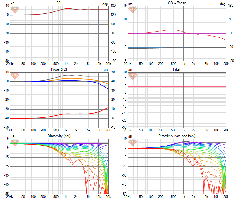

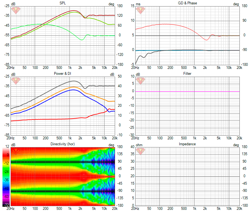

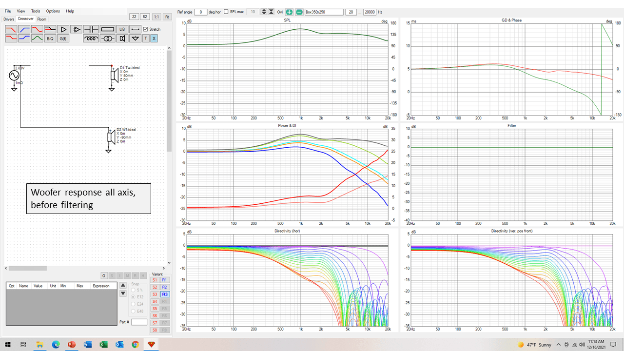

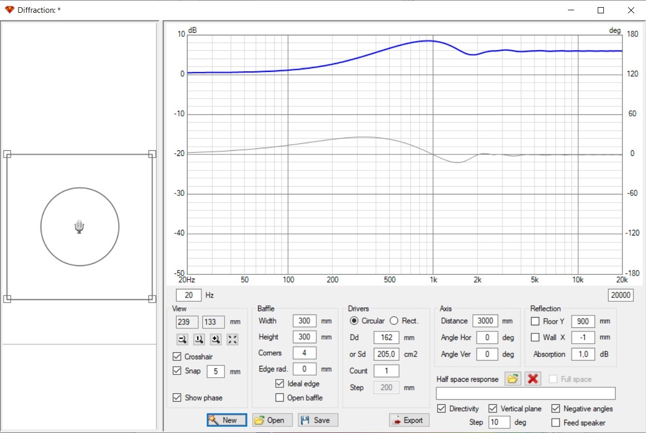

To start with, I will show a simulation I made about 6 months ago, as I was learning to use the full capability of VituixCad2. This is a simple rectangular baffle, 350mm x 250mm (approximately 14" x 10"), with a large edge radius. The drivers are a 6" woofer and a 29mm tweeter. They were positioned on the baffle as close as they can be (taking into account the mounting flanges). I did not use simulation to optimize the positioning. The driver responses in VituixCad are ideal responses, flat from 0 Hz to infinity. Since I am using active filter elements, I don't need to worry about impedance or sensitivity considerations, this is exploring and modeling the acoustical response of the drivers in a box.

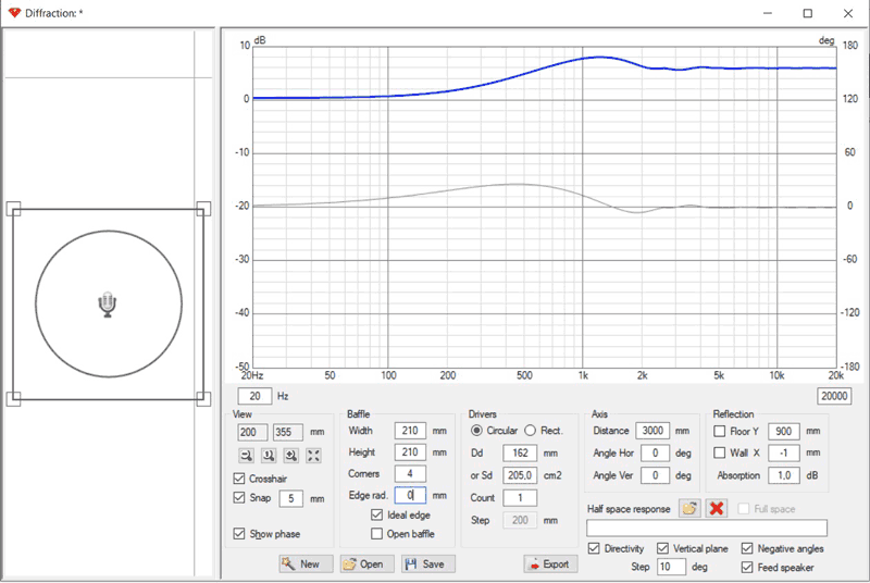

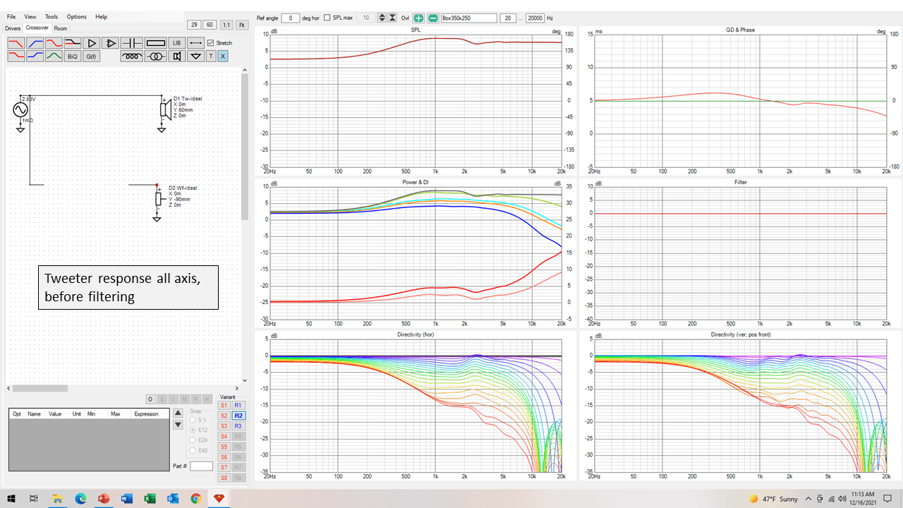

Graphics 1 and 2 show the Vituixcad diffraction tool, and how it models the woofer and tweeter responses. The horizontal and vertical responses (0 - 180 degrees) are exported, and then used in the main VituixCad crossover application. Graphics 3 and 4 show the tweeter and woofer responses of the drivers in the box... in other words, VituixCad is taking into account the diffraction at all angles from 0 to 180 degrees.

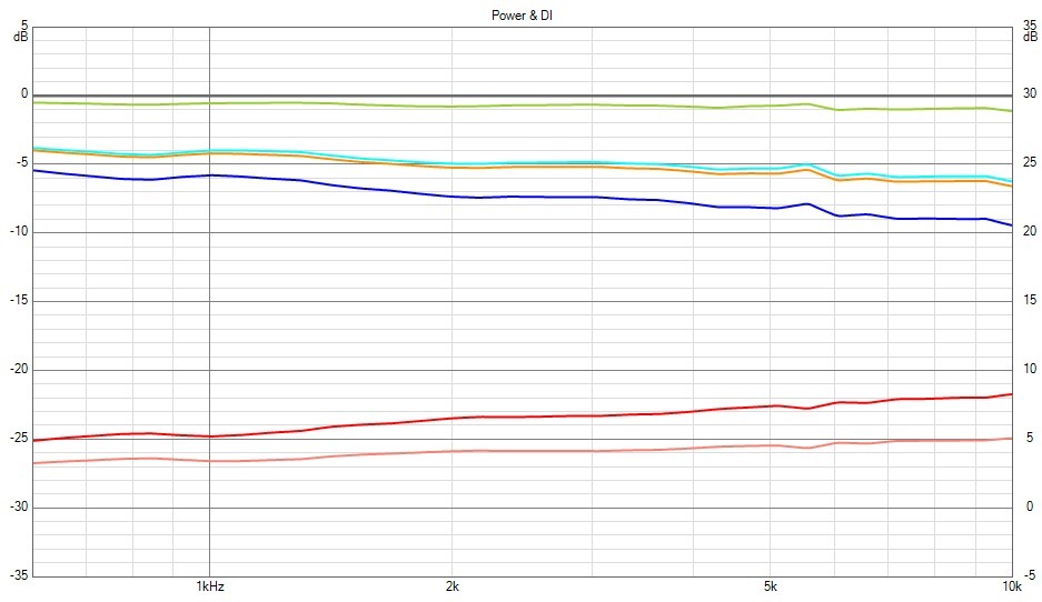

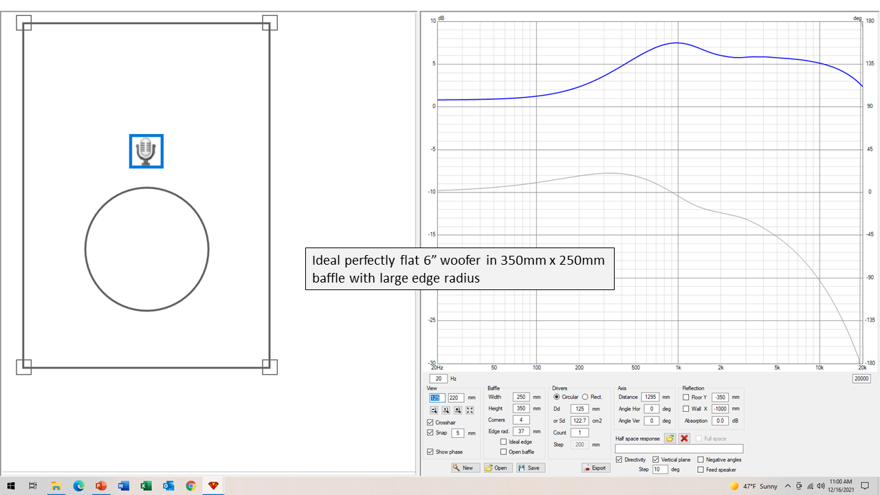

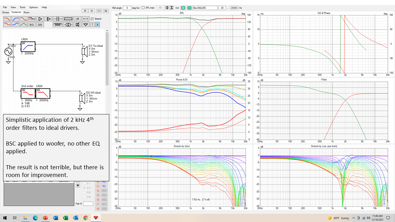

Graphic 5 shows what happens if I simplistically apply a baffle step compensation to the woofer and then slap on an LR4 crossover at 2 kHz. Since these are perfect ideal drivers, this should work out fine, right? eh, not so much. The result is not terrible, but it could definitely be improved. The response is not flat on-axis, and since we are starting with perfect drivers, a flat on-axis response should be achievable. There is a dip in the sound power curve and the ER curve, and this makes the DI and ERDI curves non-smooth.

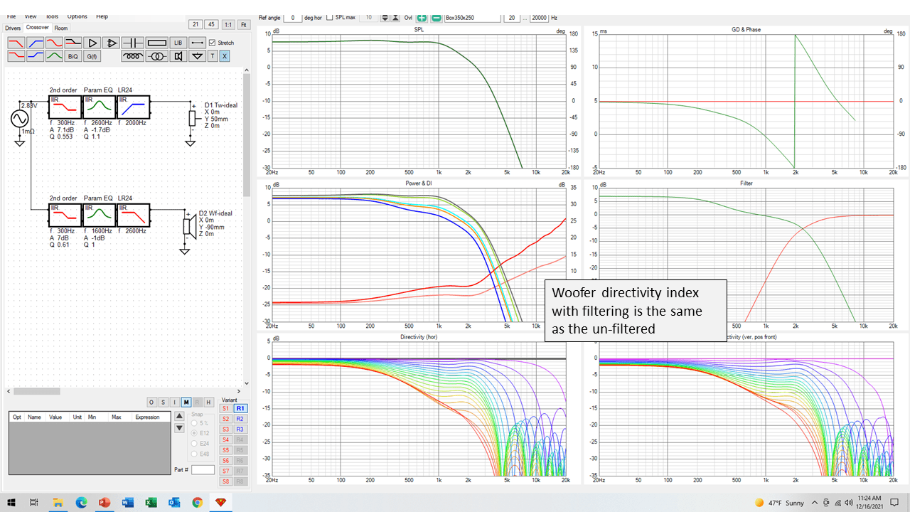

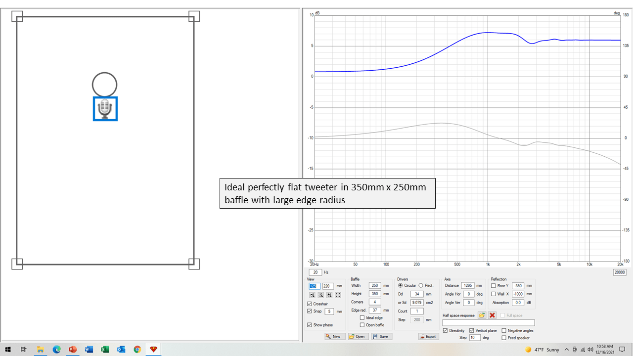

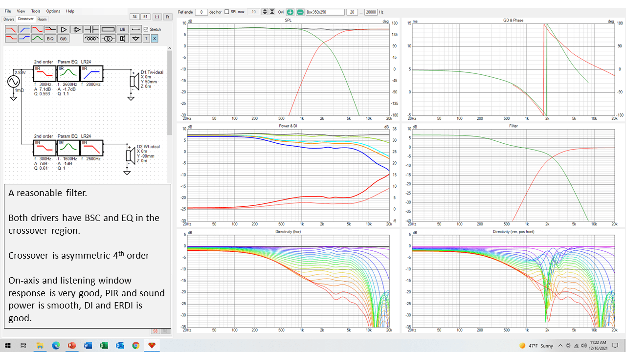

Graphic 6 shows a reasonable filter for this situation. I do not claim that it is the best that can be done, but it was the best that I could do 6 months ago :).

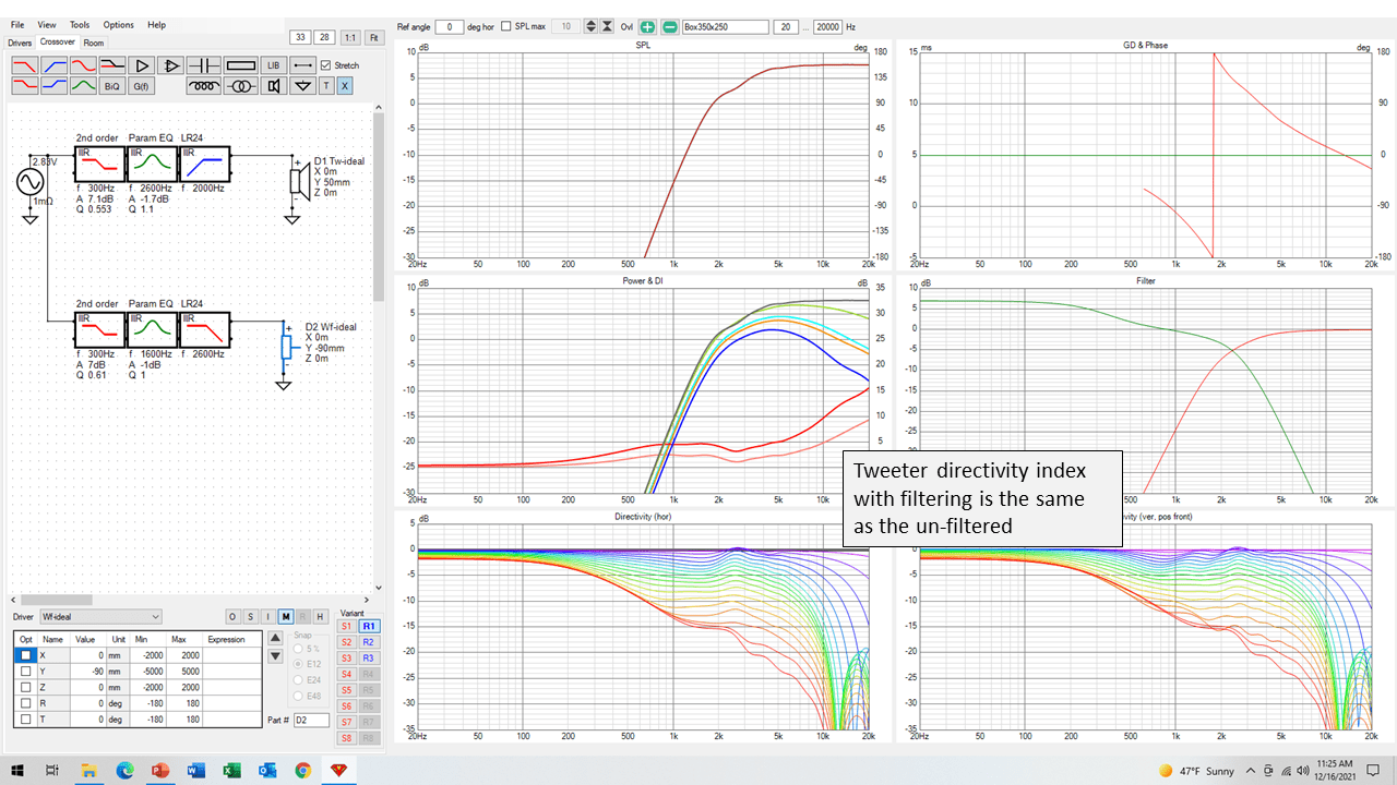

Graphics 7 and 8 show the woofer and tweeter responses including the filtering. What is interesting is that the DI curve with filtering is the same as the DI curve of the raw driver... i.e compare graphic 7 with graphic 3... and compare graphic 8 with graphic 4.

In answer to Turk182, I would consider the above baffle as one which is difficult. I did other sims where I moved the woofer and tweeter around a bit, but it did not make much improvement. The problem with this baffle layout is that it forces the designer to use a crossover of about 2.2 - 2.5 kHz. The woofer in particular has a slow roll-off, it is down by -10 dB at 3k, and a mere -18 dB at 4k. It limits my choice of woofer to those which are exceptionally well behaved at high frequency. My usual preference with a 6" driver would be to have a crossover in the 1.5k to 1.8k range... and be down by about -20 dB at 3k.
An easy to work with baffle would be one which will work for a variety of crossover frequencies.

I have found that the location of the "diffraction hump". When crossing from a mid to a tweeter, the size and location of this hump is important. If the crossover is within the hump region, it will be very difficult to achieve both a good on-axis and good power response… in other words, a smooth DI. A wider baffle causes the hump to be lower in frequency.

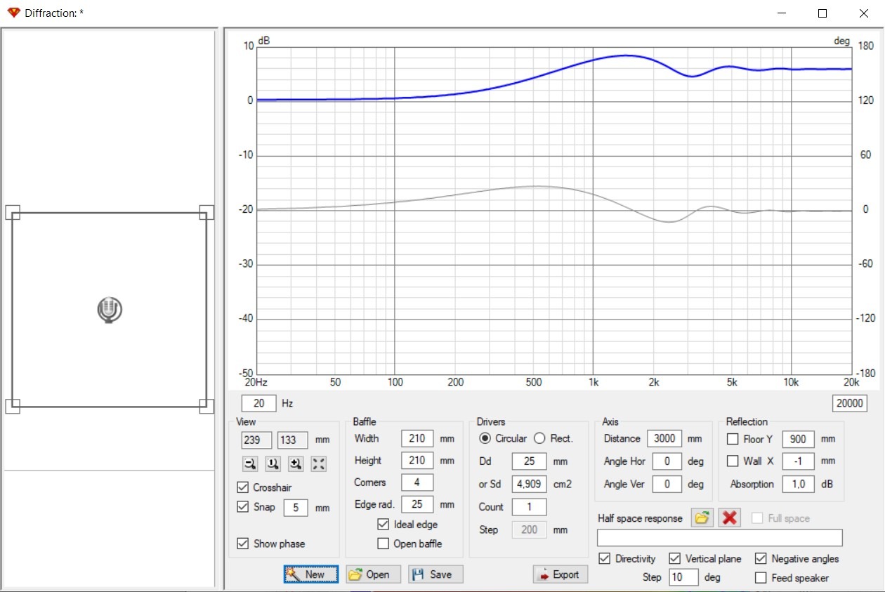

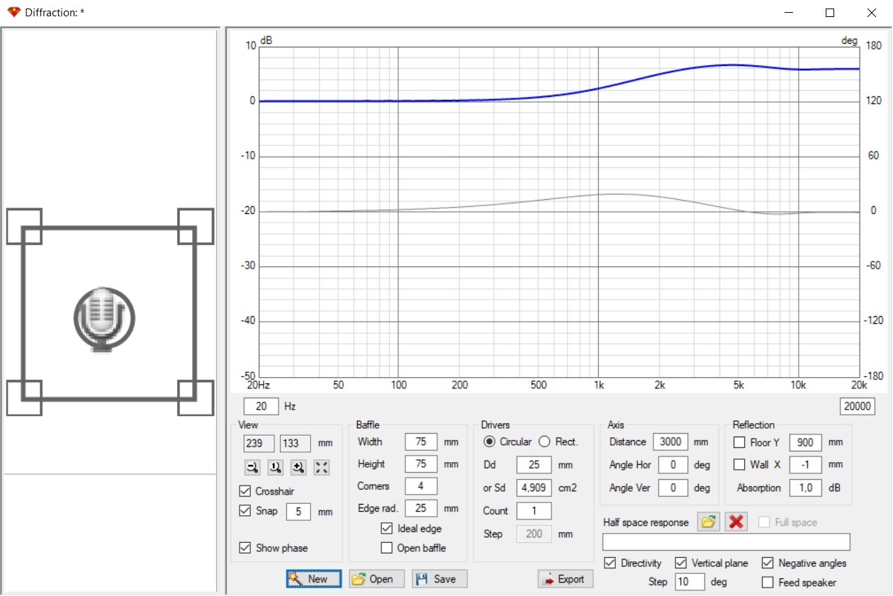

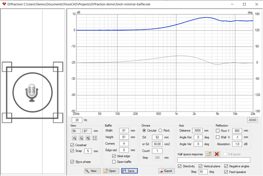

Here is my favorite insight and experiment / demonstration with VituixCAD diffraction tool I've post many times in various threads :) Relation of transducer size to the baffle and how the diffraction is affected and what kind of round overs help.
Basically the observation is as follows: To have least amount of diffraction interference in a loudspeaker response, for practical size speakers, one should minimize flat baffle around any driver. Minimizing baffle means baffle should not have too much flat around any transducer. If there are round overs or slants they should start immediately beside the driver frame, for most effect.
Here is some text to support the claim, before attachments.
Basically, baffle edge diffraction happens on frequencies that are sufficiently short in comparison to the baffle size. Long wavelengths just don't "see" the baffle and go around it, this is the baffle step. Wavelengths sufficiently short in comparison to baffle size will diffract at the baffle edge. Diffraction creates secondary sound source at the baffle edge (all around) which combines with the direct sound at the listening spot creating interference pattern, peak(s) and dip(s) on axis and the inverse somewhere off-axis. Now, any transducer will start beaming on wavelengths that are roughly shorter than the transducer size. This means that when there is transducer on a baffle there is less and less sound going to the baffle edge as frequency goes up. This leaves us a bandwidth of frequencies that diffract at the baffle edge and causes interference pattern easily seen. The problematic bandwidth low end depends on the baffle size and the high end on the transducer size. To minimize the bandwidth where diffraction (interference) happens we need to bring the baffle size to transducer size and that is all we can do because we need the transducer anyway. A minimized baffle.
If anyone remembers Olson papers which demonstrates diffraction properties of various enclosures might remember a sphere diffracts the least. This works here with baffle edge round overs. For round overs we cannot have minimal baffle (enclosure), the baffle has to extend some from the driver rim in order to fit the round over (or slant)! But as we start to widen the baffle in order to put our round over the diffracting frequency bandwidth extends lower in frequency and kind of escapes the rounding. When the round over radius approaches and goes beyond the driver diameter the baffle starts to resemble a sphere and the diffraction almost goes away. The sphere needs to be substantial in comparison to driver size to fully mitigate diffraction. Basically, we cannot get rid of diffraction completely but we can address it one way or another that is suitable for the application at hand and within limits of budget for example.
Here lays the nugget for speaker builders: there is no need for round overs or slants if you just keep the baffle minimized. No round overs are necessary for pretty good diffraction performance, there is the main hump but not much interference after that! However, any round overs help any baffle if you can fabricate them but the effect is not very much in comparison to just using minimal baffle with no round overs at all. Most of the time we cannot make minimal baffle for each transducer, because there needs to be multiple drivers on same baffle that is sized according to the largest one! Or the inside dimensions of a box behind the baffle need to be something that demands bigger baffle than the driver. Anyway, food for thought for the designers :)
First attachment is VituixCAD demonstration, a GIF that shows 8" ideal driver on minimal baffle and what happens as round over is introduced to the baffle. Watch how the baffle step gets lower in frequency as round overs get bigger (all frames are with no flat baffle around the driver, round over starts immediately side of the driver) and almost nothing happens to the main peak until the round overs approach the driver diameter. Some minor diffraction interference is seen above the peak around 1kHz when there is no round overs, just minimized baffle area, pretty nice for no extra labor at all! 1" round overs cure this minor ripple but do nothing to the main peak, basically on a 8" driver effect of 1" round over is very miniscule on frequencies where an 8" driver is used.
I have no idea if difference on any of these frames in the GIF is audible or not on finalized system with crossovers and other drivers in place, probably not too much difference. Biggest difference would be to wide baffle without round overs, where the diffraction ripple goes wild pretty quick when the baffle edge gets further away from a transducer, in relation to the transducer size!
8" driver on ~12" baffle is not too bad, dip appears after the hump, worse than on minimal baffle:
But 1" tweeter on ~8" baffle has pretty nasty diffraction, as the baffle size to the transducer size is big, the edges are relatively far away from the transducer:
The big peak seen in the response around 1kHz, above baffle step, is not a problem most of the time as is. It shows on DI for example, but rather easy to live with and most speakers have it anyway, possibly strategically positioned crossover in mind as Hifijim mentions. Unless big spheres or perhaps dipole / cardioid variety where the power is cancelled with the baffle step and relationship between the hump and on axis response is rather constant = constant DI, but such systems have their own intricacies.
Here is another GIF, same demo for 3" driver to demonstrate the phenomenon is relative and applicable to tweeters and any sized woofers as well:
For 1" tweeter 1" round over with minimal baffle is pretty effective, almost sphere!:
Problem is when the 1" driver is on 8" baffle due to big woofer on same baffle. Then 1" round over helps but some diffraction remains since the baffle supports tweeter much lower in frequency all the way to the crossover and the round overs would need to be closer to the woofer size to be effective, basically start right at the tweeter edge, no flat baffle for least diffraction interference. It is all relative to wavelength, baffle size and transducer size:
Dimensions for the demos are from Faital pro 8pr155 and 3fe25 but any drivers you can get hold on would show similar results. It takes few seconds to try this and see the effects. Project attached to get anyone started with their own experiments.
These are simplified demos and don't include effect of the whole box or nearby boundaries or don't claim what is audible and what is not, or what is easy to build and what is not. Main thing is to get insight how diffraction is related to physical objects through wavelength, the relationship between sound and physical world!
edit. Hifijim's previous post mentions "the diffraction hump" and how it affects to DI on a real system, and might make passive crossover and overall system response hard to achieve. I'd like to think the hump itself is not audible, just makes a hard crossover perhaps forcing to push the hump lower in frequency by widening the baffle, which in turn would begin to introduce more diffraction interference as demonstrated above. Perhaps we have a demonstration for the effects of the hump to practical systems with crossovers at some point :)

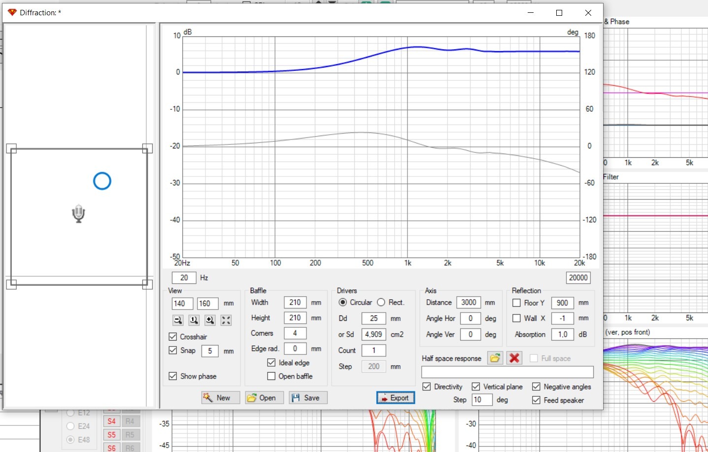

I tried to put the tweeter in a position that shows least humps and dips on the diffraction tool graph and then exported the response to main program:
While it is much better than middle of the baffle, the effect is still seen around the 1-3kHz and to get rid of it massive round overs would be required. Conversely, small round overs won't have meaningful difference.
At the end, minimizing the interference would be reasonable thing to do what ever options there is for given project. Worst thing would be to leave diffraction completely ignored never considering it at all. While no one gets injured if there is diffraction, some one who wants very good sound could not afford to overlook it I think. This is linear distortion what mr. Geddes talks about for example https://www.diyaudio.com/community/threads/geddes-on-distortion-perception.121253/.
Anyway, all this is quite easy to experiment with VituixCAD to give better chance for good sound emerge in any project!

However, if you take your sim to the next step, and place a 5 or 6 inch driver on that baffle (taking into account the tweeter flange which is likely about 100 mm), you may find it challenging to come up with a good crossover filter... or maybe not... I have learned that it is very difficult to tell in advance which baffle configuration will be successful... you have to go through the effort of simulating the crossover.
In my post #13 I ignored the size of the tweeter flange. This is an "impossible" configuration because any reasonably sized tweeter flange would over-hang the 25 mm radius along the top, which would mean the top edge would have a much smaller radius in the area closest to the tweeter. I should have checked this before posting.
Tmuikku's post #15 is a legitimate simulation because he is using an edge radius of 0, so the tweeter flange would just fit on the baffle.

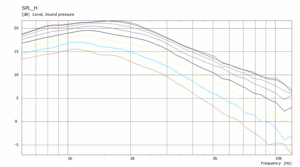

Regarding waveguides: yes it is of course true that a good waveguide will control the directivity of the tweeter. But VituixCad does not simulate waveguide responses at this time. VituixCad simulates direct radiator responses. And the subject of this thread is VituixCad simulations. So I do not know where waveguides fit into this discussion... ??
Great discussion !
Vituix doesn't natively simulate waveguides but the data from other programs or measurements can be imported and added in to an overall simulation.
For example this ABEC simulation shown in VACS can be exported as text and imported into Vituix. I made a script for renaming the files to the Vituix naming convention to automate the procedure. It's not perfect and I have never worked out why the phase is all wrong (probably my fault) but the magnitude works very well.
