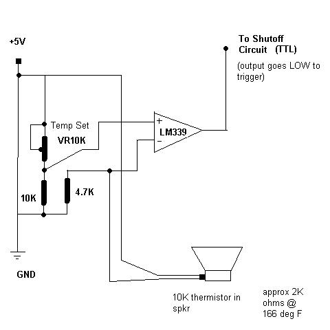

Schematic for VC protection
Here's the schematic for the Voice Coil temp protection.
I based it off of a safe temp of approx 166 degrees F and the specs of the Thermistor. The circuit is nearly identical to the one inside the Amplifier that protects the outputs/heatsink from overheating, just set to a different temp.
