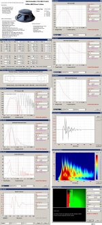

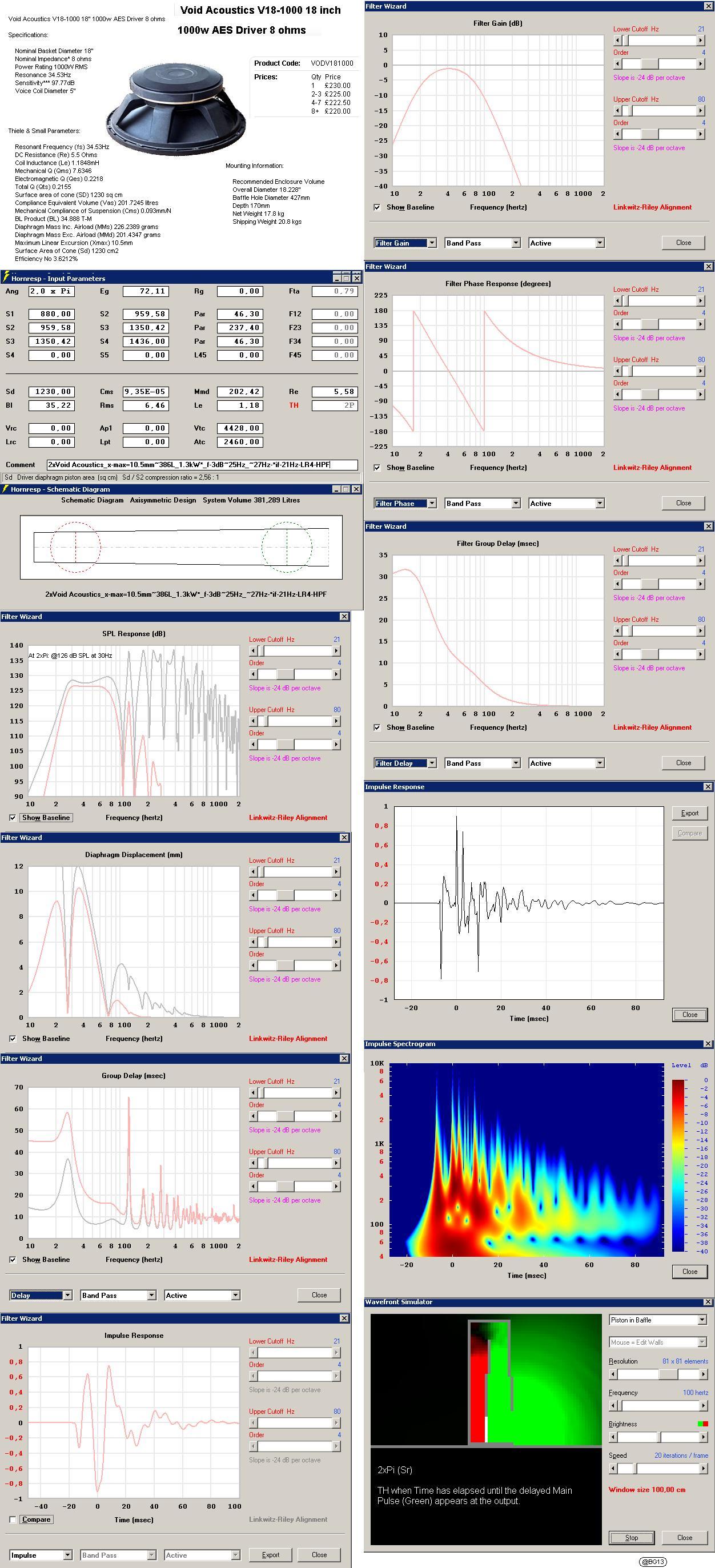

Dub-Sub
A Dub-sub suggestion:
Place this preferably only single folded TH(See the Picture) ~5-5.5 m in front of the Main Speakers if no signal delay is in use. If placed at a wall =1xPi (Sr) for >130dB SPL performance at 30 Hz, the sub must be used with conjunction of a signal delay for the Main Speakers.
IMO: Dub-Sub requirements:
Cross brace all the internal Air-ways using 18mm high grade Birch Ply and brace further by using >= 1” rounded Dowels at every feet of the internal section lengths. Cover at least the first third length of the internal walls counted from the throat with >= 1/2” Cotton Felt.

Nice! Could almost serve as a HT sub.
What do the impulse response and spectrogram mean, compared to what you can hear in real life?
