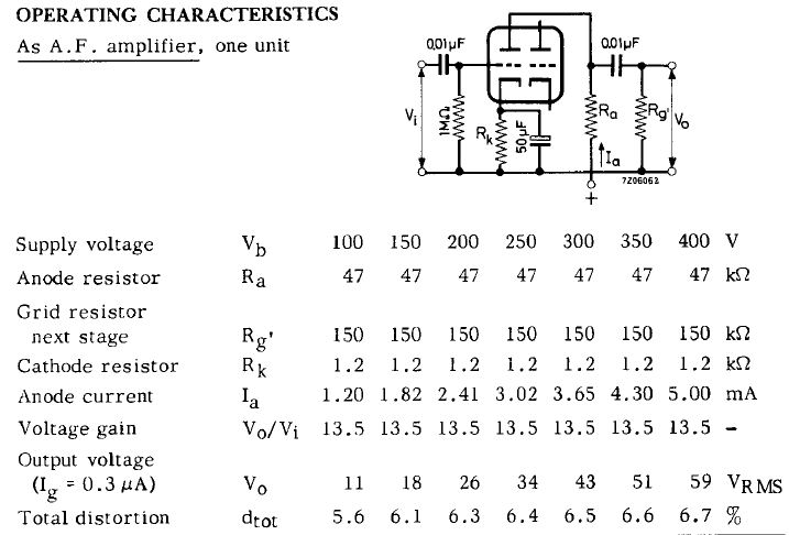

Hi guys, Ive been banging my head in it for a few hours and I was wondering, can I calculate the components around the tube based on the gain I want. Everywhere I looked, the calculations for the gain at the very end where Ive already determined all the components and cant change anything anymore. I have an ECC85 and I want it to have a gain of 10. You can say it wont see any load because the next stage I plan on bootstapping and itll have >1Mohm impedance. How can I do the calculations?

Easy, look at the Philips chart.Except that ECC82 /12AU7 still has too high gain.
NFB or voltage divider is required to get gain of 10.
If you take away the cathode decoupling (50µF) the gain is 10x and less distortion.

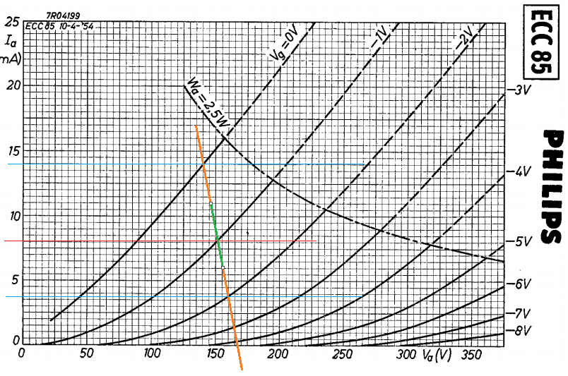

Graphical methods can be useful sometimes. Just for fun, I drew in a load line that yields 10X gain centered on Va=150 by stretching it across the zero and -2V grid lines where they cross Va=140 and Va=160. That load turns out to be about 1.92K, which puts B+ voltage at 166V for 8mA of bias current. The green line represents anode excursion for 1Vpp input, and you can see from its unequal length on either side of the operating point that some distortion will occur. A hotter operating point would yield less distortion. Does that help?
