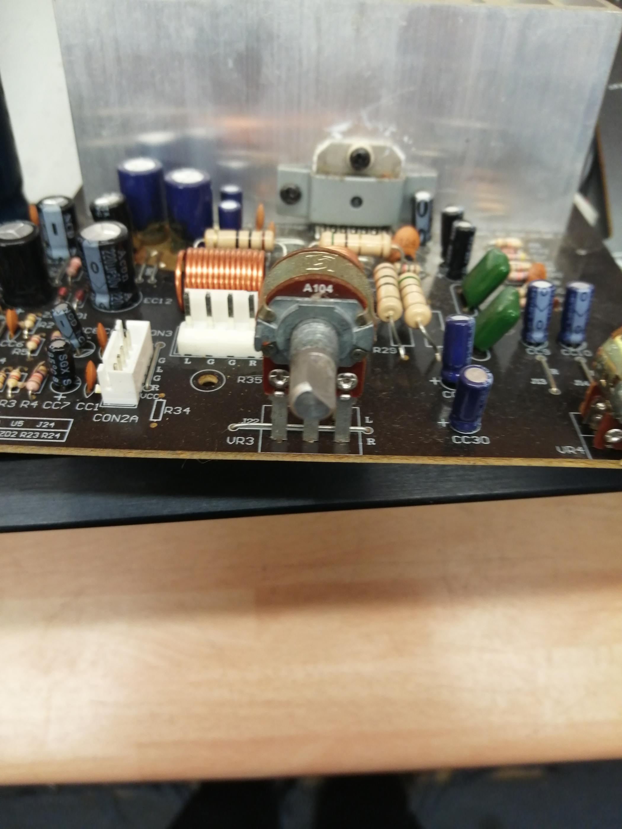

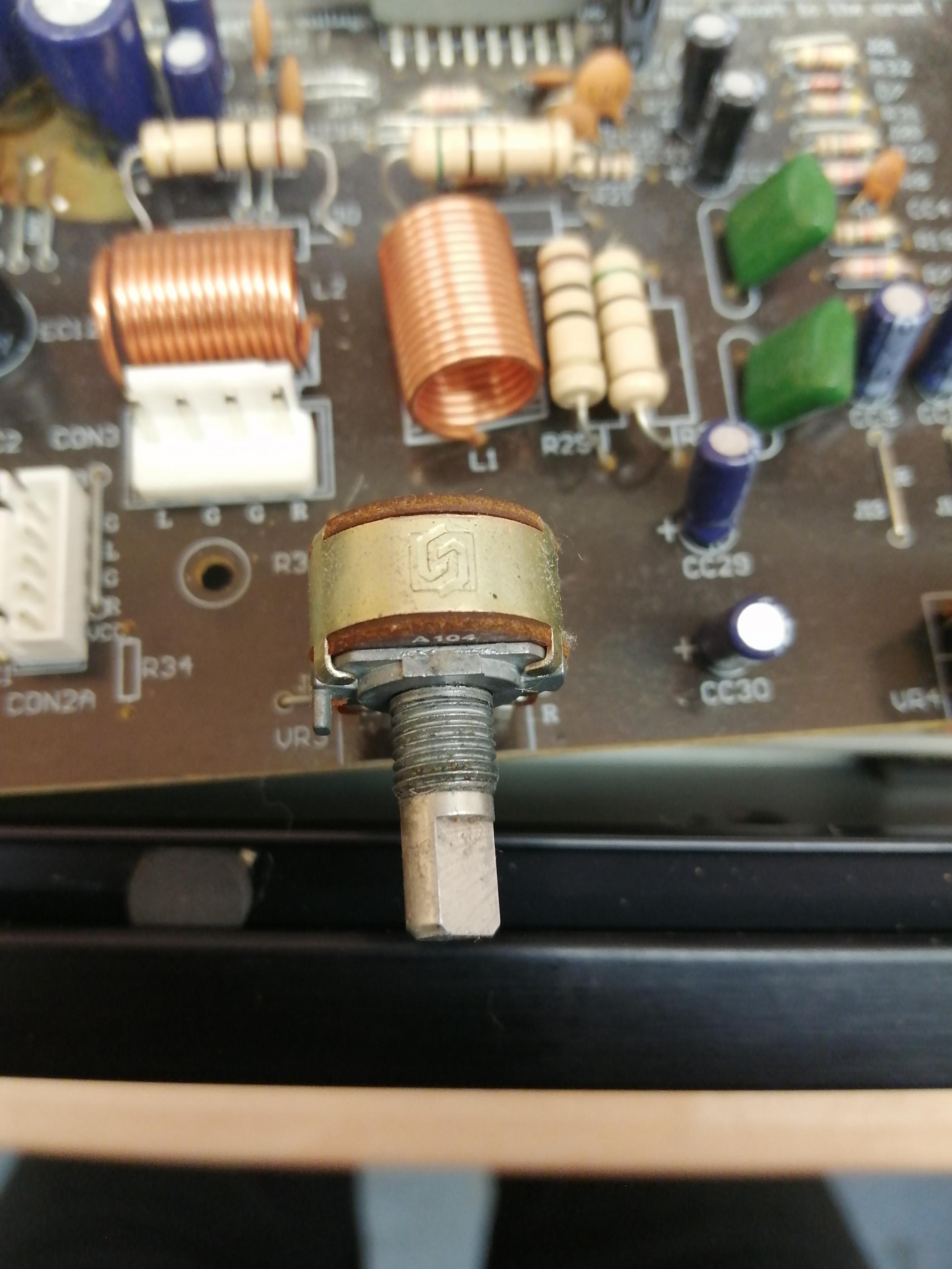

The mechanical part of the volume potentiometer on my Cambridge Audio A1 Amplifier has broken, and I'm currently trying to see if I can superglue it back together etc, but I'm not sure this will be successful, so it may be better/safer to purchase a new one.
I don't have a schematic so can't check what value it is, but hopefully the attached pics may help someone more knowledgeable advise what part I need to buy.

I think the A denotes it's logarithmic, and the 104 means 10 followed by 4 noughts, so 100K resistance. And it's dual operation.

It may take some searching, but it should be possible to find a replacement. The biggest challenge will be to find a replacement that'll fit mechanically. If everything else fails, you can probably fit an ALPS RK097 in there and hook it up with wires.
A104 is indeed 100 kΩ, audio taper.

Does anyone know who has made the component in my pictures by looking at the manufacturers symbol on top of it?
I can't see VR3 listed on the parts list from the materials list. It's probably just listed under of one of the boards.
This might help me track down the exact thing - so I don't get anything that is mechanically shorter, or doesn't align correctly.

In which way is the pot currently broken?
You may not need an exact match, though that would be nice. If it fits, you could upgrade to an ALPS RK271 "blue velvet". Mouser has them... As does RS.

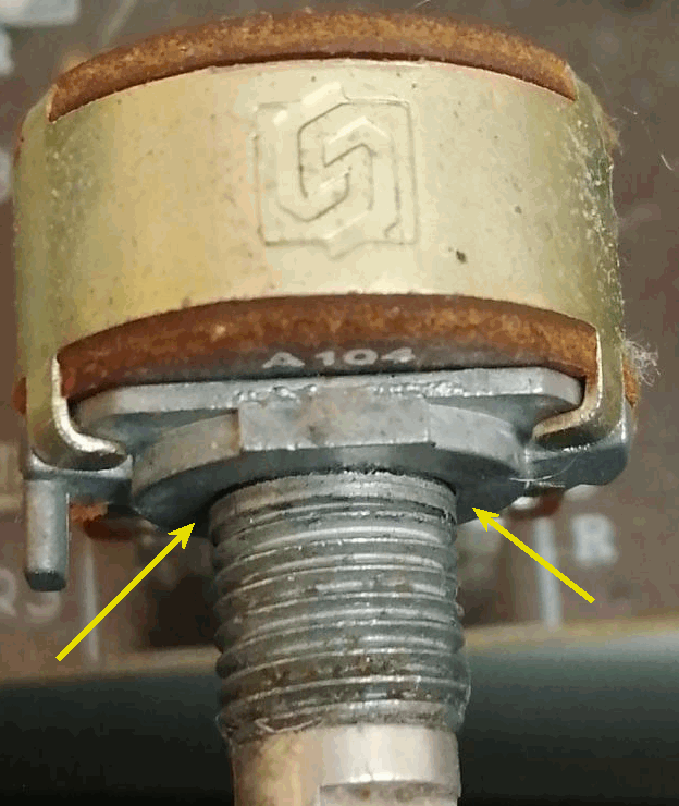

In which way is the pot currently broken?...
I don't know, but my eye thinks the bushing is busted from the flange.
Correct. Nothing wrong with your eyesight.
I've stripped it completely down and superglue it back in exactly the correct orientation, then a tiny bit more each side. Today I will try and reassemble it. The fun will be getting the sliders and knob in the correct orientation to the markings on the front panel, and not disturbing the sliders too much during assembly.

I got the potentiometer back together, and in the correct orientation etc, but once some force was applied to the locking nut that holds it in place the superglue didn't hold, so back to really wanting to replace it.

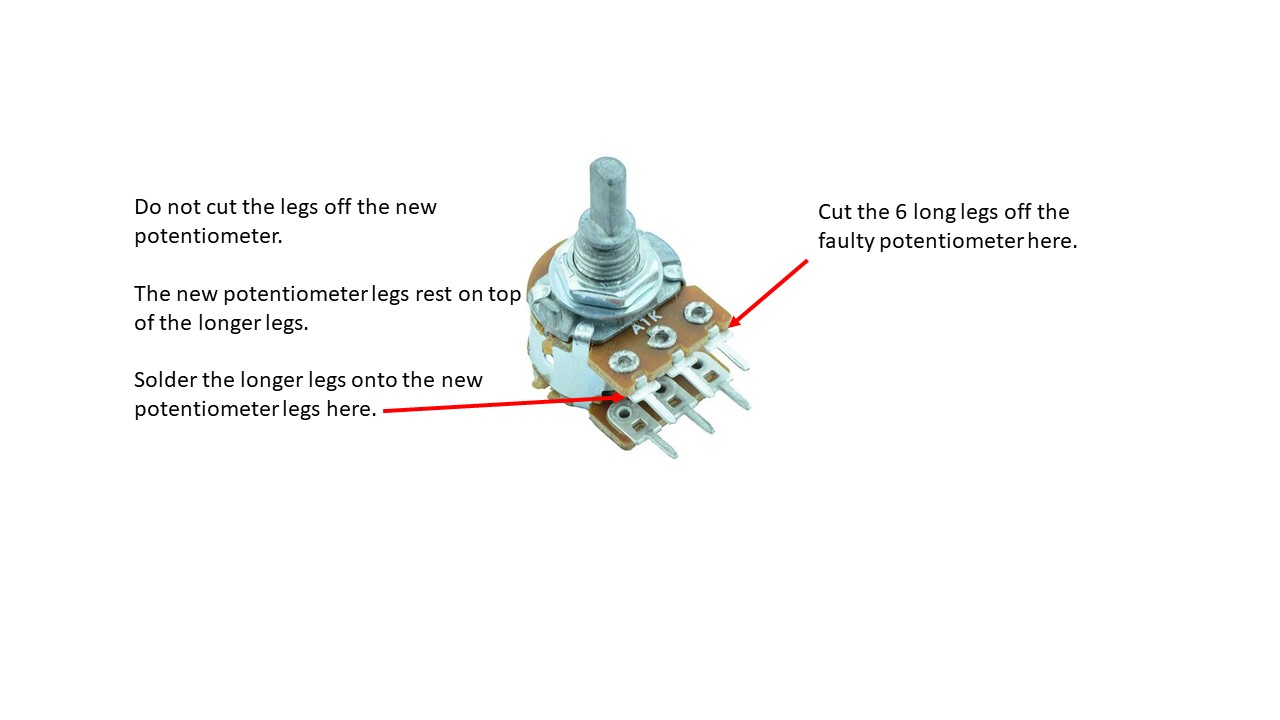

This is the potentiometer you require.
100K Logarithmic Stereo 16mm Potentiometer D Shaft | Switch Electronics
The faulty potentiometer has longer legs and was supplied to CA as an OEM part so unavailable.
You will need to cut the 6 legs off the existing potentiometer and solder them to the new potentiometer this will ensure exact alignment when refitting in terms of height from the tone board to the front facia location hole.

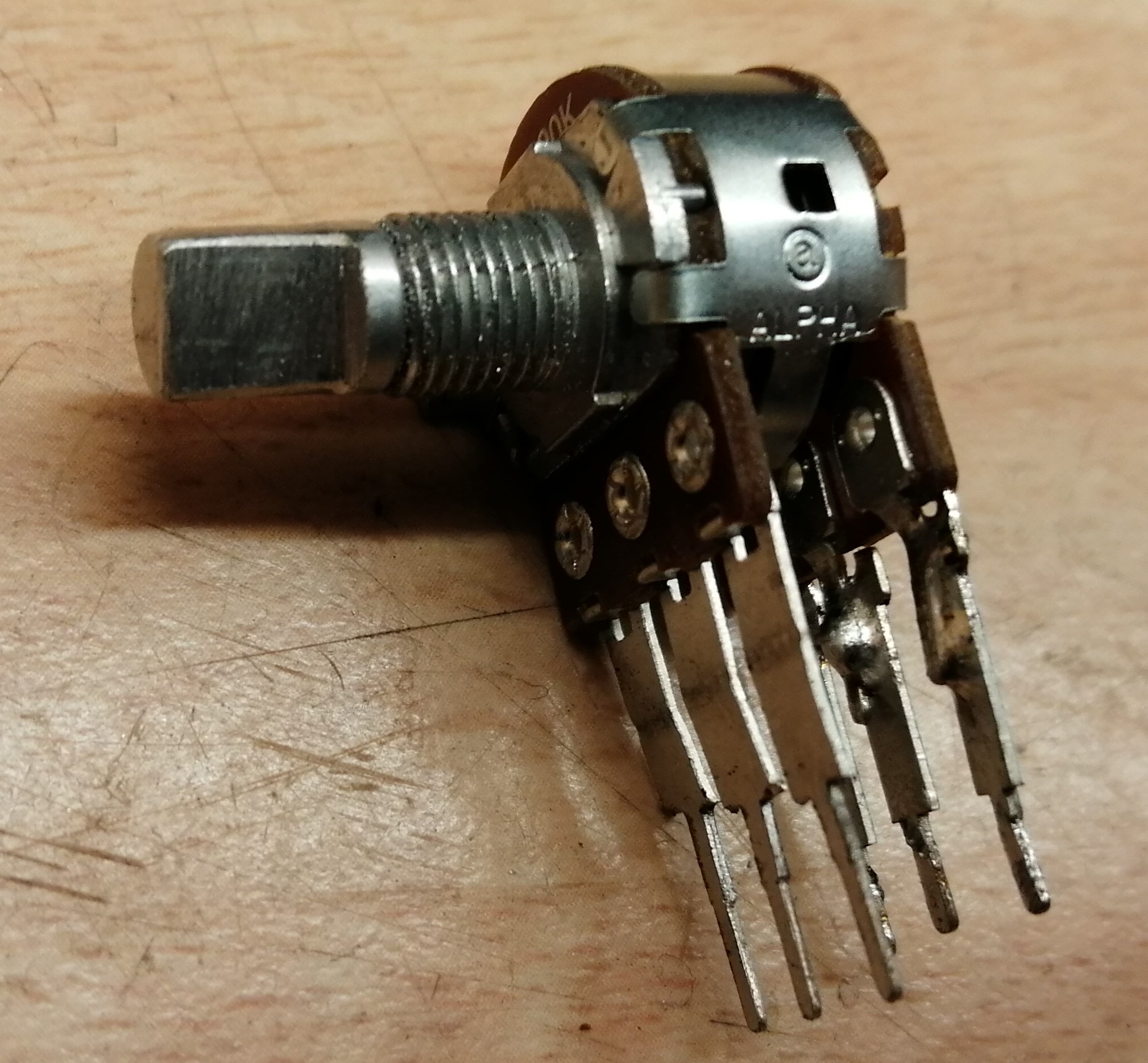

It's fixed 🙂
Please see pics below.
The first two pics are the original (broken metalwork) potentiometer, the next pic is the two different potentiometers I ordered (I used the Alpha VR63ST), then the original below the new one I'm going to use, then the new one modified, then lastly the modified new pot on the board.
I probably should have spent more time to find exactly the same one as the original, but I spent a fair bit of time, and when I did find (for sale) what I thought was correct it would turn out to be linear, a different resistance, or different mechanically (especially the shaft shape - D shape required). In the end I found a 104K dual logarithmic with the same shaft and mounting dimensions (roughly) , but a round shaft rather than a D shape made by Alpha (VR63ST) - on Ebay. However to get this to work/fit, I had to bend and shorten the long legs, solder the old long legs on the rear 3 (shorter) legs, file a flat (in the correct orientation) on the round shaft, and file the round shaft down from 6.3mm to 6mm to get it to fit.
This was quite a bit of work, but the good news is electrically and mechanically it looks good, and more importantly works.
