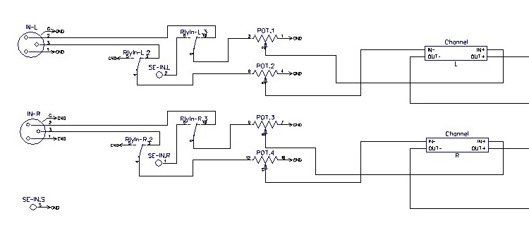

I need to insert a volume potentiometer in the following diagram. How can I do? IMG-20181211-WA0002.jpg
We still need to know how you plan to use this.
Single ended = easy = standard dual gang volume control wired conventionally. This is the normal way most amps are configured.
Balanced = more difficult = quad gang pot (for stereo) or you fit a conventional control upstream before your audio becomes balanced.
potenziometro volume
guys I reiterate: I'm in the process of creating two separate stages ie two monoblock cases and then there will be a volume control for each monoblock. This volume must act indifferently if I connect to the balanced input or to the single RCA input
that's simple
wire ballanced attenuator in front of amp (practically being between input XLR and inputs on pcb)
wire RCA to XLR pins 1 (GND) and 2 (Hot+)
feed it wit balanced signall - OK
feed it with unbalanced signal , put shortie between pins 1 and 3 of XLR - OK
I can't just immediately think of a way that can done.
If you want balanced then you have to arrange the circuitry for that... so far so good... but then to use it unbalanced and you still have the balanced set up configured and active. I'd have to give that serious thought and work it through tbh.

The relevant graphics have disappeared from site.
Does anyone have a wiring diagram for a two gang pot to control the volume for one XLR input, or for a four gang pot for two XLR's?

Are you trying to produce two separate balanced outputs ? That can be achieved with normal two gang pots, one per channel.
Otherwise you will need a four gang pot. These are available.
I've just finished an Aleph P1.7 balanced pre-amp with an ALPS 4 gang pot controlling the volume.
It's even easier if you look at switched ladder attenuators. You can stack as many switches as you need.
24 steps is fine, if stepped correctly
I'm finding it just proper with step of 2db , in my Iron Turtle AVC
though - I don't have good experience with these ready-made attenuators from ebay - switches are not good enough for audio purpose, after some time you can expect all sorts of problems, loosing contact being just first of them
though - I'm using similar/same 24step switches (two sections in parallel) for commanding relays in AVC, but I'm opening them and putting some grease on contacts, and it does wonders....... and then they're switching just DC, around 12mA
This might help. The relays are used for switching between balanced/unbalanced and ground the - signal when in unbalanced mode. You could use a 4P switch for this. Pots used for this application included an Alpha RK2142 and a TKD 4CP601. The Alpha pot is surprisingly good given its low cost. Not easy to find in the US however.
