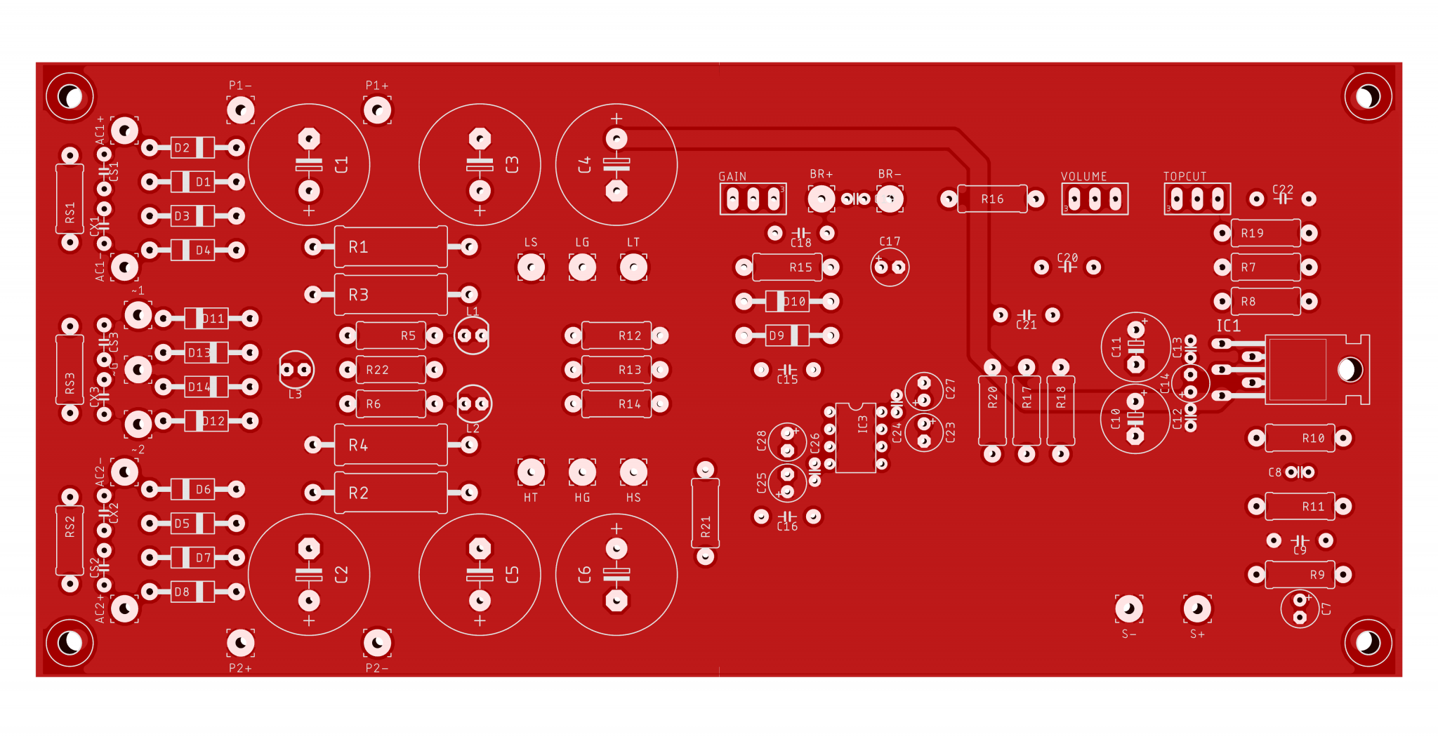

That's my second ongoing small guitar amp project after the Fender Champion 40.

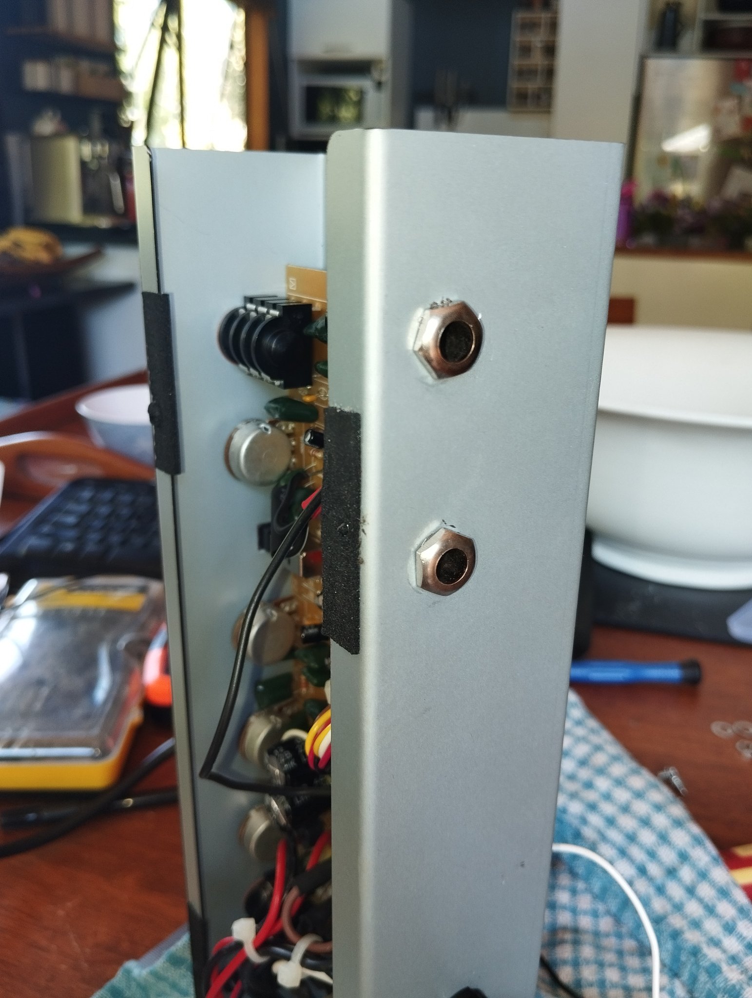

[✔] Add a 1/4 jack to allow connection to a CAB. This is super easy and very straightforward.

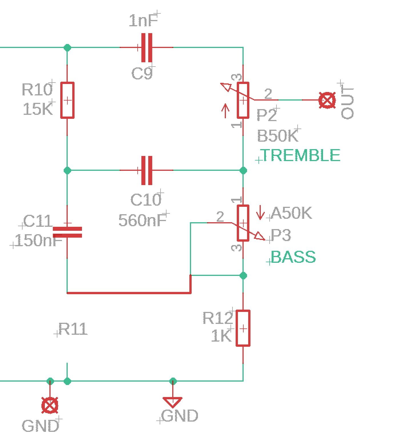

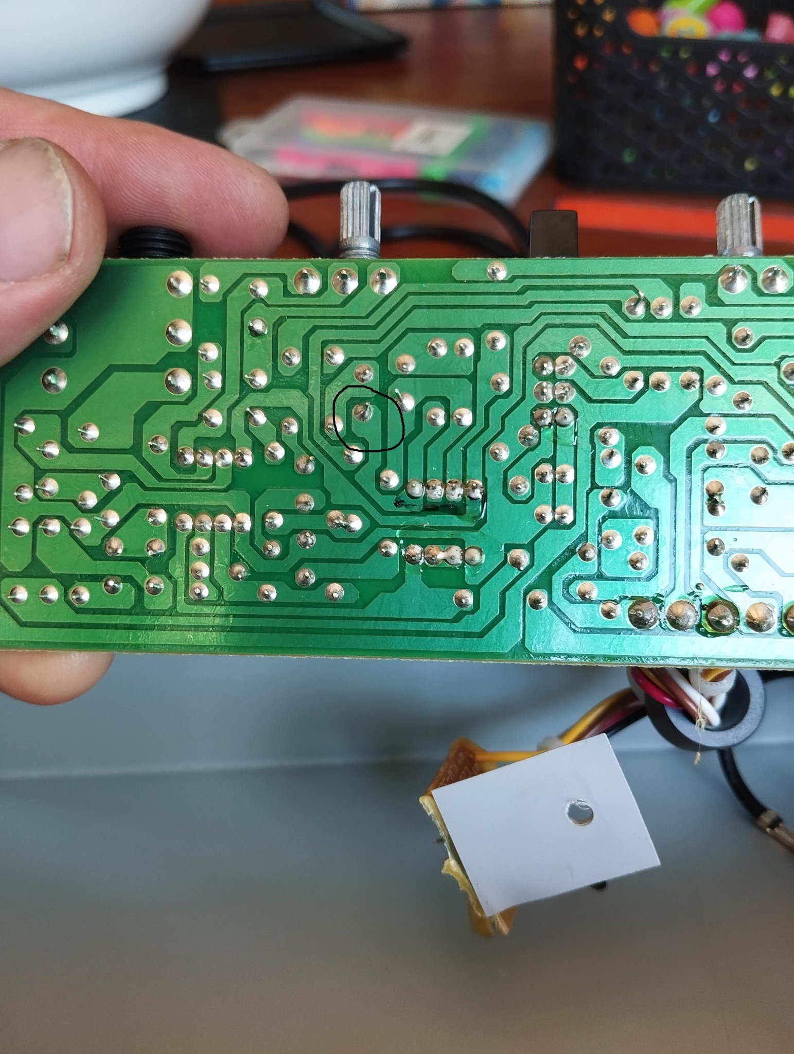

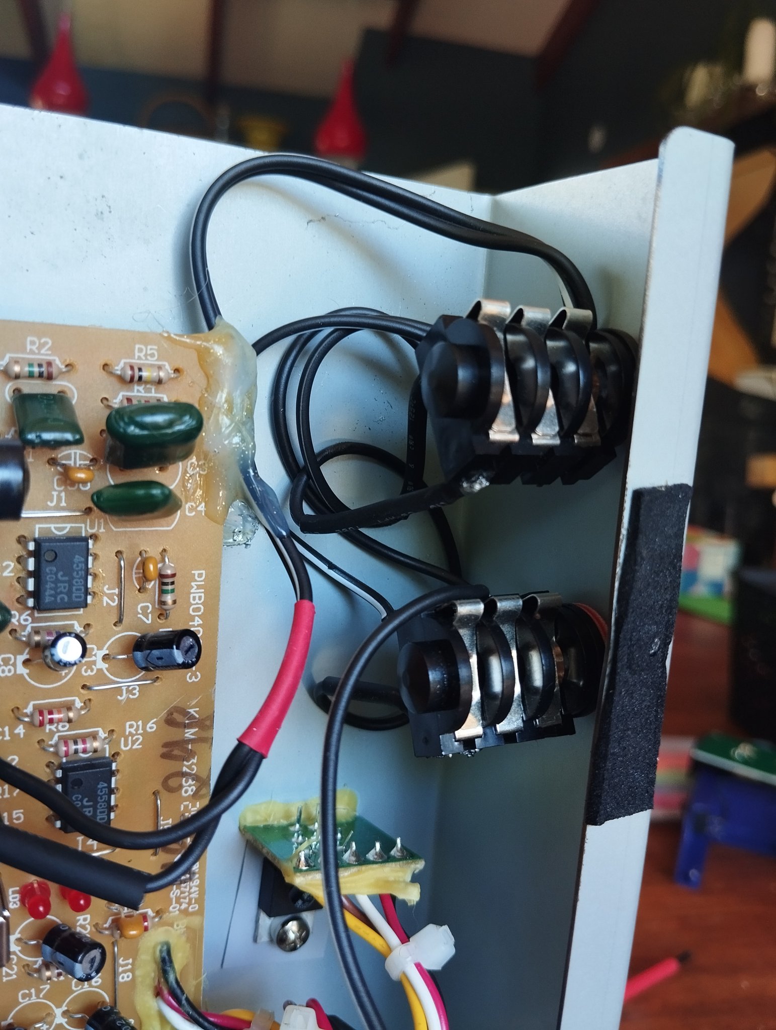

Back at it after a year.
I have added an unbuffered FX loop on the little thing, and modified the tone stack to better follow the curve of classic VOX. The pots do not track exactly like the VOX ones, but it's close enough so that we don't touch the surrounding stages.
To make it clear, besides replacing values, R11 was removed, and a wire was added from its C11 pad towards the junction of R12 and P3-pin3
The result is very pleasant. Especially in how the amp responds to dynamic playing, clarity and the highs. Which is what you would want from a wannabe-Vox amp after all.
Keep in mind that the PCB is particularly crappy. It's super easy to lift pads. Especially if you want to experiment with other parts. Perhaps it's best to use some strip pcb or just go point to point

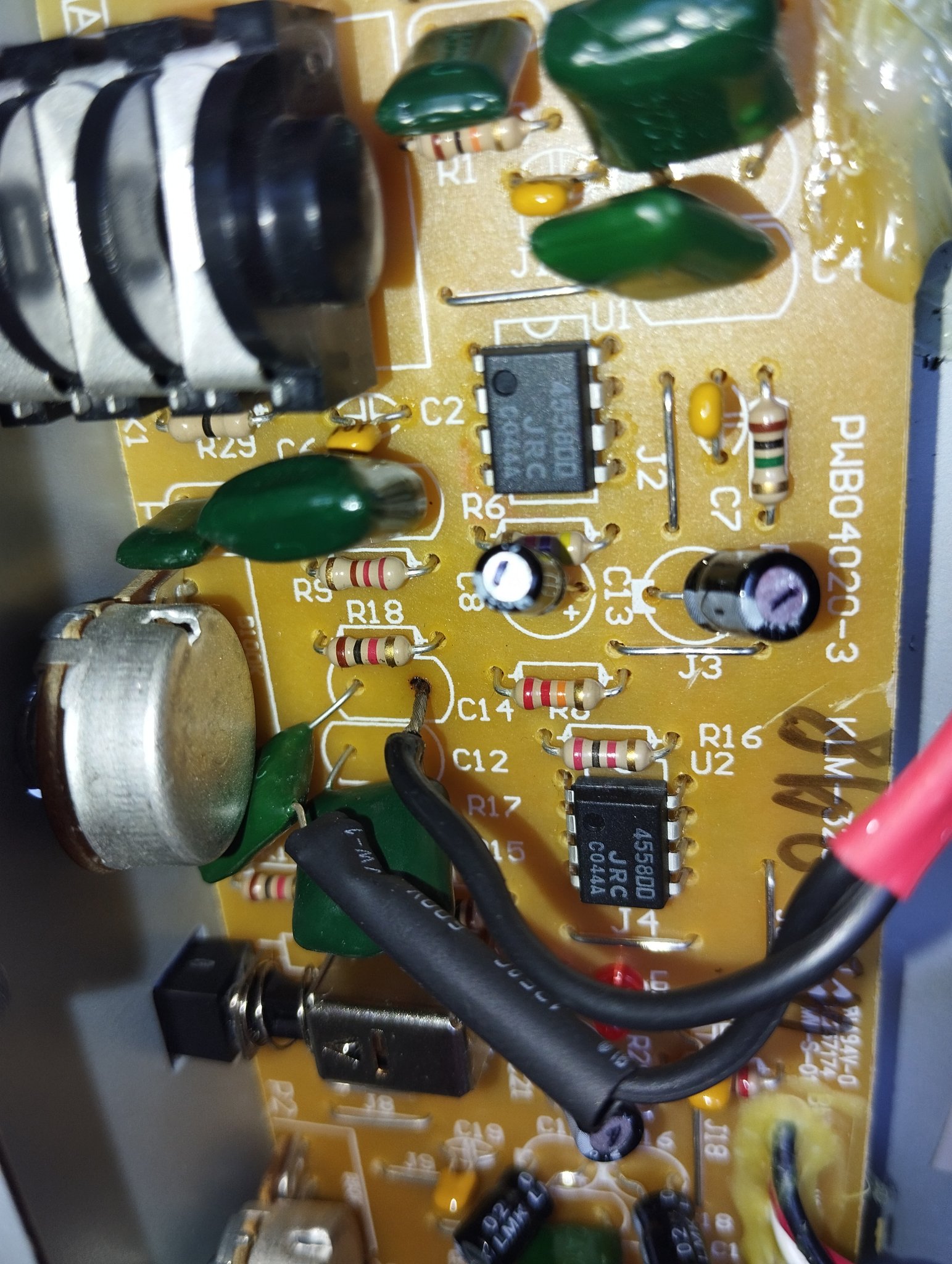

Yeah I just did the change and the character did not change at all (I already had removed C12)
Again, this mod is about removing gain from the third stage, making it a buffer
So I removed R15, R16, R17, C12 and C13, and then bridged R15 and R17 so that pins 1 and 2 of the opamp are connected.
The volume is now much more easy to control for home use. I can even get some overdrive from the first stage (sounds meh) and I can keep it on civil levels, something that I could not do before. It can still get loud if you max it, but it will be much more civil.
This mod also probably makes the change of P4 to audio taper irrelevant
Keep in mind that the overall volume will be lower than previously, since I plan to increase the overall output of the 2 first stages, but have not done it yet.
If you use your p10 on loud occasions, do not do this mod yet.
Sorry it has been a while, and I do not have the original pcb any more.
It was basically two switchable quarter inch sockets. The wiring is not complicated, but it's easy to get it wrong.
If I remember correctly, I added it before C14.
The first socket acts like a preamp OUT.
When nothing is plugged in, its switch is closed, and it gets the signal directly to the amplifier. When you plug a cable, the switch opens, and the signal goes to the cable.
The second switch acts like an amp IN.
When nothing is plugged in, the switch is closed and it gets the signal from the internal preamp (through the first socket's closed switch). When you plug in a cable, the switch is open, and the signal now comes from the cable.
The jacket pin of both sockets is connected to ground. Keep in mind that with complex pedal boards without floating PSUs, you will probably get ground loops.
I would also avoid plugging stuff with the volume high. There is no muting with this simple arrangement and you will probably get lots of thumping
