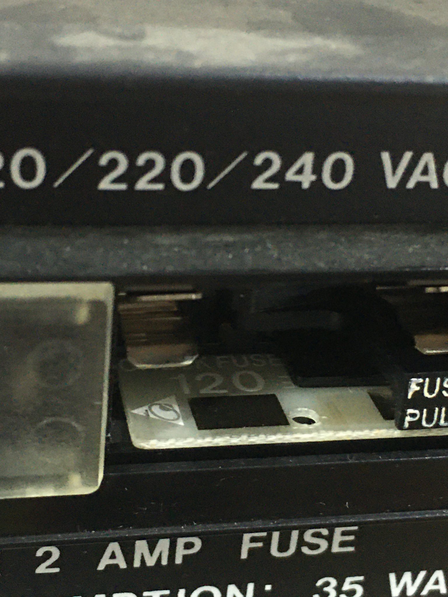

The IEC receptacle at the back highlights 110/120/220/240V but pulling the fuse out, I see a card which mentioned 110V. I opened the top cover and saw that the inside of the IEC receptacle (made by Delta Electronics) also mentions 120/240V and 50/60hz on it. There are a couple of metal lugs which are not connected there. Please see attached photos.
I can't locate either an operation manual or a service manual for this DAC.
Can anyone, who has worked with this Wadia before, please help me with the exact steps on how to convert the voltage on this DAC from 110V to 220V. I read in another Wadia manual for another dac that they used to ask folks to send their dacs to Wadia's factory to get the voltage conversion done. I don't obviously have this option to avail. Even if you have the operation/service manual with you, appreciate if you could mail it to me on my email id (can share with you over a PM).

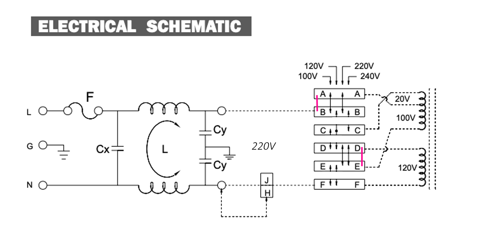

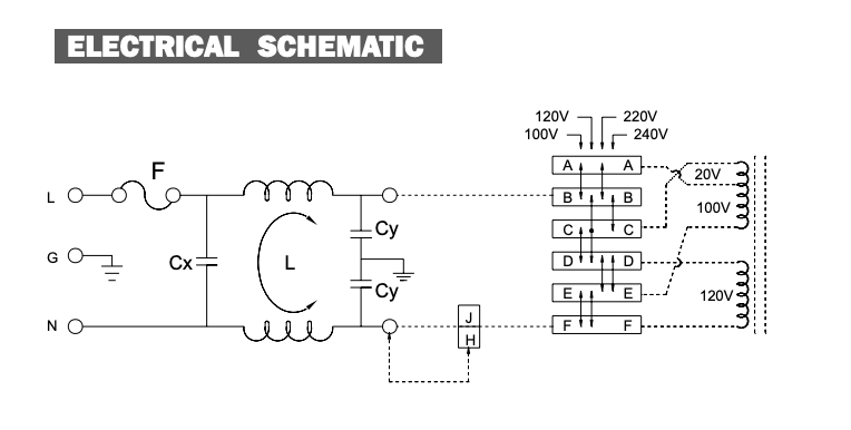

I did more research on this and started digging out details on the IEC connector model that is installed in this dac. The IEC connector/EMI Filter is from Delta Electronics and the model is 06LE4. I found its data sheet available on this link: https://www.mouser.com/datasheet/2/632/Delta_Electronics_10032018_06LE4-1487738.pdf
The data sheet states that this IEC/FIlter:
* Adapts to 100-120V or 200-240V input voltage by simply reversing the voltage selector.
* Gives the attached electrical schematic

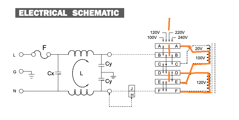

Could anyone study this and advise if the connections from trafo primary to this IEC connector need changes as per the diagram attached and that is all that will be required to plug the dac into a 220V ac mains line?

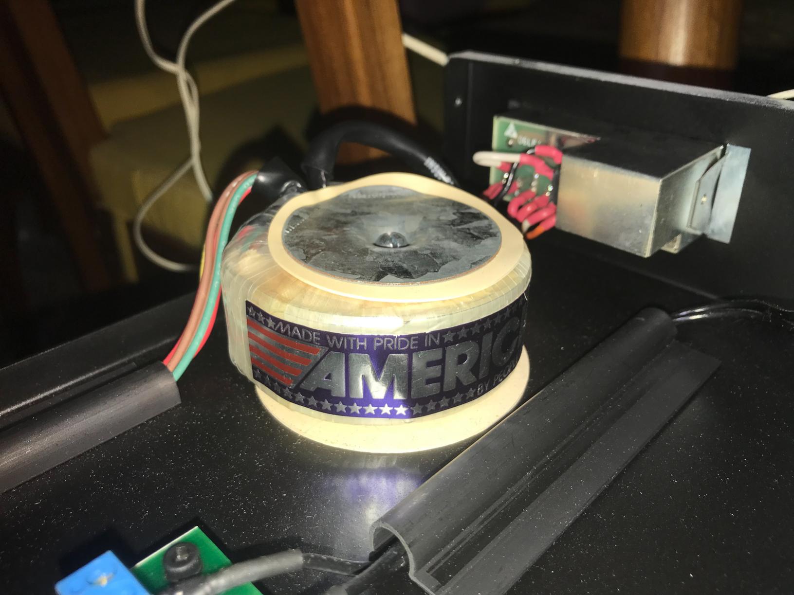

I hope you were able to check out the pictures of my W32 that I posted in Post #1. Kindly compare those with your dac's internals and let me know what steps do I need to take to convert it from 110 to 220?

Hey thank you loads for doing this for me!! I shall open up mine later tonight to compare with your photo and come back to you if I have any questions.
Meanwhile, please could you also share the picture of the back plate/panel of your w32. Want to compare it with what i have to ensure that mine is not a 110v version only!!

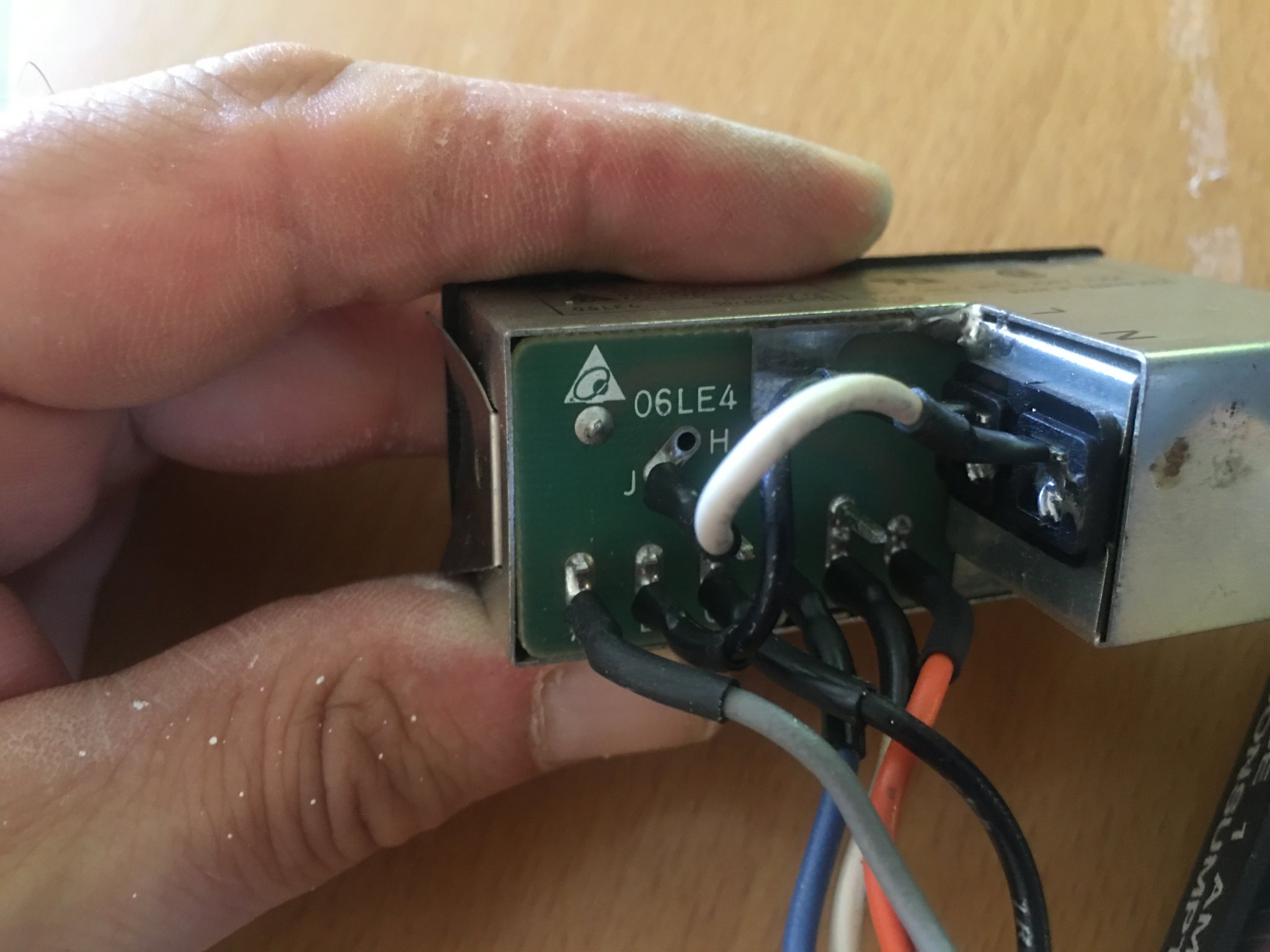

Umm - this is easy. Remove mains cable, slide plastic cover over mains socket, use lever to remove fuse. You’ll then see a small PCB (printed cct board) - depending which way this is fitted you can run 4 different mains voltages! Just be careful when first removing it - I think the selected voltage is written on PCB edge closest to you as you remove it.

Hey Dowser - Thanks a ton. I did as you said. I see the PCB displaying 120V. Can you tell how should i change the card’s orientation to make it work on 220v? Do i need to pull this out and reverse the pcb and insert it? Here are some pictures.Umm - this is easy. Remove mains cable, slide plastic cover over mains socket, use lever to remove fuse. You’ll then see a small PCB (printed cct board) - depending which way this is fitted you can run 4 different mains voltages! Just be careful when first removing it - I think the selected voltage is written on PCB edge closest to you as you remove it.
Edit to add: https://pinkfishmedia.net/forum/threads/wadia-digimaster-x-32-dac.266282/ - this covers work I did on 2 X-32s. The second one had a melted mains transformer due to a short circuit rectifier diode. I could not find a replacement transformer that support all 4 primary winding options, so it is now a fixed 220v one.
Thanks @dowser and @perelman - you guys are really awesome. Your inputs just made this work. I am so happy that it is powering on as per the 220V voltage.
@dowser - So I pulled out that PCB card and inserted the 220V side in a way the 120V side was.
@perelman - Once I turned the PCB as per Dowser's input, I compared your wiring schematic to ensure that everything was okay and only then did I power it on from the 220V mains that I get in India, and Voila, it worked!!

Exactly, orientation of that PCB sets voltage - there are 4 ways it can go in 🙂Hey
