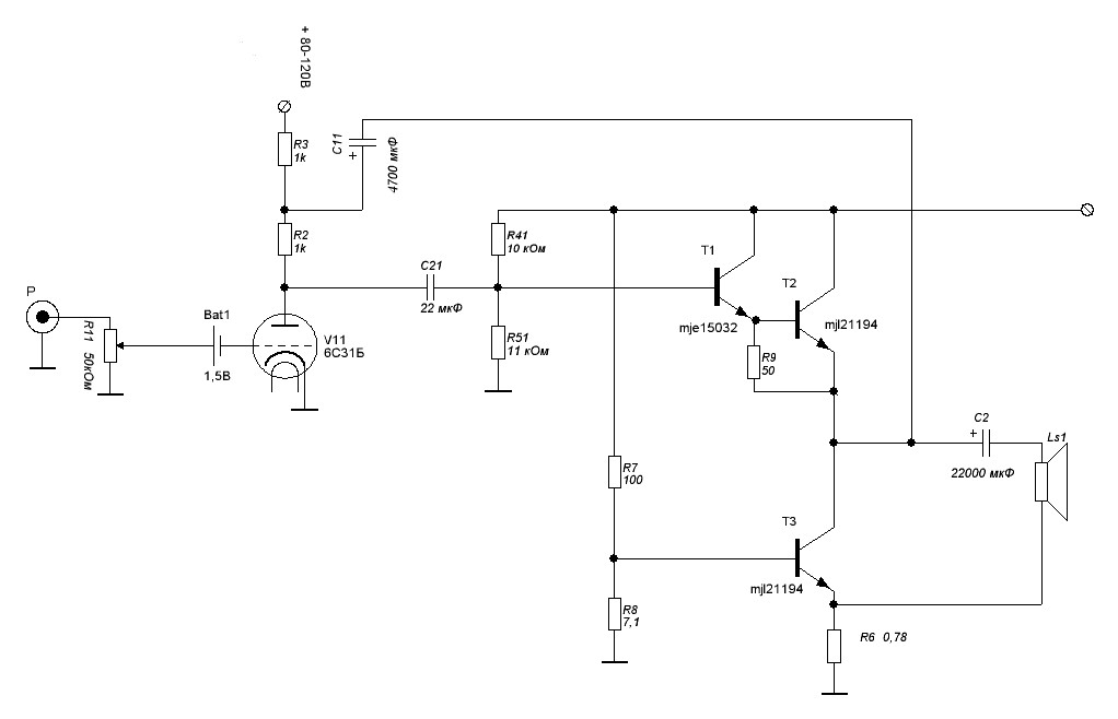

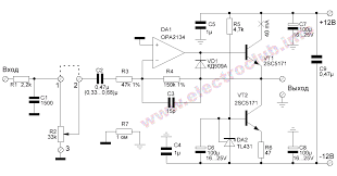

Small adjustment - changing the values of 2 resistors and increasing the heatsinks. You can take a kit or bare board (PCB). It is possible to get with the same parts 0.5-1a/+-12-15v.
The radiator is large .Or you need an aluminum case.🙁 Potentially the same layout as JLH1996 (there are also PCB).
The above applies to any class A amplifier. Physics can be taken from the (15 Om) itself JLH.
Some interesting ideas there, OldDIY. I initially looked into the TPA6120 but it doesn't like the low impedances. That JLH board looks interesting; do you think that is enough heatsink?
