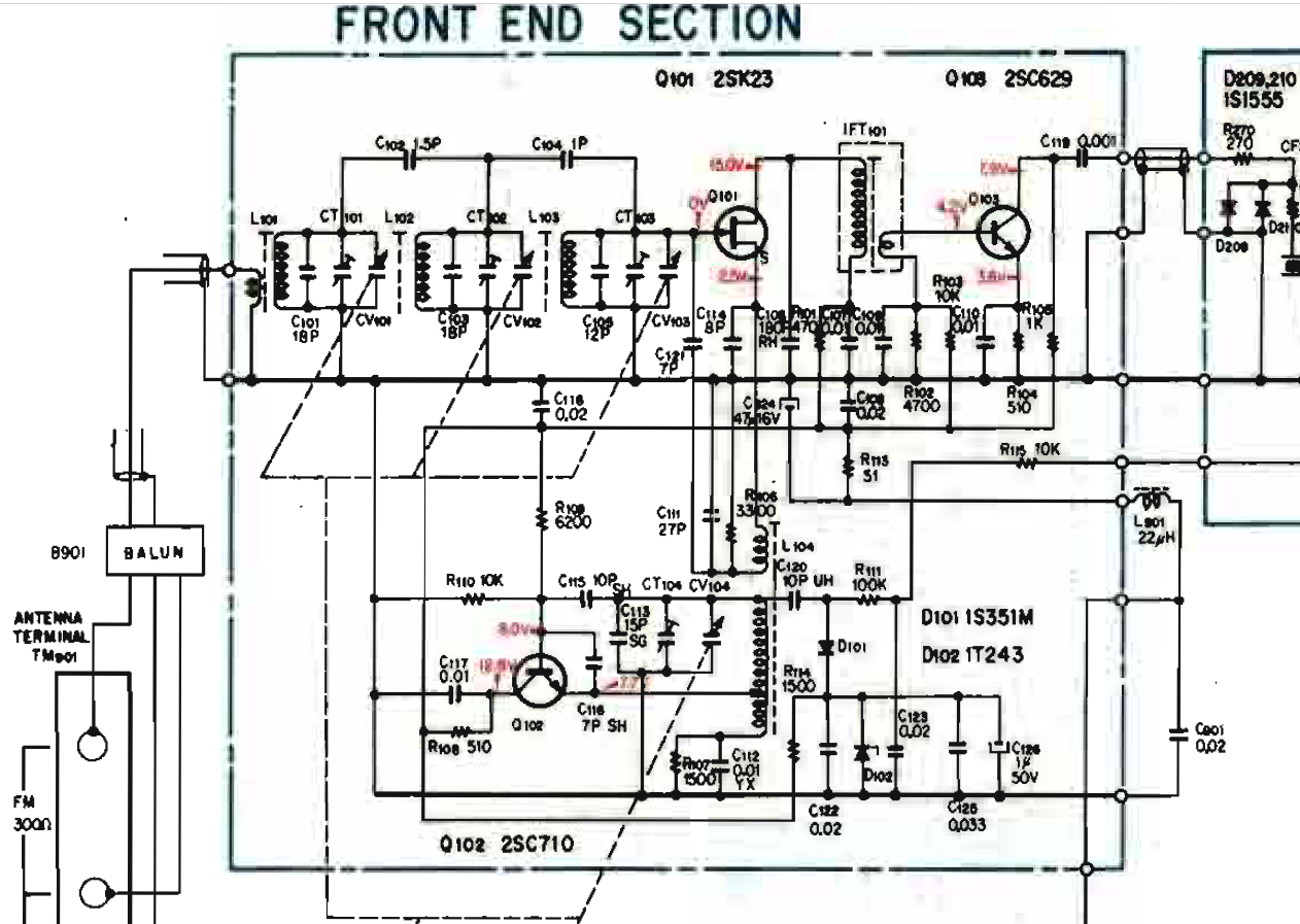

Sorry to derail a little this post... But since I also have a nice SONY STR-6055 that suffers one issue...
Description of the symptoms :
1 - I power on the unit and tune it to a clear FM station, meter come to center and red stereo pilot lights, everything is fine.
2 - I power off the unit, without touching anything else.
3 - I power on the unit again and the tuning is now off, the needle of the meter is full at right, stereo light is off, I have to retune to the FM station.
I have the SONY STR-6055 service documentation and schematics.
Any idea ? 😕
Thanks !
T

How long do you wait between powering off and on? Has it always behaved like this?
It could be drift with temperature of the local oscillator. That could be perfectly normal.

No, IIRC, My STR-6055 not behaved like that before. When I had it in 2000s, it only had the transistor driving the Stereo pilot that was dead (lamp was always lit) and I replaced it, no issue.
No need to wait more than a few seconds, nearly the time to power it off and repower it on.
I was primarily thinking about a drift occasioned by some leak somewhere - like a coupling or decoupling cap, or supply voltage - given that offset tuning... But where is the question ? Or would there be another cause coming from a faulty "frequency locking" circuit of some sort? Or possibly both causes ?
You may have to adjust a tuning trimmer or two.
Yes. I did it some years ago, with the service manual in hands, and the suitable meters, IF / AM / FM and stereo generators : my STR-6055 was just in need of light readjustments, nothing further. And as @MarcelvdG stated it, I think that it's probably not where lies the cause of that offset tuning...
When tuned, my STR-6055 doesn't show any instability or drift around the FM tuned station, nor the Stereo function : it works as it should. moreover, the offset is always in the same direction : tuning meter is always full right.

It still is in the frequency locking circuit (AFC). DC offset and drift, almost certainly a leaky capacitor. You tune it into range, and it tends to stay there if the drift rate is low enough and didn’t initially exceed the threshold for locking. Turn it off and everything gets re-set. It’s now out of locking range and doesn’t even try - it just tells you that you are off tune.
I assumed there was no automatic frequency control because I saw no knob to turn it off on the picture of the front. I forgot that some radios have AFC that you can't turn off, my parents actually had one of those. It was annoying, because it always locked to the wrong station at turn-on. I modified it so they could turn it off.
If there is an AFC, the issue can very well be related to it.

When you provoke the mistuning by cycling the power, is the FM station audio still present but perhaps distorted, with tuning meter deflected?
I surmise you have to break the "stuck" meter indication with the tuning knob? But when tuning is once again correct, is the tuning dial back in the exact same position?
As an additional similar experiment, try shorting the antenna terminals in an attempt to kill signal strength, or disconnect antenna if necessary. Is tuning meter back near center, as in when no station is present? When you restore the antenna, does normal operation return without having to touch the tuning knob?
If these tests are as I predict, I think I can explain what's happening.

Thank you @wg_ski , @MarcelvdG and BSST for your advices and tips !
I read my SONY STR-6055 Service Manual, and found that there's effectively an AFC circuit, consisting of D101, D102 and C120, occording to the circuit description in the manual and the reproduced front-end section schematic below (see lower right) :
Without deeper investigation, just looking at that schematic, I would first suspect C126 1µF/50V to be possibly defective, as it is the sole electrolytic capacitor in the circuit... (@wg_ski hint)

Hi @BSST, I followed your test procedure 👍, and here are the results :
Let's do some power cyclings :
Then we have :
* when the MUTING circuit of the STR-6055 is ON, the meter needle is deflected to the right, and there's no FM radio station audible, perfect silence.
* when the MUTING circuit of the STR-6055 is OFF, the meter needle is deflected to the right, and a radio is normally audible, undistorted, but this radio (Ka-Boom FM 103.3MHz) has taken the place of the original one (France-Info FM 103.5MHz).
In other words, a lower frequency drift has occured, and it is always in the lower frequency direction.
Yes, that's it.
I have to "re-hook and drag back" the original lost station (France-Info FM 103.5MHz) by turning the dial knob slightly to the right, and then once the station is hooked again, I turn back the dial knob to its original position, meeting exactly the initial dial position of the lost station (France-Info FM 103.5MHz), in order to have the meter needle centered.
OK, let's proceed :
During the procedure, I do not have to touch the tuning knob, and the needle meter stays always centered, it never moves.
I hope I am clear in my description ! 😕 So what can you conclude, then ?
As I have now my STR-6055 on my bench, I will locate C126 1µF/50V Electrolytic, and replace it by a small Polyester or Polypropylen 1µF/63V. Anyway, it can't be a bad thing, and possibly the cure, who knows ? 😉
Wait and See...
