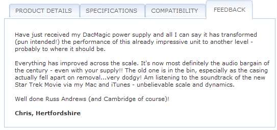

I noticed that Ru$$ Andrew$ has a replacement PSU and amusingly this reviewer of it had a similar experience with the original PSU:
The guy's office is at London Bridge and I go there everyday so I'll drop it off at the London Bridge Richer Sounds tomorrow. He'll pop around and collect it from there, as he is very concerned and wants to see it. I have found evidence on the net that I'm not alone in this.
