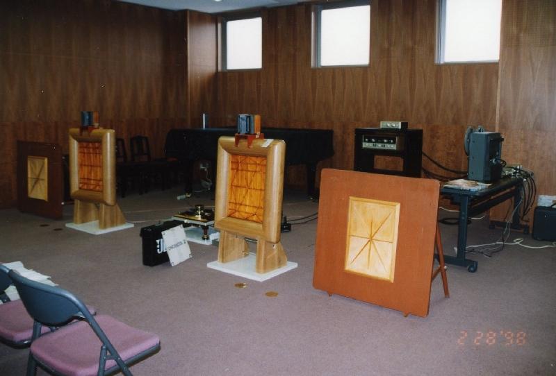

Found these on the website Takeshi Teragaki (of the Epson-Seiko Sigma series of turntables fams). Pardon my poor japanese but they are referred to as wave speakers. Anyone has any idea how they work. They seem to me to behave like resonators as used in acoustic string instruments.
????? of ????Official Website
???????? of Teragaki-Labo?????????????????TERRA???????????
Those look like bending wave loudspeakers ...
http://blogimg.goo.ne.jp/user_image/17/1e/c545782dcfd45aa5e6a03b595aaf5ec7.jpg
They seem to be rather sophisticated ones, any member here who can
translate japanese ?
Yes, that is the working principle, bending waves propagating on
a board / foil or curved 3D structure.
"Utilize what you cannot avoid" (i tried to translate) is one of the
marketing slogans from the manufacturer "German Physics" for
their Walsh based 'DDD' bending wave transducer.
That slogan meets the idea quite well IMO.

Would be nice to see, how spectral decay looks like.
At least the appplication of conventional tweeters in
some of his models points towards him beeing not
fully satisfied with the upper end of some of his
wood panels. Maybe some of them are intentionally
designed as midrange panels.
Some of his models show very solid frames for
supporting panels and motor, thereby involving
expensive metalwork.
Hard to believe a skilled person undertaking such
an effort for optimizing a deficient transducer ...
They invoke the impression of being built for
classical music by their classical handcrafted look,
the materials chosen and the finish.
I personally would rather like to listen to them,
with all kinds of music of music of course, than
judging by its looks.
Although i could very well imagine some audiophile
writing "most beautiful strings i ever heard", when
i see the picture only.
Would be nice to have some excerpts of the text
translated.

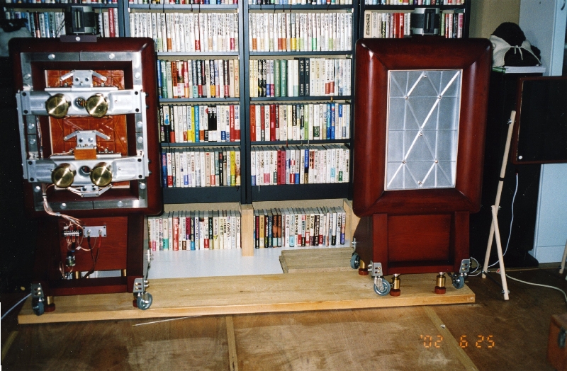

When i think about the designs of Mr. Teragaki i assume, most
of his panels might operate in whole body motion at least up
to midbass range maybe even further up.
Above that they seemed to be optimized for modal breakup as
smooth as possible. The "Terra SP 3000" style panel should be
suffciently rigid for pistonic motion in the bass range, especially
when driven at multiple points or ring shaped areas, which i cannot
see from the picture.
The "Terra SP 1000" seems to rely on this kind of transducer solely.
Maybe as a purist he wants his panel to cover the whole audio range,
without crossing to a subwoofer, although i cannot see the system
working any different in the bass range than a conventional driver.
Just my guess.

While the stiffness members support whole body motion in the bass,
they may contribute to anisotropy of the panel (different propagation
velocity of bending waves due to travelling direction) and thereby to
diffusivity and modal overlap.
The details will be hidden in the materials glues and treatment ...
He uses a combination of rigidity introduced by overall panel shape (curved)
and and by additional stiffness members.
He uses a combination of anisotropy provided on the macroscopic scale
- by same stiffeners (maybe with damping component)-
and the microscopic scale contributed by the material used, which are
shrinked differently on the zones of the panel.
Just my guesses ... but be sure, that guy has done his homework.

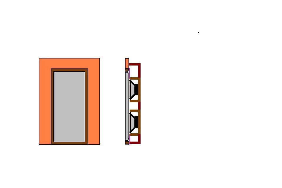

As i can see you have proposed a large "Rubanoid" for your satellites.
The "Lineaum" tweeter and its descendants are bending wave transducer too.
A later concept is the "Airfoil" which is based on the same principle of
driving a curved foil at a line or edge, thereby exciting bending waves
propagating along the foil, which causes radiation of sound.
Like in every bending wave transducer the art is to damp the bending waves
to the right amount to reduce reflexions from the suspension, which would cause
uncontroled resonances.
